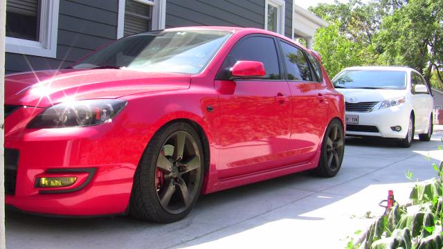

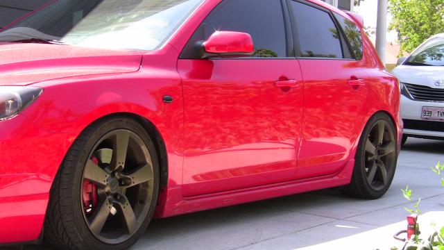

Got the coilovers installed. Now I need to start fine tuning things. The fronts feel great, the backs are quite bouncy the way they are set right now. I definitely like the drop though and the car is so much better planted and responsive.
Postby Shadowden » Mon Aug 27, 2012 9:14
they look great. llooks like you have a really nice ride height. Do you have more dampening you can put in the rears?

Yes. I haven't even touched the dampening on the rears yet. I only set my ride height and the spring height in the back. Right now the ride height is dropped about 1.75". Floor to the top of my fender is 25 1/4". It's definitely a trial and error process.
