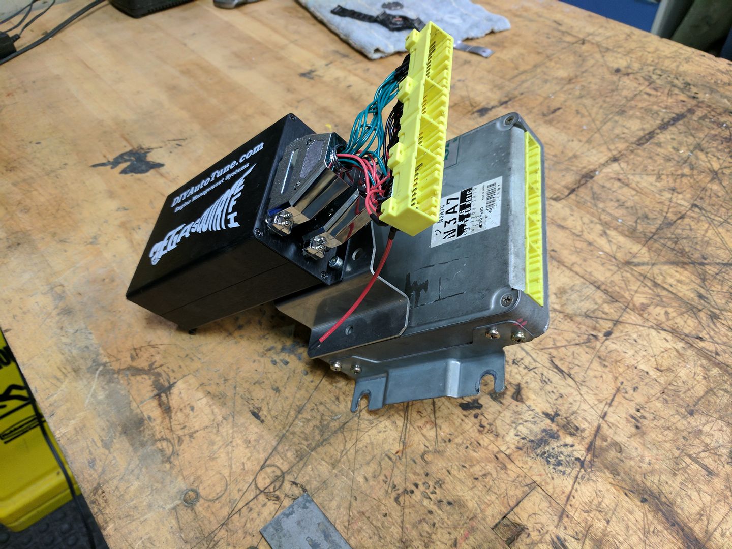

Actually I made a standoff bracket and mounted the MS to the oem ECU. Still haven't done much tuning wise, just making sure everything is set up right and solid.
Re: MS3X'd FD
Posted: Wed Feb 15, 2017 9:14
by Shadowden
Nice arrangement. Standoff bracket bends look nice. What did you use to make them?
