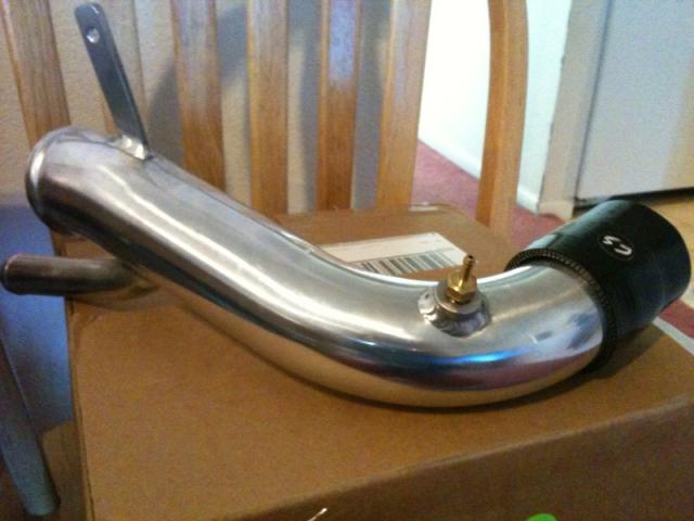

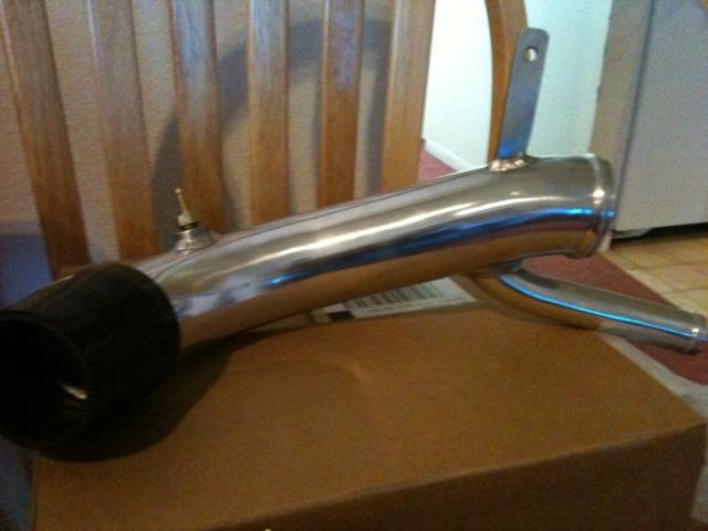

Here it is in all its glory:D Just got this via UPS....And it wasn't damaged:D
So far the build of the product....A+....Very strong clean welds and everything necessary for install..

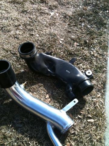

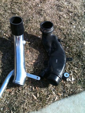

So I got around to installing this today.....First impressions....VERY GOOD....:D
-With the CX-7 in auto mode the shifts are usually kinda rough...it seems to shift a lot smoother....Also smoother in the auto-stick mode....
-As far as performance....It feels like it pulls a little harder and quicker off the line and through the all gears...
-Install wasn't bad at all....I decided to take my time and make sure I didn't break nothing....so about 1 hour and 45 minutes....Only issue I ran into was tightening the clamp on the turbo side...just a pain in the ass....other than that...not bad at all
Just like everyone else that installed this on there car...YES the factory inlet just slid right off....GOOD JOB MAZDA....
One other thing is the Forge BPV sounds different....a little quieter....but more like a BOV not a mouse sneezing....:lol:
To anyone thinking about this purchase....GO FOR IT....$100 for a well made product with overall positive benefits...
