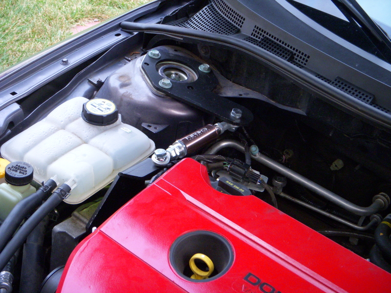

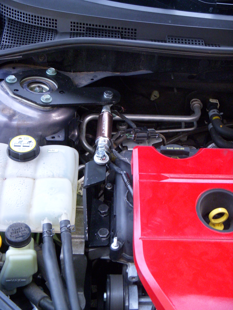

Installed yesturday. One of the most frustrating installs I've done (but that was probably my fault).
Pro's>>>Increases traction, Faster acceleration, dramatically decreases stress on mounts, stops almost all engine movement, wheels spin not hop, WILL DECREASE VIBRATIONS DUE TO AFTERMARKET REAR MOTOR MOUNTs!
Con's>>>Engine noise is heard through vent on passenger side due to the mount being attached at the strut tower part of the firewall. If you don't support your engine during install, it will fall. NOT FOR THOSE LOOKING FOR A COMFORT MOD! THIS IS A PERFORMANCE MOD! IT WILL DECREASE COMFORT!
A great addition to my growing list of modifications...a must for those looking to get back what Mazda took away with wussy engine mounts. And for those who want the toughest platform for their 2.3lt Atmospheric or Turbocharged Mazda3 engine!

its not super annoying loud...but its noticeable. You can hear the valves and timing chain...kinda sounds like the wind a little. But it has more of an impact than a motor mount will ever have since this actually stops the engine from moving. I drive with the windows down a lot anyway, so the sound doesn't bother me. I bought mine from Protege Garage..but you can find them at a lot of online performance stores. Do a google search of Mazda 3 Engine Damper, and you should get plenty of hits.

Torque damper. Very good mod to get if you want a quick acceleration boost. It's a little known mod, but well worth the money. Good pick.

universal...and TORQUE damper dont go well together...
if you look at mine, the mounts are 1/4in thick steel plate powder coated...that ebay one looks like it wouldn't hold up to any amount of abuse.
and its only held in place by 2 tiny a$$ bolts lol...my advice...if ur cheap and own an 88 honda that you dont care about, go for it...but those look about as strong as a hood lift.
also, inside of a REAL torque damper...its not a hydrolic, but 2 1inch thick rubber bushings the piston pushes against...figuring the motor weights over 500lbs...thats alot of force.

yikes...well you may be stuck with delrin mounts for the extra support. but I wouldn't put a 34$ universal strut on my engine and expect it to work.
