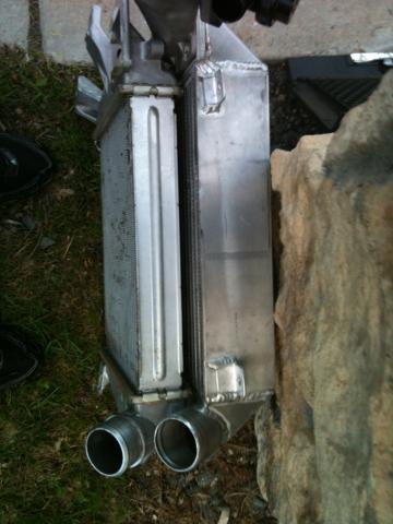

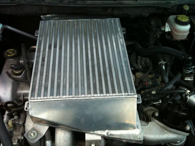

So here it is.....my "new" ETS TMIC from rmeeker13....Thanks a ton.....So far it is an AWESOME mod.....It pulls like a MOFO....and feels great...the sound is the only thing that I have get used to...sounds more like a supercharger whine....but I love it..... The FMIC project is still in progress....I needed to order some more parts and they have been on back order for a bit.....soooo I figured that I needed something....:D

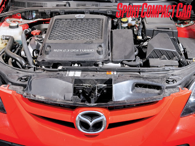

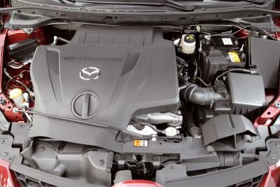

Do you have the shroud that goes around the outside that the hood ducting seals onto? Or does the CX7 not have all that? If it does and you're not using the shroud you're losing some effectiveness as that keeps all the air coming in through the hood ducting going over the TMIC and not dispersing throughout the engine bay.

The shroud is not needed on the CX-7.....the cover that vents the air into the TMIC sits on the TMIC....unlike the Speeds....which attach on the hood....That's why some places sell the CX-7 TMIC as a different part #....it's just without the shroud...

Thanks....I would rather have the venting like the Speeds so you can see the TMIC unlike the CX-7....See the difference....

That shroud doesn't fit over aftermarket TMICs on Speeds. So once you ditch the crappy stock TMIC, you also ditch the nice looking cover.

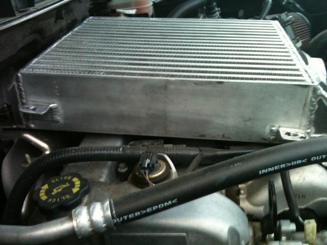

So I figured out what the whining sound was......one of the holes on the cold pipe side of the TMIC was stripped....this was causing the whining sound....air was leaking out.....I put a heavy duty screw through it and problem solved:D
