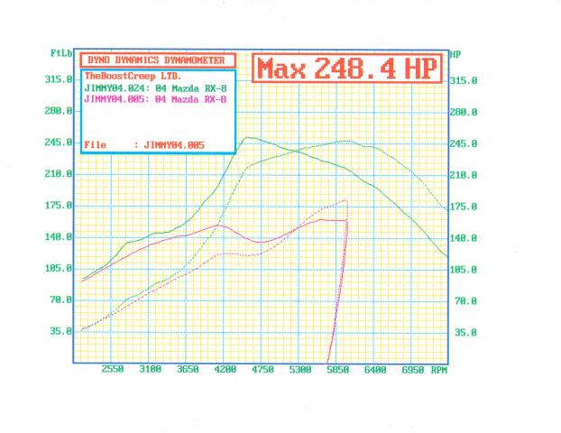

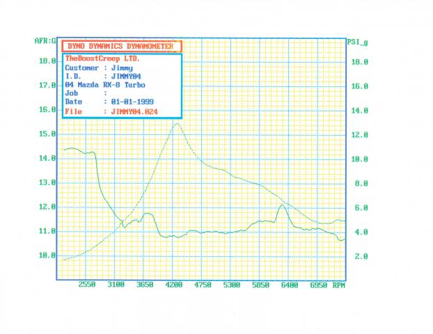

So I got my 8 tuned last night up in longmont. Turns out I didn't and couldn't wait till the 17th for various reasons. Car was tuned @ Boost Creep ltd. by Dave. Not having a good EBC and loose actuator arm on the WG hidered the car from holding boost past 4200RPM. Good news is that I am making stock torque under 3k RPM and stock HP before 4.5k.
The final numbers till I get an EBC and correct the problem with the waste gate are......248.4 WHP @ approx. 6k RPM and approx. 260WTQ @ about 4.5k RPM. This car just feel fan-freakin-tastic. It's soo awesome you have no idea. I NEED to get an EBC to feel it's full potential.
As I loose boost pressure power starts to give out after 4200 RPM
Weeeeee.....then we fall flat. WG wants to/is being force open. We will see where I reach in a month or so when I get an EBC. After I tighten the actuator arm I should feel a huge difference.

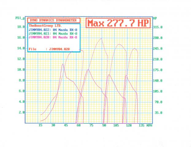

A third chart of 277.7 RWHP. This is from a run done 2nd through 5th gear.

And Harvey was saying his dyno reads about 30hp less than MAC's, so you can figure at least 280rwhp-ish if we went to MAC.
But yeah, boost is falling off just as the engine is coming into it's VE and flowing the most air. The proof of this is your max airflow (294 grams/sec) came at 7000rpm, when you were making just 5psi.
Interpolating your HP graph, with a proper boost controller holding 12psi, you will hit 310rwhp no problem.
You can see in the second graph you posted, the line that spikes at 4200rpm is boost. It soars to 13psi (an EBC will make it spool quicker, too) then falls flat on it's face (I mean by 5,000rpm you were already >9psi). The second line is AFR's, holding pretty steady at 11:1 save for one spike, but it doesn't even effect tq or power. Next time on the dyno I will spend more time smoothing that out.
Postby GR-8 » Thu Jul 08, 2010 9:14
chickenwafer wrote:Glad you like it man.
You actually hit 277rwhp on a rip pull 2nd thru 4th.
Thanks for technically clearing all that up. :) Can't wait. Should have an EBC in 2-4 weeks excluding shipping time. ;) All a matter what kinda deal I can find online or at a shop. Shall add that 277.7 sheet when I get home.

The 277.7 RWHP chart is posted on the first post. A pull from 2nd to 5th.
Postby chickenwafer » Fri Jul 09, 2010 9:14
That 3rd graph of running through the gears REALLY shows how much boost dropping off is hurting your power. You can see the power and boost spike, then both fall flat.
Get an EBC man so we can break 300rwhp!

chickenwafer wrote:That 3rd graph of running through the gears REALLY shows how much boost dropping off is hurting your power. You can see the power and boost spike, then both fall flat.
No kidding. I can feel it. Did a little fun run against the DTS. I was in 4th rolling about 65. We hung together but I was loosing power. Shifted under 7k rpm and started to move again.
