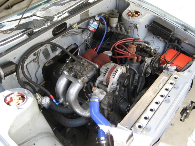

yea trying to achieve something like this but kinda gave up on making mounts too much work, so i figured an fb crossmember would work

Ok I understand what you are looking at. What you will need is a 12A or FB 13B front cover and a FB 13B oil pan. You can get a new pan at mazdatrix if you can't find used. I have a 12A front cover if you need one, I'd sell it to you real cheap.
That is probably the best way for you to go, much easier then doing the mounts for the FC motor.
