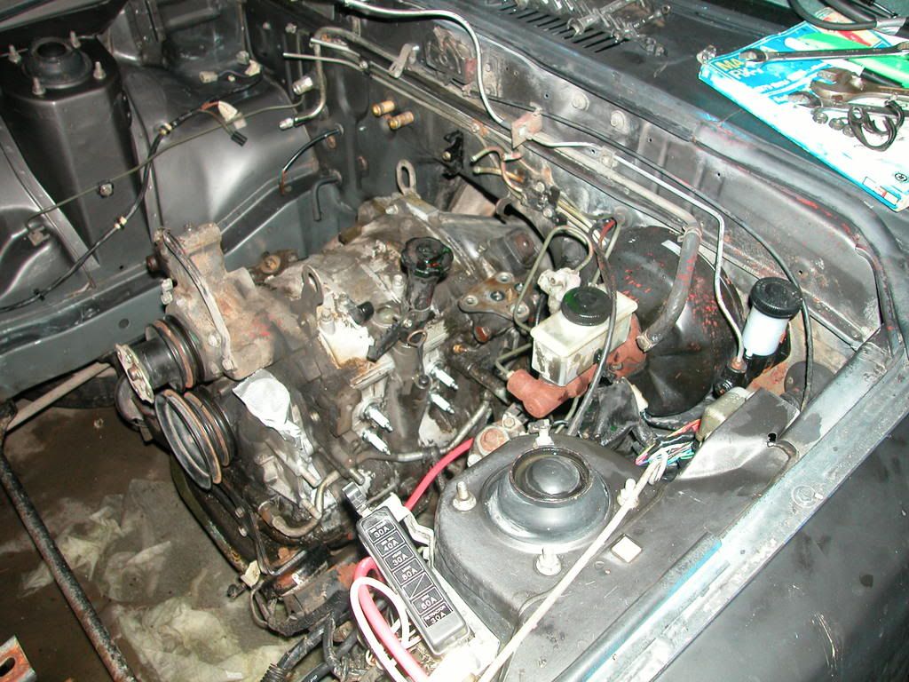

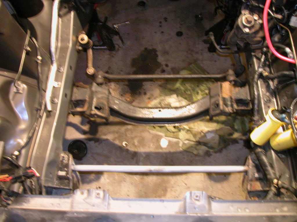

It was then time to start pulling the motor out and clean the engine bay from the 178K Miles of grime.
This is what I started with:
I started with pulling the battery and draining all the fluids:

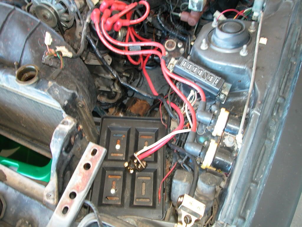

Next came the air cleaner, carb, and distributer:

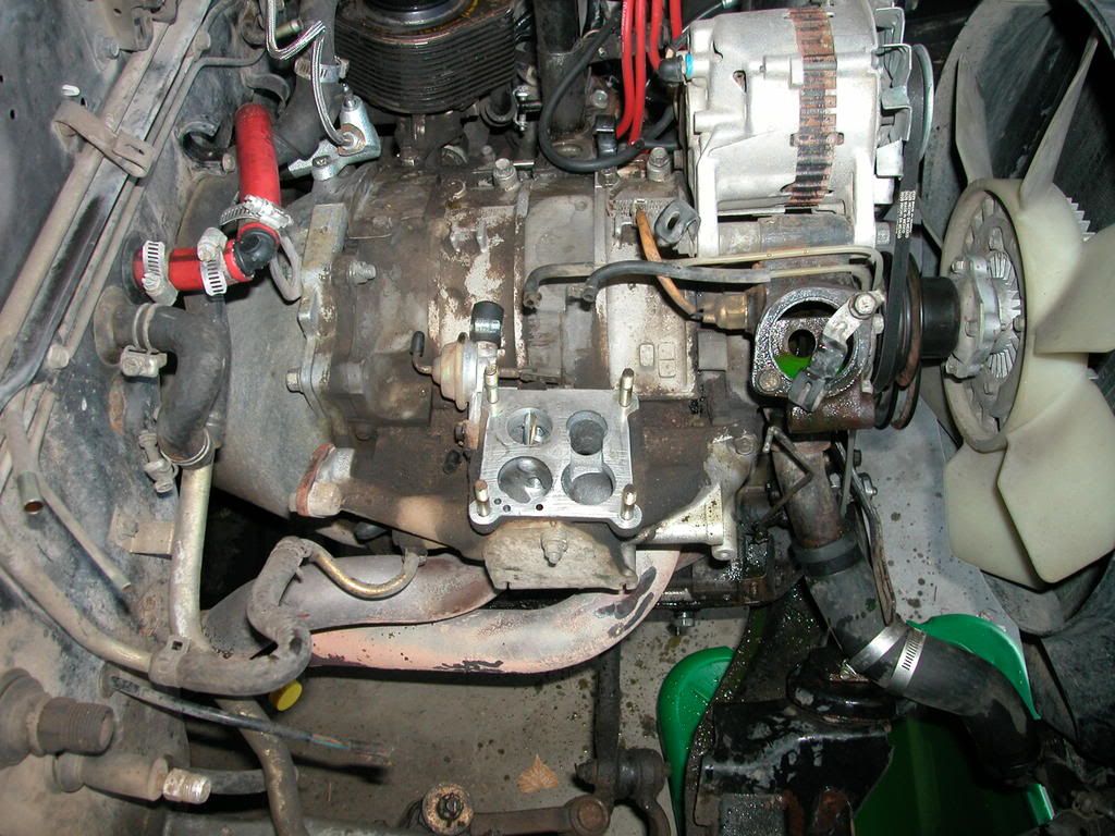

I then removed the alternator, fan shroud, fan, radiator hoses, radiator, and radiator supports:
I then removed the exhaust system and anything else that is attached to the motor and transmission:
If anyone wants a list of everything else that is involved with pulling everything off just ask.

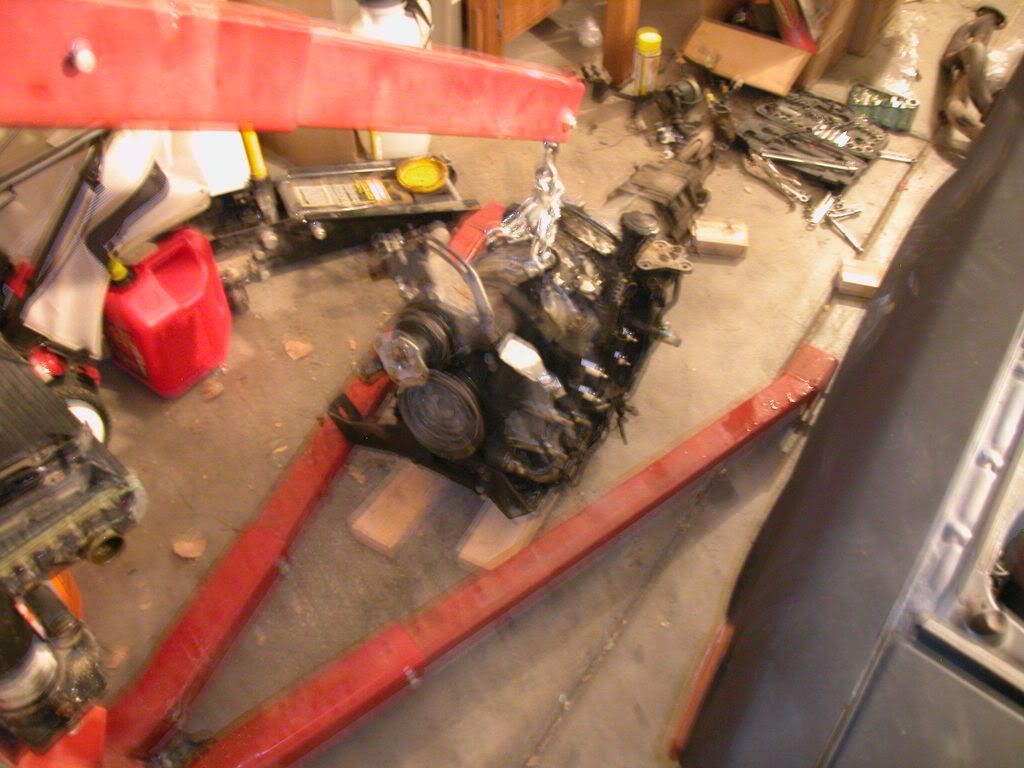

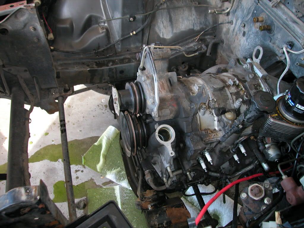

Time to remove the motor and transmission:

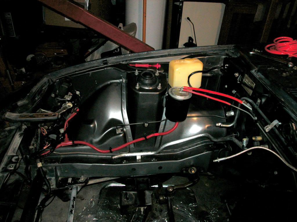

Next was the cleanup, paint, and wire loom:

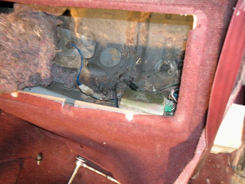

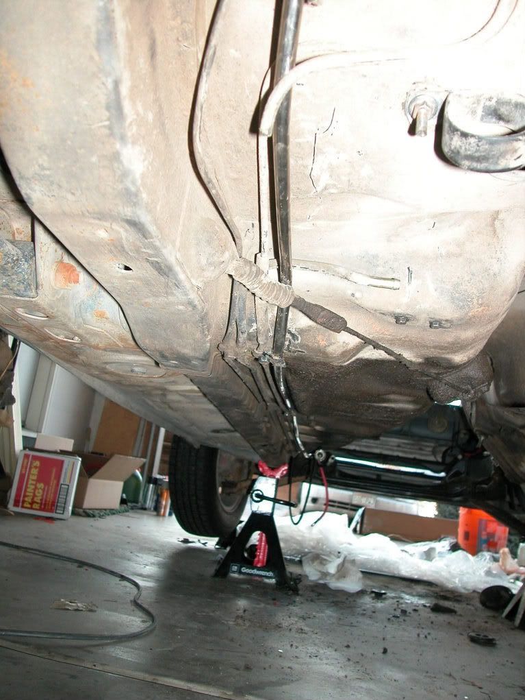

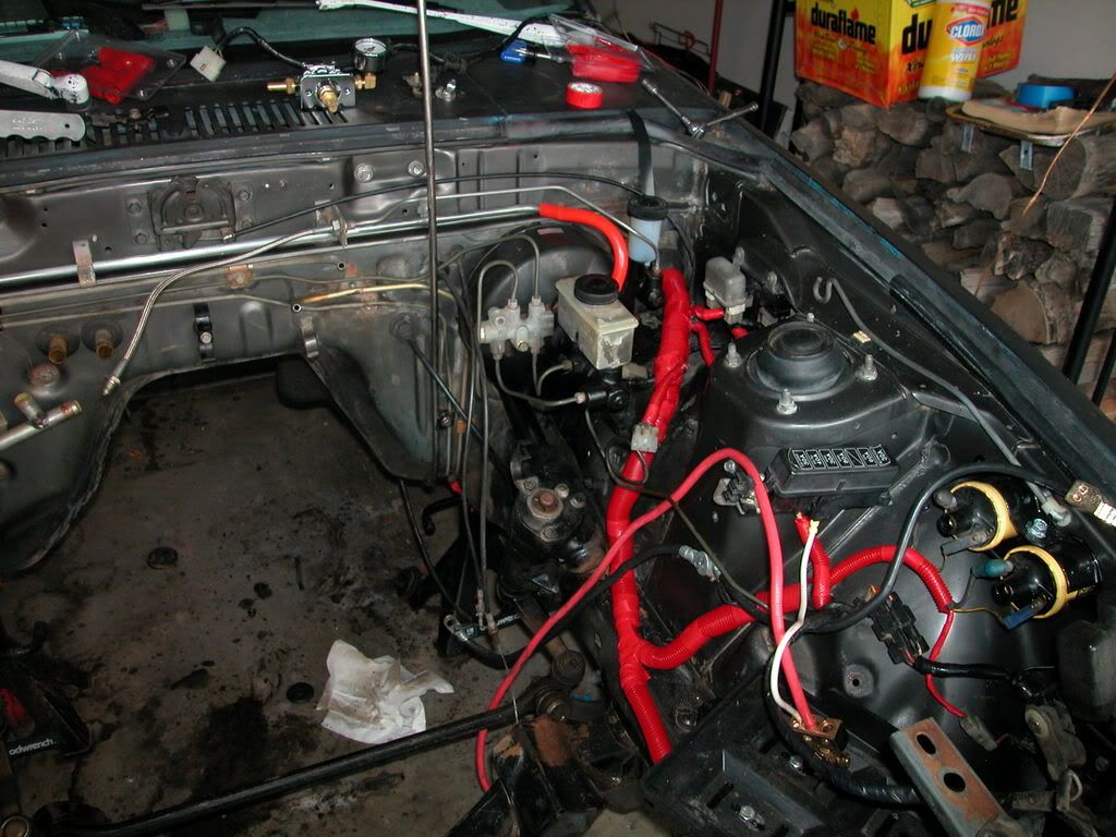

I put in 3/8" stainless fuel line from Summit Racing. The stainless line was a real pain to bend but now I have fuel line that will outlive the car.
My new Carter fuel pump installed:

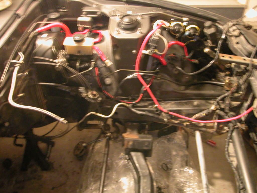

Location of new wiring:
I did a 30amp relay setup with 14ga wiring to the main fuse block. The fuse block is an FC block that I installed right before the old motor died. I really like this fuel pump but is is very noisy.

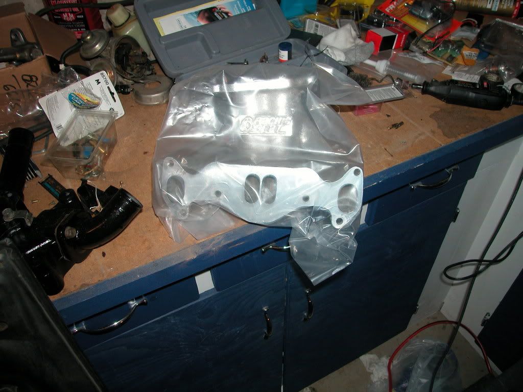

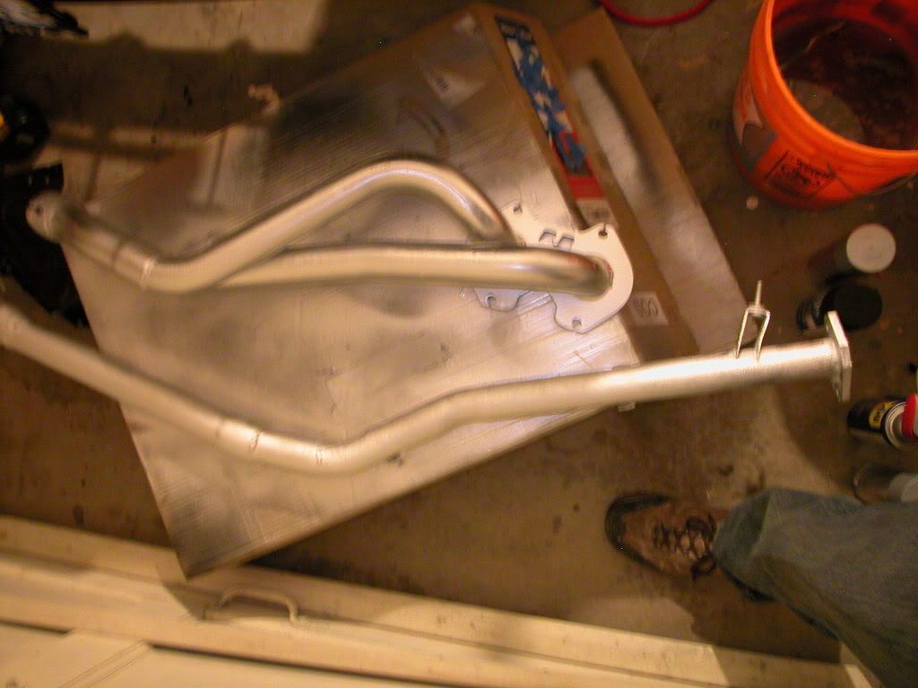

I painted my header and midpipe with 1500 temp silver paint. I still would like to have the header powder coated.
Right after I finished that the Racing beat 465cfm Holley car setup cam in:

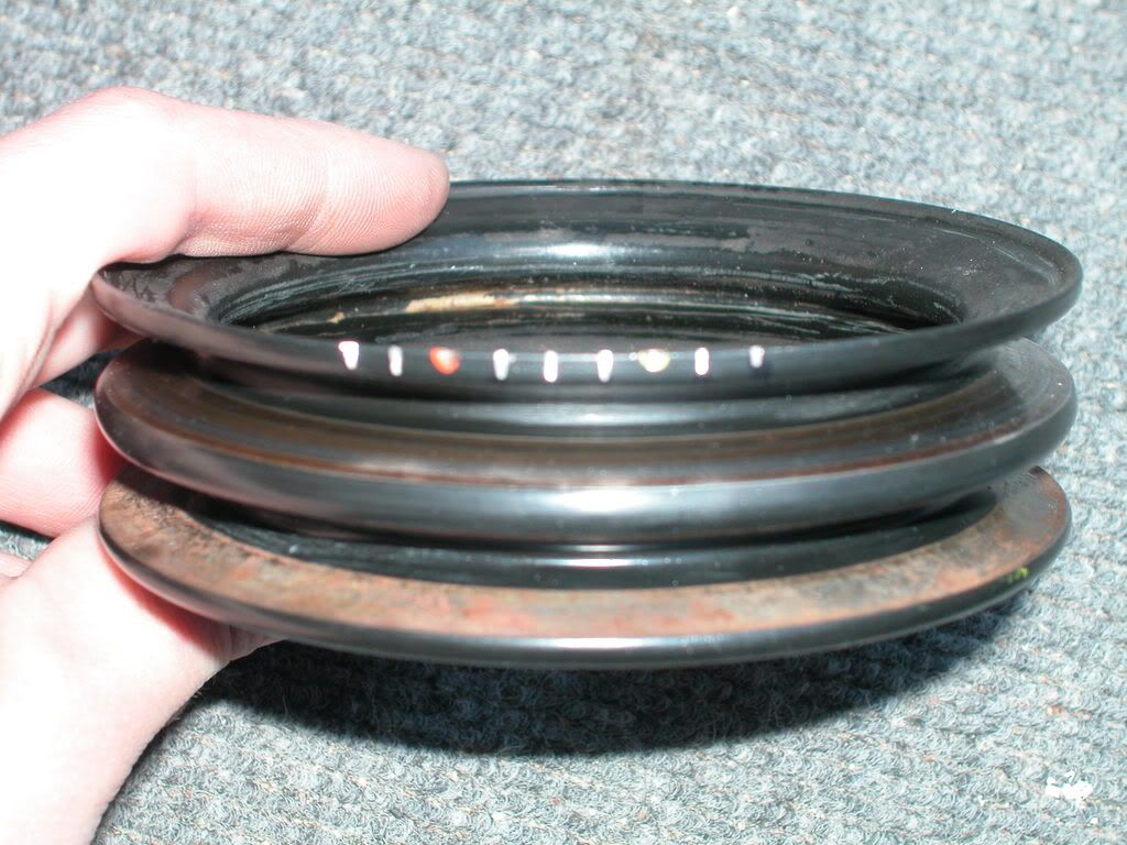

I added timing marks to my main pulley:
the orange mark is TDC and is stock. the pulley is 360mm in circumference so I ground a mark with my dremel every 5mm which is 5deg.

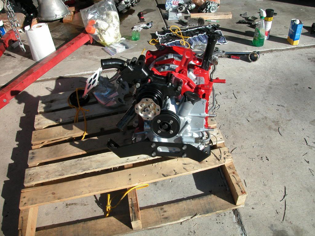

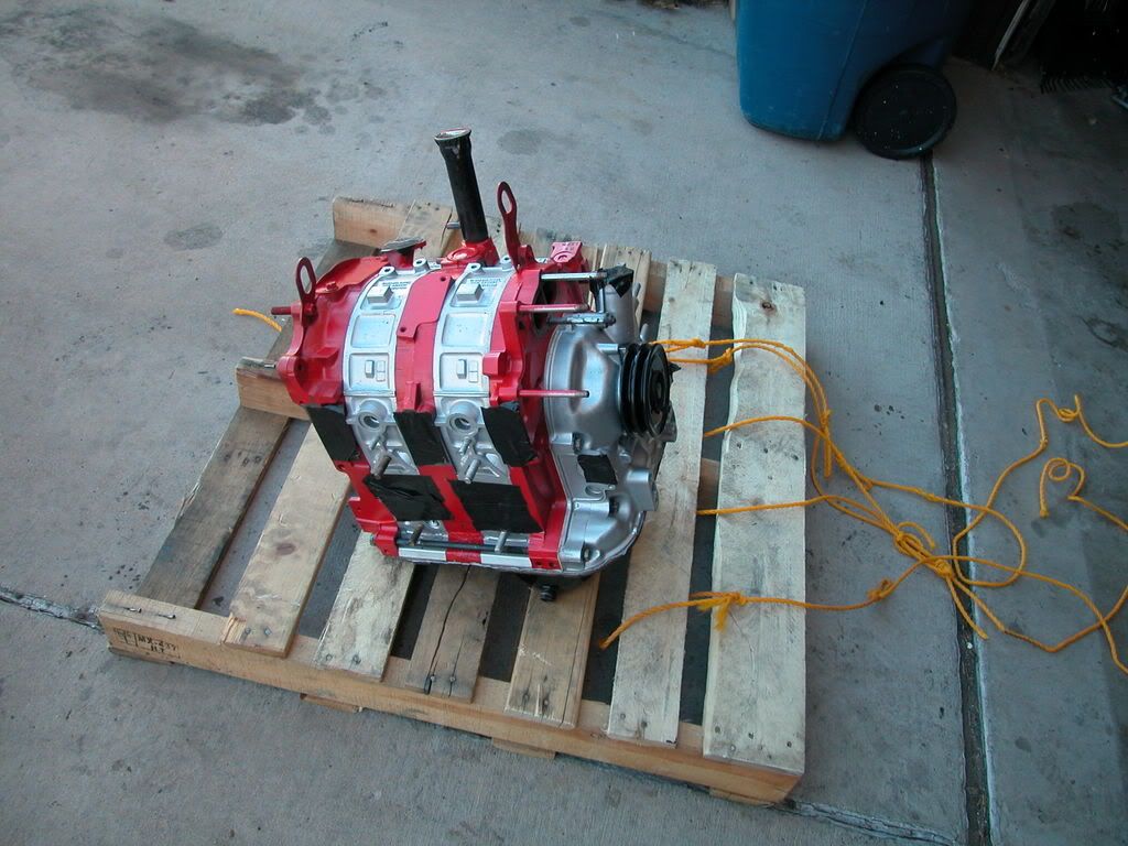

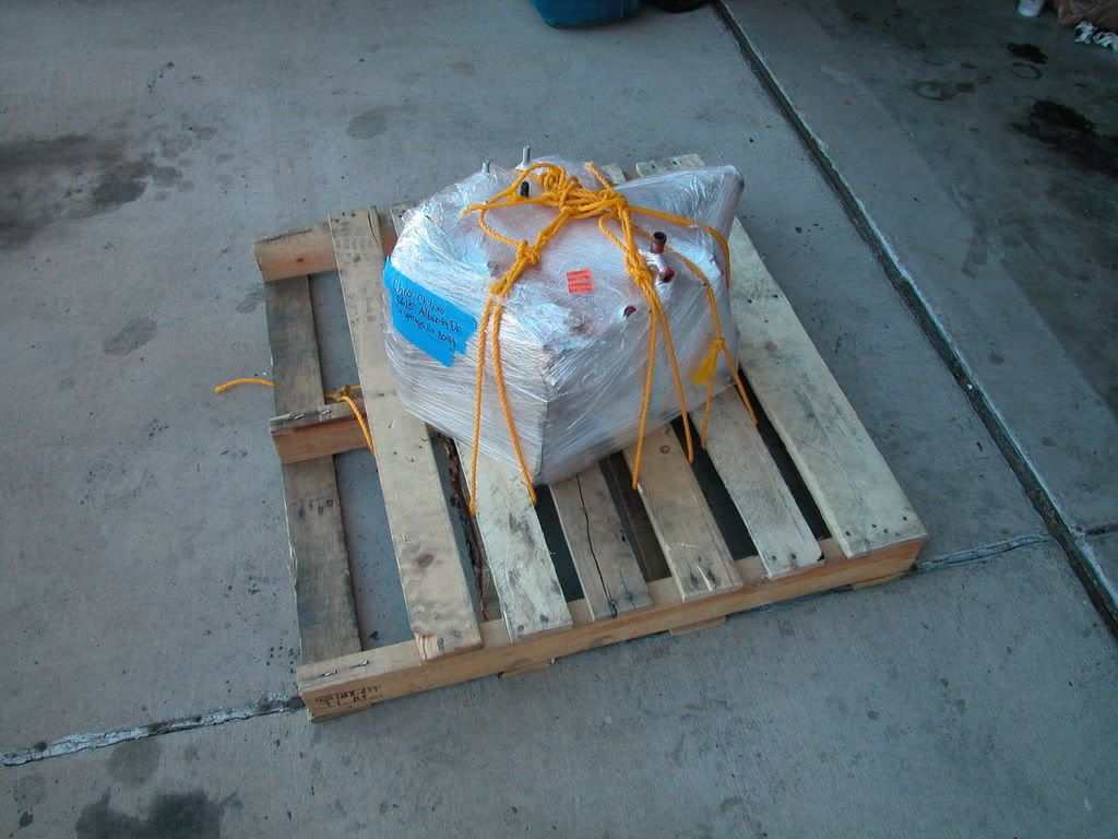

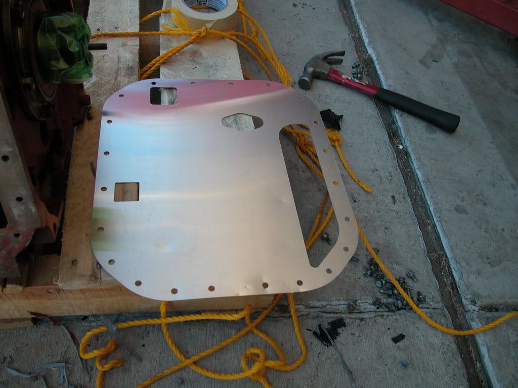

The motor came in after 2 months of waiting from Rotary Warehouse:
The first thing I did was install an oil pan baffle
I added the main pulley, and oil line for the beehive. I also test fitted the waterpump housing and waterpump

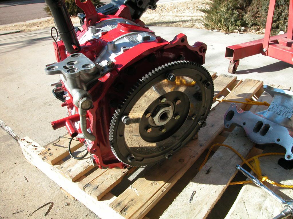

I installed the rear main and RB lightwieght steal flywheel.

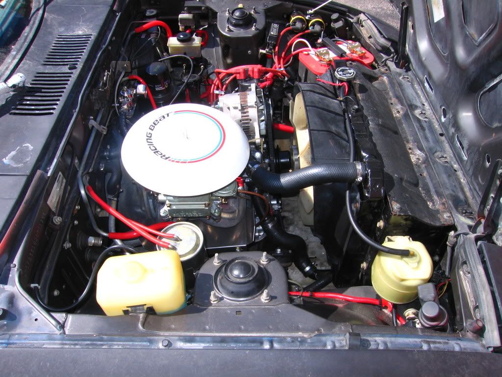

Pics of the finished install:
Thanks to Drifter for helping with pulling the old motor and and installing the new one. And I can't forget the fun with the startup and a motor filled with assembly lube. My eyes never burned so much in my life.
