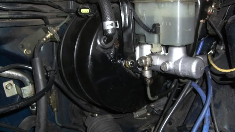

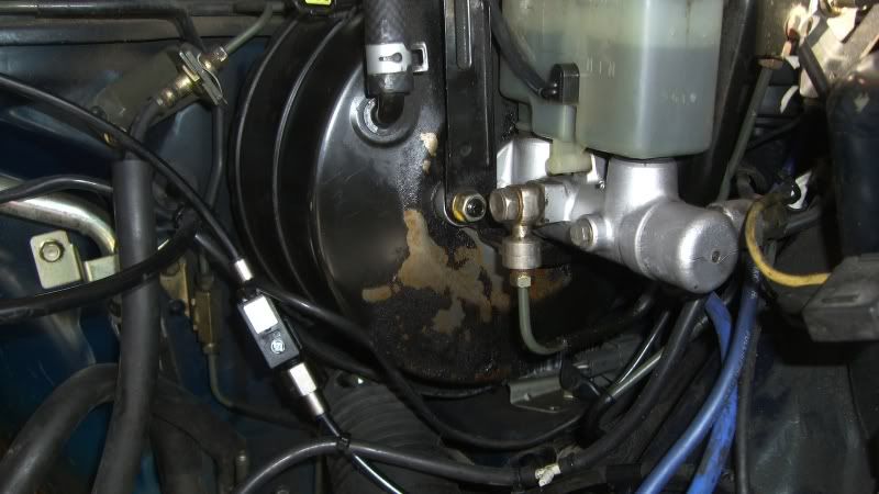

I forgot to post some pics of the brake booster. A few weeks ago I noticed some rust of the booster so I sanded it down and hit with my black engine paint.
Before:
After:

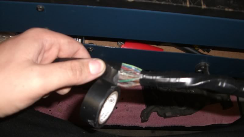

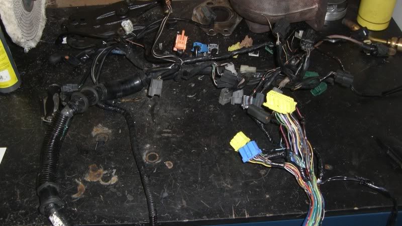

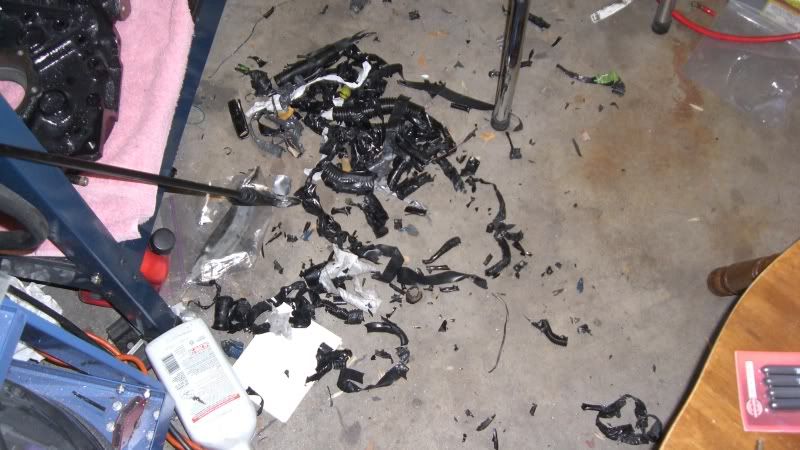

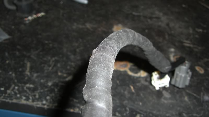

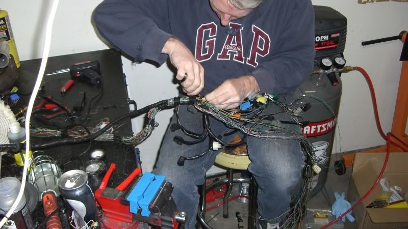

Finally posting some photos I promised from the wiring harness work...
We started with this:
Crispy!

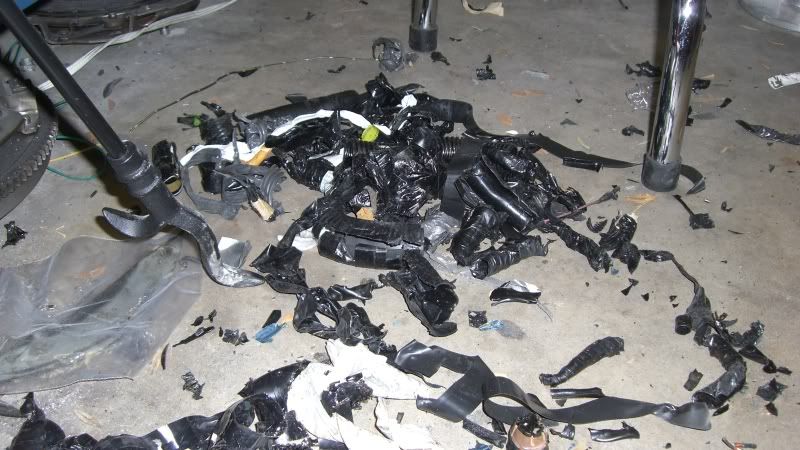

Matt working away:
19 years of rotary engine cooking!

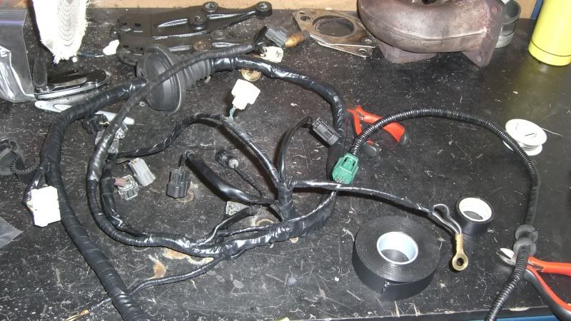

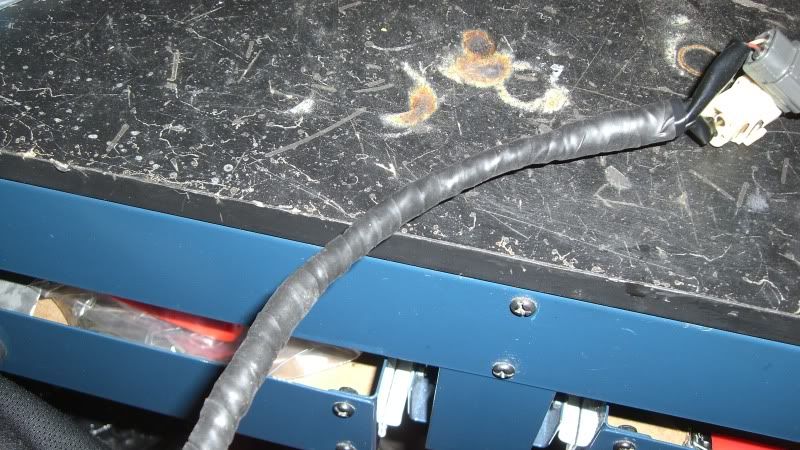

Then I started re-taping it this evening:

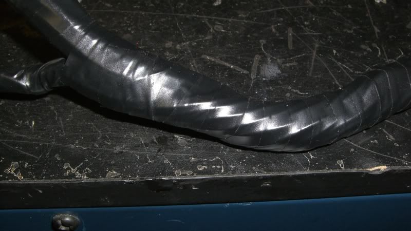

Close-up of the electrical tape:
Super fun job: I worked the rubber boot back on:

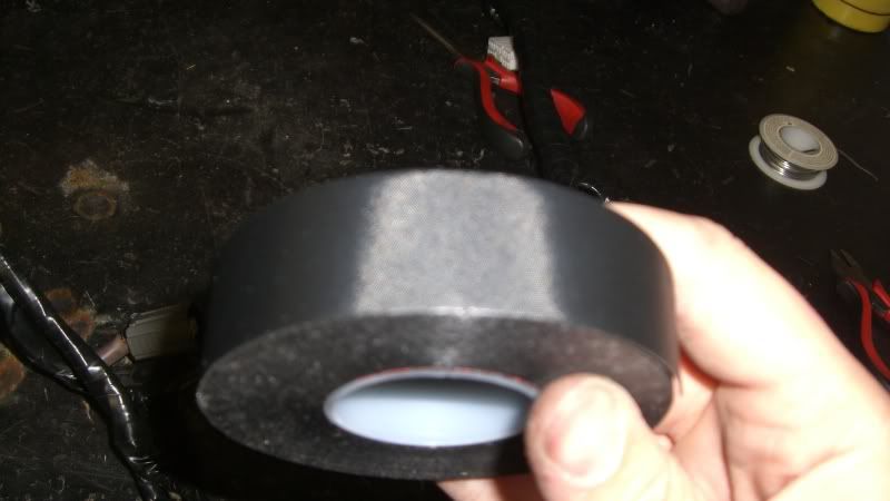

$20 roll of self-fussing friction electrical tape haha:
It was hard to capture how it actually looks under the flash of the camera (without flash it wouldn't expose properly) but it looks and feels like heat shrink. Very rubbery and flexible. Just takes time to wrap.

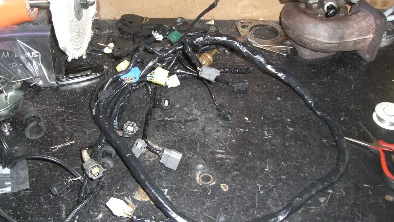

Finally how I left the harness tonight:
That's it for now!

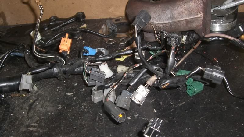

I stripped a bunch. I'll take a picture of the harness connectors, they are nearly empty! I'm just going bare bones.
I only kept:
-Primary injectors
-Secondary Injectors
-IAT
-TPS
-ISC
-Crank angle sensors
-Water temp
-Fan thermoswitch
-Knock sensor
-Factory narrowband 02
No OMP (which is a bunch of wires haha), rats nest is gone, etc. All wires were traced back to the ECU connectors and completely removed.

Yeah I had the same problem with my brake booster, and I solved it the same way lol. Well, I'd rather have it done in another, more permanent way, but I'll be honest, I was pretty anxious to get it back on the road by that time in the project haha.

You cleared out a lot. You left the knock sensor on there right? Also, there should have been another wire for either coolant or oil (don't remember which) going to the driver's side of the engine.

Oh yeah I left the knock sensor. The low coolant level is weird, it's a long single wire with two connectors on the end, one obviously connector to the low level sensor itself, but the other runs thru the harness and connects to a clip in the body/alternator harness. The only part I didn't mess with was the manual transmission disconnects since that section of the harness looked mint.
Yeah, the self fusing friction tape is pretty nice, it's much more "rubbery" than it looks in photos. It's also chemical and liquid/oil resistant, and can withstand heat in constant temps up to 250*F and up to 500*F, I think, intermittently.
