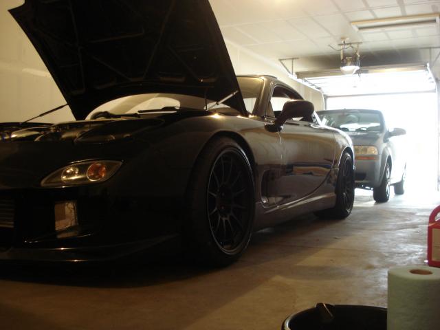

I have 18x11.5 +42MM offset (+41MM effective) right now on rolled stock fenders (285/30/18, 11" tread width).

Wow, I didn't know you switched to 18x11.5 fronts. That must look killer.
With my bumper, it looks like a lot of folks are running 18x11 +38.1 with 315 tires at the front for a competitive track setup. This car has an earlier version of my bumper and is running a squared 18x12 setup with 335 tires at the front. Not sure I want to jump to 335's, but I'll play it by ear.

FDEEZ wrote:Wow, I didn't know you switched to 18x11.5 fronts. That must look killer.
What make and model of tire? and how close is it to the fender? camber?
If I were you, run a wider wheel than tread width, makes all the difference. Weldcraft wheels in MI widens wheels, and they do a damn good job. easily get what you want on this car.
