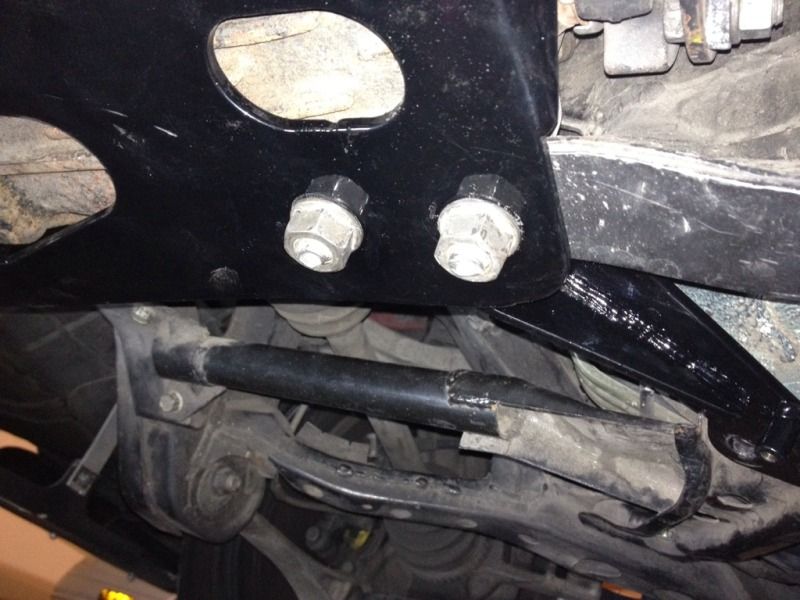

Alright, I'll finally put up the pics from the other night. The first pics are of the diff brace/cradle.
It's kinda hard to tell with the saran wrap on it what it's supposed to look like, but this is it (this is upside down from the way it is mounted on the car)...
This is the gap between the "wing" and the body, 1/2" and it's not supposed to be any more than about 1/8"...

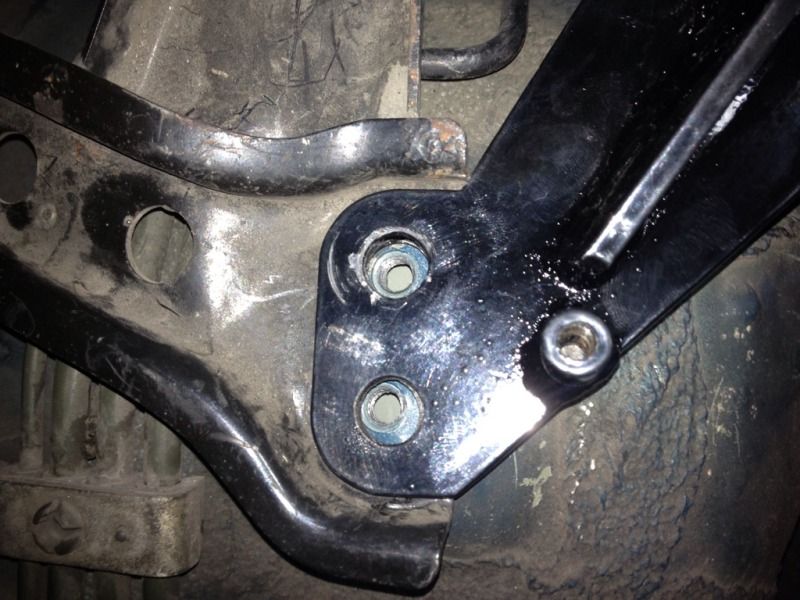

You can see here that the hole on the bottom doesn't line up. It may look like it does, but the threaded part is at an angle that I can't get to because of the hole being off. I even used a pry bar to push it over more but it didn't budge.
And this is on the other side, the bottom hole on this one doesn't line up either, but I can still get the bolt in there.

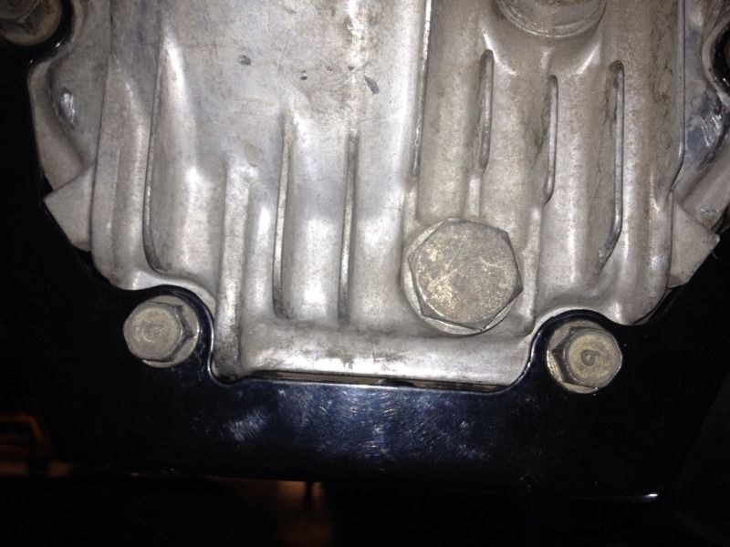

And in these two pics you can see the bottom two diff cover bolt holes don't line up well either, but I was able to press up on the cover enough to get them in and tightened.
And in this pic you can see that I don't really have any threads left on the PPF studs. I think I'm going to get bolts to replace these and remove the studs completely, because they tell you to remove these studs to install the cover. I was able to put it on these studs first and hammer it onto the rear of the diff, but it gouged the cover pretty bad in the process, and took a lot of powder coat off the brace too.

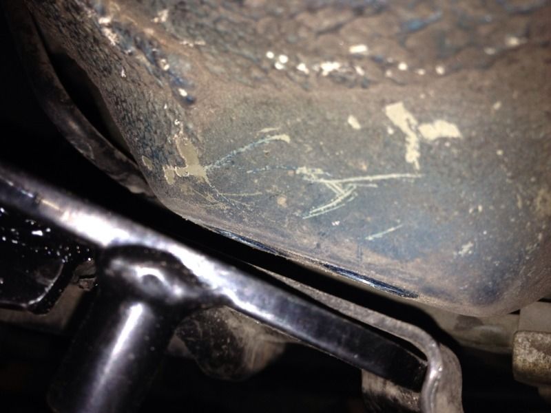

In this pic you can see by the upper diff cover bolts where the brace was gouging the cover when I hammered it.

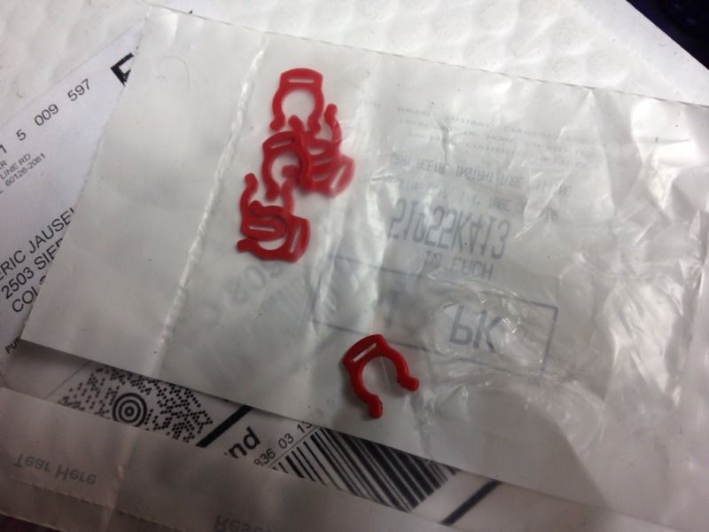

And the clips for the oil catch can, and a pic of one of them installed. I got a pack of 10 for about $2 from McMaster-Carr in case someone needs some.
