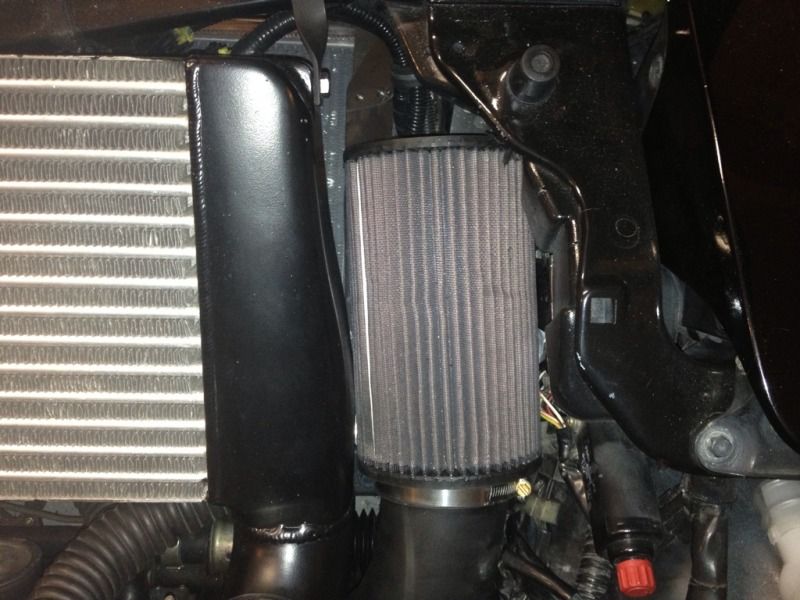

Well I've done a few things to the car recently. Still dealing with a seeping radiator, and trying to get a refund from RX7store. Tom finally sent me the receipt today so I could send it to RX7store and I did that, so we'll see how long it takes them to refund some money. I'm hoping to take another two weeks of leave so I can go home starting next week, but I was wanting to have the NEW new radiator in before then haha. That's definitely not gonna happen. Anyway, here are some pics.
I finished the ducting for the radiator and IC. The other night I did the filter side and the piece between the radiator and IC, and tonight I did the one in the front.
I'd like to make an air box to get just cold air...
And I'm still planning on making a cooling plate for between the bumper and IC...
Tonight I also installed the float sensor in the washer tank, and installed the indicator light in the gauge cluster in the center of the dash, although I got the light a little low because it's touching the dash haha...
And Friday night I flipped my filler neck cap around backwards so that it would look cleaner with the hose coming out the back and running down beside the engine.
