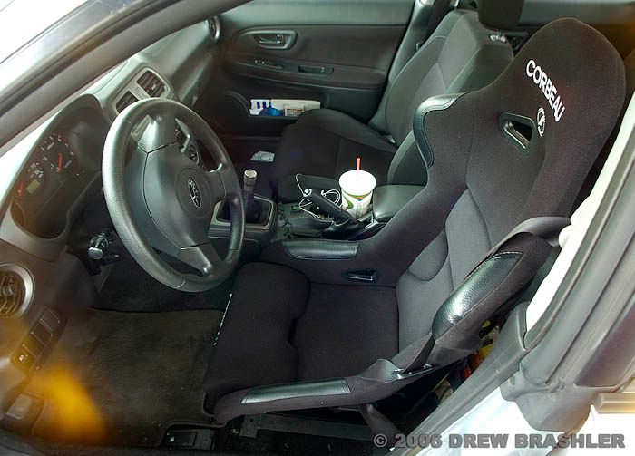

Also thinking more and more about racing seats. I've somewhat settled on the Corbeau FX1:
Price is right at $320 a pop and Corbeau makes bolt-in slider rails for the FD to boot. Fitment is a little tight but not terrible. My biggest concern is with a fixed back seat having enough angle to I get the proper head room. Hopefully the FX1 would sit lower than the stock seat anyways so this wouldn't be a huge concern. But as it is now I can't fit in the FD with a helmet on, so I am obviously hoping with a these seats I would fit with a helmet, so head room is a big issue for me.
I'm also concerned if I could fit in the seats, period, with the bolsters being so aggressive. There is a good thread on 7club with people or nearly my same dimensions (same waist size but smaller height, I'm probably one of the tallest FD owners out there tho haha) fitting in the FX1 so I think I'll be alright. I just wish I could find someone in Colorado with an FX1 so I could test fit it...
