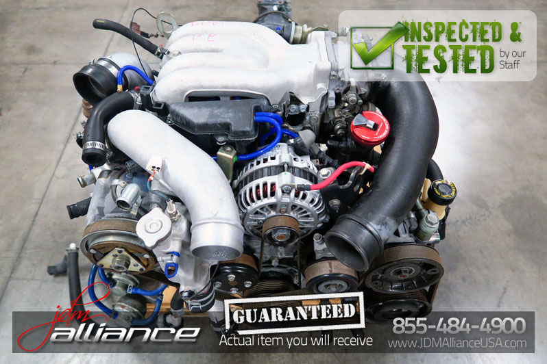

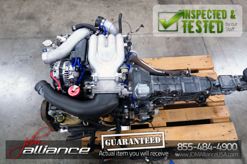

And, I WAS going to save this info until it actually happened, but due to the mishaps today, might as well let the cat outta the bag. I bought a 13B-REW enigne off eBay! It's a complete swap with engine, harness, ECU, trans, etc. I actually bought it about 2 weeks ago. And today was the day I had scheduled with UPS freight for it to be delivered, which is why Eric was coming up.
So right on time, UPS comes with the engine. SWEET. It's on a pallet and wrapped in black shrink wrap so I can't easily see anything about it. As the UPS guy is lowering it off the liftgate Eric notices it looks like a TurboII trans mount on the back. Weird. So the pallet is dropped off and I cut the shrink wrap off. That's a T2 tranny...and it's a T2 engine. WTF!! I check the packing slip and it's has all the right info on it.
So this is what I ordered:
I got THIS:
Clearly a T2 engine/trans and not what I ordered.
I call up the number for the engine import company fully expecting no one to answer or to get a machine and leave a message. Surprisingly, someone answers and I tell them what's going on, he takes all my info and says he'll call me in an hour or so. 30 minutes later I get a call, he asks me to email him pictures of the freight label and engine. I do and he calls me right back and says they sold the engine I bought and the one I received the same day and his shipping guy got them switched somehow (great). Luckily the engine I ordered is yet to be delivered and still sitting in a warehouse, so they are rerouting it and having UPS freight come pickup the wrong engine tomorrow.
I don't have the right engine yet with all the pieces, but so far they have handled this pretty good, even though it's 100% their mistake. I always say everyone makes mistakes, it's how we correct them.
While this was all going on, Eric got his rotary compression tester and we ran a comp test on the T2 engine just to see what it's got. It's showing 81psi front rotor and 0 (as in ZERO) psi rear rotor. We were having a hard time believing the tester so I hook up an old analog piston comp tester to the rear rotor and sure enough, during cranking, the needle never moves. The rear rotor is completely toast!
So, it will be another week until I have the right engine, which I'm hoping to maybe find the time to weld the subframe in so once I get this new engine I can work on dropping it in. I will for sure compression test it as this T2 engine now has me worried.
So there's the updates. Plan is to have the RIGHT engine by next week and hopefully that one has compression and I can drop it right in once I get that subframe welded in.
