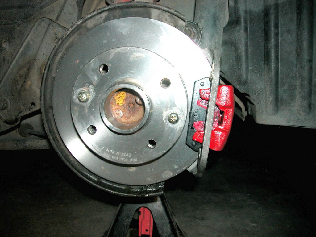

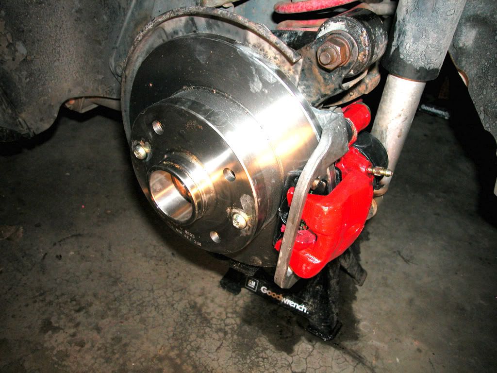

Postby RX-7 Chris » Mon Dec 29, 2008 9:14
I replaced the fluid in the system. I also replaced the line to from the body to the axle since I had all the fluid drained. The car stops on a dime now. I was having trouble with the clutch last week so I changed out that fluid and it works great now as well. I used Gunk High Performance fluid (Boiling Point 401 F).

Postby RX-7 Chris » Wed Jan 14, 2009 9:14
Update: The rear brakes are working great. I do need to adjust the parking brake cables a little, they are not tight enough. When I'm on a hill and the car has sat over night and I get in the car in the morning, the car will move a few inches.
