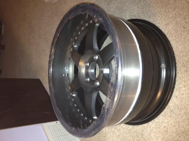

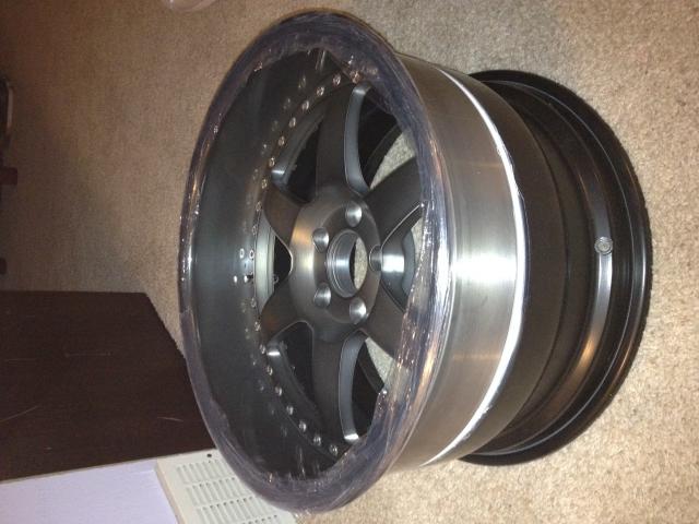

In other news, my wheels finally came in. I'm not crazy about them, but they're actually growing on me already. A couple problems though...for one, the lips were supposed to be either chrome or super black chrome. They are the same color as the faces, just glossy. The other problem is that the faces on at least two of the wheels (one front and one rear) are different shades, the front one is darker than the rear. I've only looked at two of the wheels so far, but I talked to Brent already and he said he would send me a shipping label and I could send them back to be fixed the way I want. I put one of the rear wheels up next to the rear wheels on the car and I think it might actually look pretty good. Maybe I'll hang onto these after all lol. I attached the only pic I have so far, the rear wheel.

On the wheels...they don't have look half as bad as I was anticipating haha. Almost like a WORK Miester evil twin. That's BS the rims aren't even finished like they're supposed to be. At least Brent is taking care of you. I know you don't want to hear it, but I'll only say it because I KNOW you're thinking it: those wheel would look killer with a concave face!
