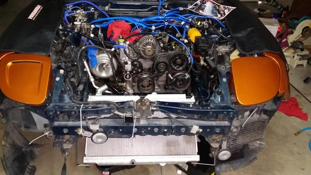

Well I find it very hard to find time to work on this car. This is where it sits right now:
I need to fix that crooked bracket holding my radiator. I will be mounting the IC tonight. I plan on getting it all buttoned up next week!! Lots of little things to do.

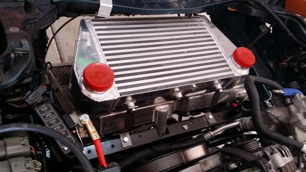

Postby $crillaTor » Thu Jun 26, 2014 9:14
Got the IC mounted. It is sturdy, but I may want to re-enforce that crossbeam.
I didn't move it as far to the driver's side as I wanted to realizing I want to have A/C at some point... I might end up moving over anyway and relocating that A/C canister because as it sits now, I can't come out of my turbo with a straight pipe for the intake. I'll need some funny jogs in the pipe in order to get it where I want.
There is a slight gap between where the radiator and intercooler meet but I can't really avoid it. One of the end tanks on the radiator is about an 8th of an inch taller than the other one.
I need to get those stains off the radiator...

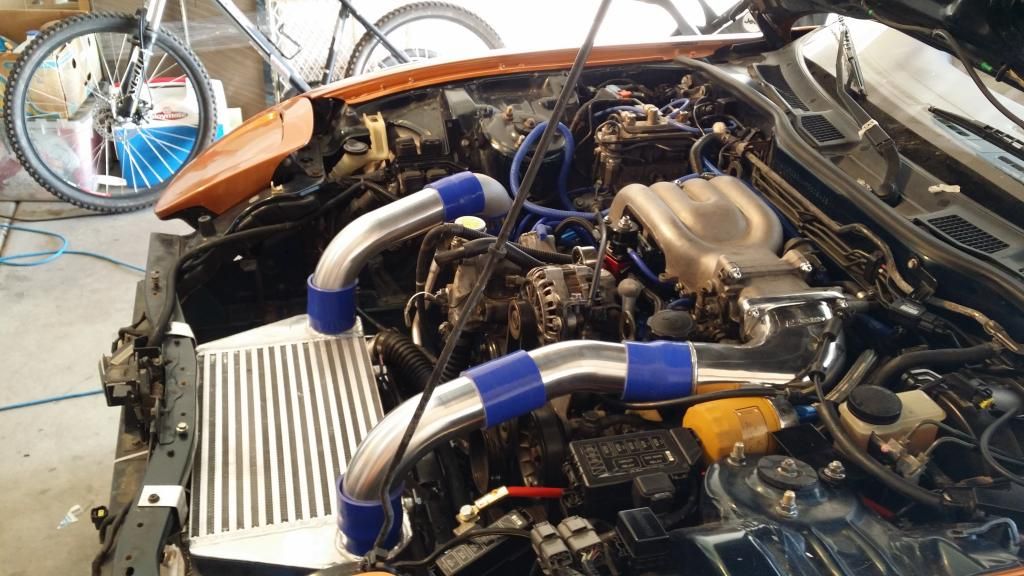

Postby $crillaTor » Wed Aug 13, 2014 9:14
Well I got all the IC piping cut and mocked up. A few of my angle are slightly off (I don't think they are bad enough to cause leaks) so I'm not sure I'll get these welded together. Here's a few pics:
Now, I'm wondering where I should get the BOV flange welded. What do you guys think? 1, 2, 3 or none of the below?
Option #1:
Option #2:
Option #3:

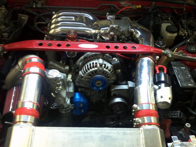

Do it as below, with the BOV on the run pipe. FWIW I would rotate the compressor housing over towards the coolant neck, have a cast tight radius elbow welded on, and in doing so lose the silly-cone elbow and achieve a nice clean look.

I choose option 1 with the vacuum nipple on the BOV facing the UIM. Leaves some room for H2O injection later on.
