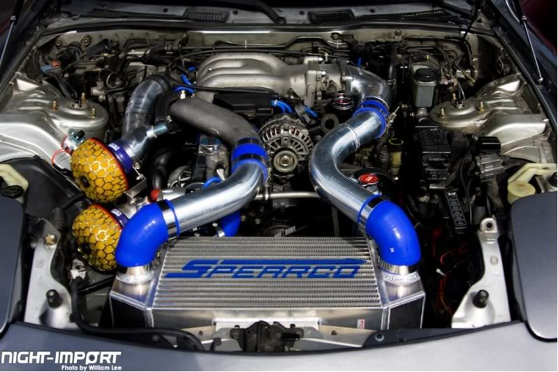

So now I'm back to debating between an FMIC or custom fabricating my own v-mount. Making my own v-mount won't be too difficult, I can buy a v-mount-ready Koyo aluminum rad already modified for v-mount that bolts in for pretty cheap. Then I can have Spearco make a custom intercooler core with end tanks, then I just need the GReddy elbow, 3" aluminum piping, misc couplers, t-bolt clamps, a TiAL BOV, and have a shop weld it all up. I would weld it myself, but I don't have a TIG and my MIG sucks at aluminum, and I want it to look and perform good haha.
If I made my own, I would model it after this guys custom made v-mount (he even shared with me all the dimensions on the custom Spearco IC), which is modeled after the rare Japan-only Famspeed v-mount:

Yeah she was asking like $2500 or something right? I'd make one man, although the mounting brackets alone are worth buying the kit haha. That is a good looking IC but I want end tanks that are smoother flowing, the ones on that Spearco are like the ones I have right now. It probably doesn't make much difference but it's a project for when I run out of other projects haha.

I wish people would figure out to straight shot the hot pipe, sit the intercooler so the configuration is a true v, and use a bigger overall core on v-mount kits.....I have no interest or desire to make enough of them to justify putting the time and money into it though haha

^Well the one I posted has the intercooler in a "true V". I don't think the end tank design will make much of a difference. Air under pressure changes direction with little persuasion.
You don't need a giant core because of the efficiency of the design. While it's true I could get a larger core with an FMIC, I want the cooling capacity of the v-mount, although I haven't ruled-out an FMIC yet either LOL. I also want to keep a full size battery up front, so that limits the size of the core.
