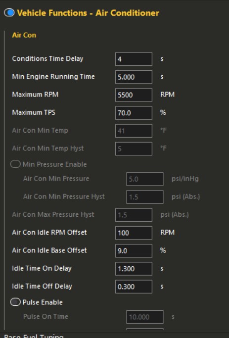

I did some testing tonight and it works, kinda.
Since my AC request switch input is around 3.1-3.2v, I changed on to 3.5v and off is still 5v. I had to up the idle increase from 70 to about 200RPM because the engine kept dying with only 70RPM increase. I eventually changed it to 100RPM.
And of course button mode is now push on, push off, and startup state is last state.
My problem now is when I push off the AC button to turn it off, AC stays on. When I press it again, the button lights back up but the compressor disengages, and the fans stay on. Then when I press it again, it turns AC off fully, compressor stays off and the fans turn off.
