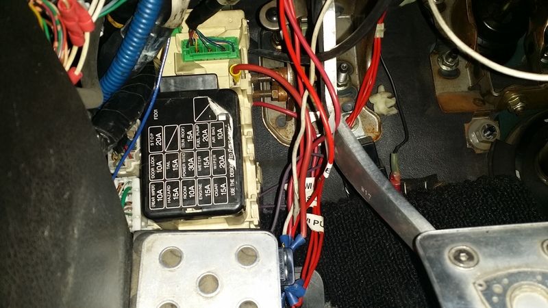

There is a spade connector at the top of the joint box (and fuse box) next to the clutch pedal that gets 12v when the key is turned to accessory. I have several things plugged into that...the 3 water injection breakers, radar detector, stereo, backup camera, radio antenna, all the gauges in the gauge cluster (Speedhut and SPA), and I feel like I'm forgetting a couple things...ALL run off that one spade connector. I have a 10ga wire coming from the connector to a buss bar where I have all the wires screwed into, but that still doesn't account for the fact that so much is run on the spade connector. So whether it fixes the problem or not, I plan to use the fuel pump rewire schematic and use either one or two relays and run battery power to those relays and have that spade connector just switch the relay. That way those things still get 12v accessory power but they're drawing power directly from the battery. I was planning on just using one relay, but if I do that I'd want to run a 4ga wire from the battery to the relay and I'm not sure it would be good for the relay OR that I'd find a solderless spade connector that would accommodate such a large wire. So if I do two relays I'll just use 10ga wire from the battery to each relay and from each relay to the buss bar, then smaller wire from the joint box spade connector to each relay since it's just used for switching.
What do you guys think? I'm going to unplug the current 10ga wire and try cranking first to see if it fixes the problem. Then I'll probably use a multimeter and do some testing to make sure the battery cable isn't grounding to chassis and make sure the starter is getting 12v, and I might jump the starter to see how it cranks there.

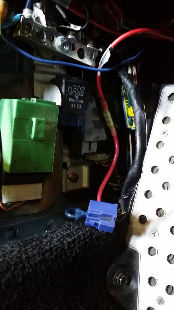

Here is what it looks like so you guys know what I'm talking about.
Ok, I did some testing.
I unplugged the wire to the spade connector, thus unplugging all of those other components. It still cranked slowly.
I got under the car and jumped the starter. It cranked fast at first so I let off. Then I tried it again and it no longer turned the engine, it just spun the starter.
I got back in the car and tried starting it and at first it would just click several times, then it cranked fast and tried to start the car, but no luck.
I plugged the wire back in just to see, and it cranked slow again.
I unplugged the wire and it cranked fast again.
So I think I'm on the right track at least. I'm still not sure why it cranked slow to begin with after unplugging it though.
This sounds like a solid plan. I was going to suggest what you already did, bypass everything and go right to the starter with some jumper cables. Since that fixed the issue (sort of) that definitely points to something funky in the electrical wiring. If you had all of that coming off of that one 12v accessory power, that could be the problem area. I'd have to dig into the wiring schematics of how the starter actually gets its power though to determine if that 12v ACC spot that you're tapping would have any affect on the starter. Regardless, with all the stuff you have hooked up to that, it would probably be smart to make a completely new ACC feed for those components to isolate them from whatever else that current ACC line is used for.
I wonder how hard it would be to just re-wire the starter circuit. I'll bust out the manual and take a look.
Dumb question: If it is somehow NOT an electrical issue... Are you confident that the starter is mounted correctly? If it isn't aligned just right, I could see how the shaft of the starter is binding a bit from being too tight where the driver gear meets the flywheel causing the starter to not crank right. I'm not sure that is even possible on our cars. If I remember correctly there isn't really a way that could NOT be aligned. (Seeing how when you ran power directly to the starter though and it turned the motor over fast, I doubt this is the issue.)

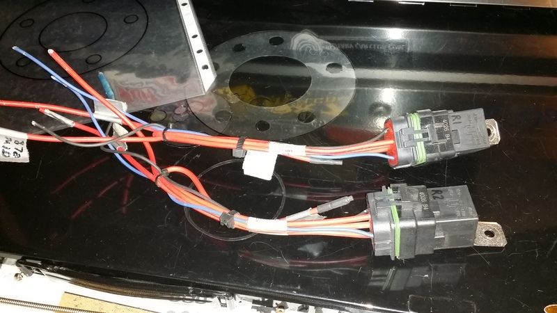

I pulled the two extra relays on the fuel pump wiring, along with all the wiring that's no longer needed. I think I'm just going to use these two for that 12v ACC circuit, although these are larger than most relays so I'm going to have a hard time finding a place to mount them.

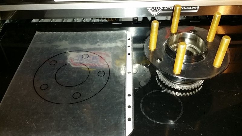

I got a couple page protectors to use for the barrier between the hub and rotor and I cut one out tonight. I got all the holes cut and it fit pretty well. And then I realized with the temps my brakes will see these will probably melt lol. So I don't think I'm going to use these things now.

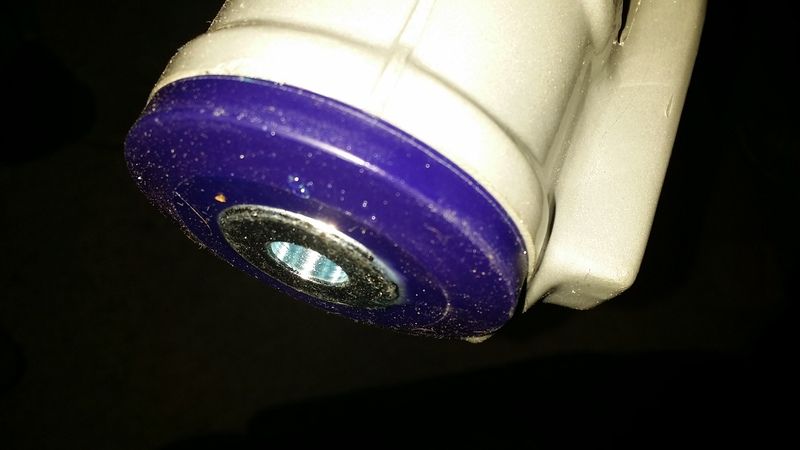

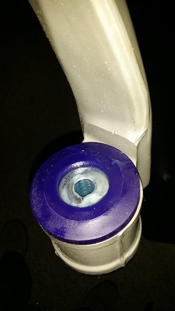

I don't remember if I posted about this before but on the front lower control arms, the steel sleeves for the bushings are a little short. This is one of the bushings and sleeves, it's pressed in almost all the way, and as you can see there is some extra space on the other side.

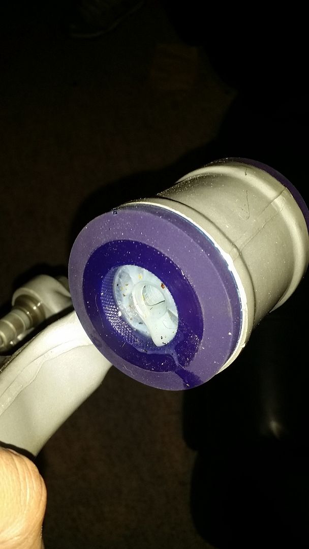

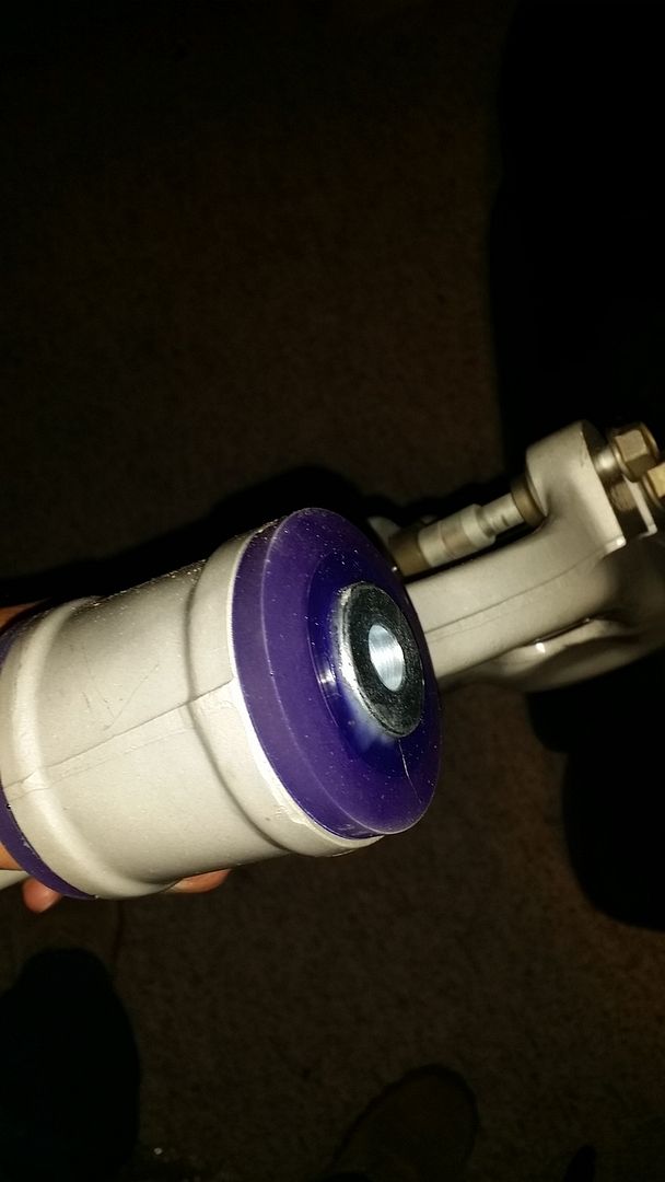

And this is the other bushing and sleeve in the same arm. This one isn't pressed in as far and there is more room left over.
Either way, neither extends all the way to the edge on either side of the bushing and I think the old ones did. If I have to I'll reuse the old sleeves, but I'd rather not. I emailed Juan of J-Auto where I got the bushings, and I also messaged him on 7club and facebook. I have yet to hear back.

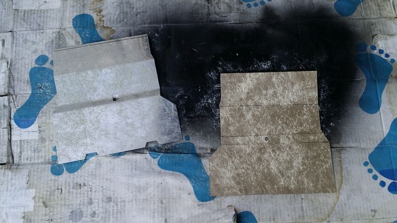

I got the mica sheets and the cargo cover hinges today. First off, the 1/8" mica sheet is a bit overkill lol. It's super thick, I can definitely see using it if my dump tubes were pointed directly at the LIM lol. The other piece isn't quite as flexible as I thought, and I thought both of these pieces had adhesive on one side but now I'm not so sure. I might do some testing with the heat gun to see just how much difference there is between the two regarding effectiveness.

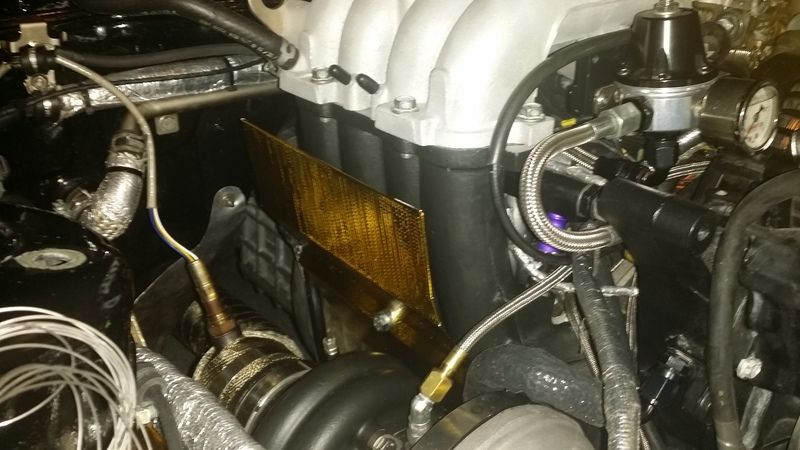

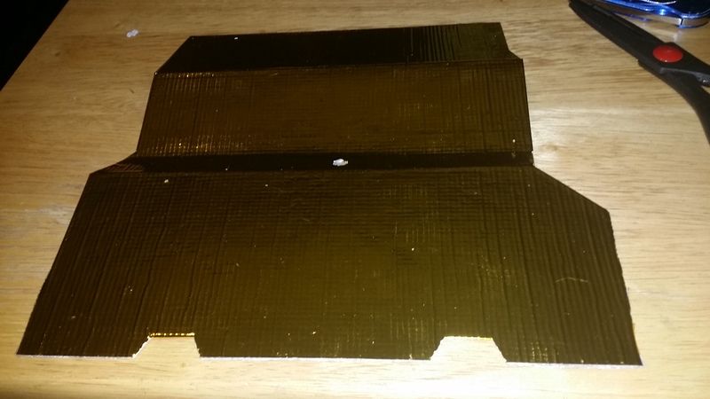

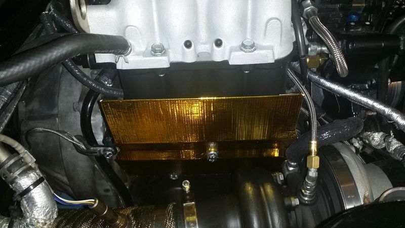

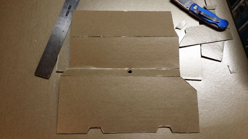

I finished the heat shield tonight. I used the thinner mica sheet and it didn't have adhesive backing like I thought so I used 3M Adhesive 90. Because it wasn't great looking and because I wasn't sure how the adhesive would hold when hot, and also for additional heat resistance, I covered the mica with gold reflective barrier. It looks really good now.

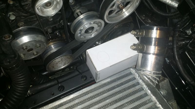

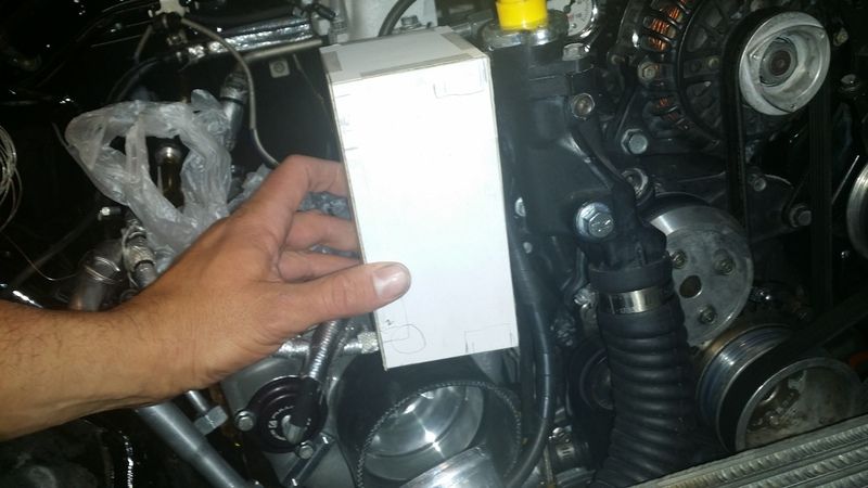

After some deliberation I decided to put the OMP tank in a different place. I was going to put it just above the turbo which would be good for gravity feeding the pump and I wouldn't need to use a baffle inside, but there isn't really enough room for the drain out the bottom since it's practically sitting on the turbo.
So I'm thinking about putting it sideways on the crossmember. I prefer it out of the way like this and there's plenty of room, but with this location gravity feed isn't as good (although I'm not sure it'll be a problem since my old tank was in about the same place) and I'll need to use a baffle or two.
I tried to start the car again today and still no luck. So I'm going to try additive tomorrow and possibly new fuel. Then a tow start I suppose once the car is back on the ground.
