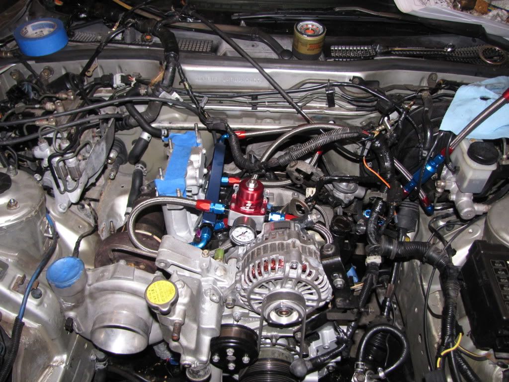

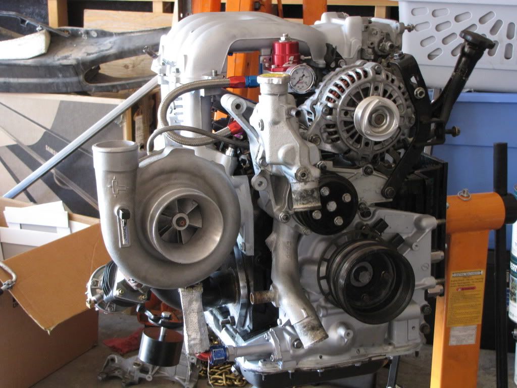

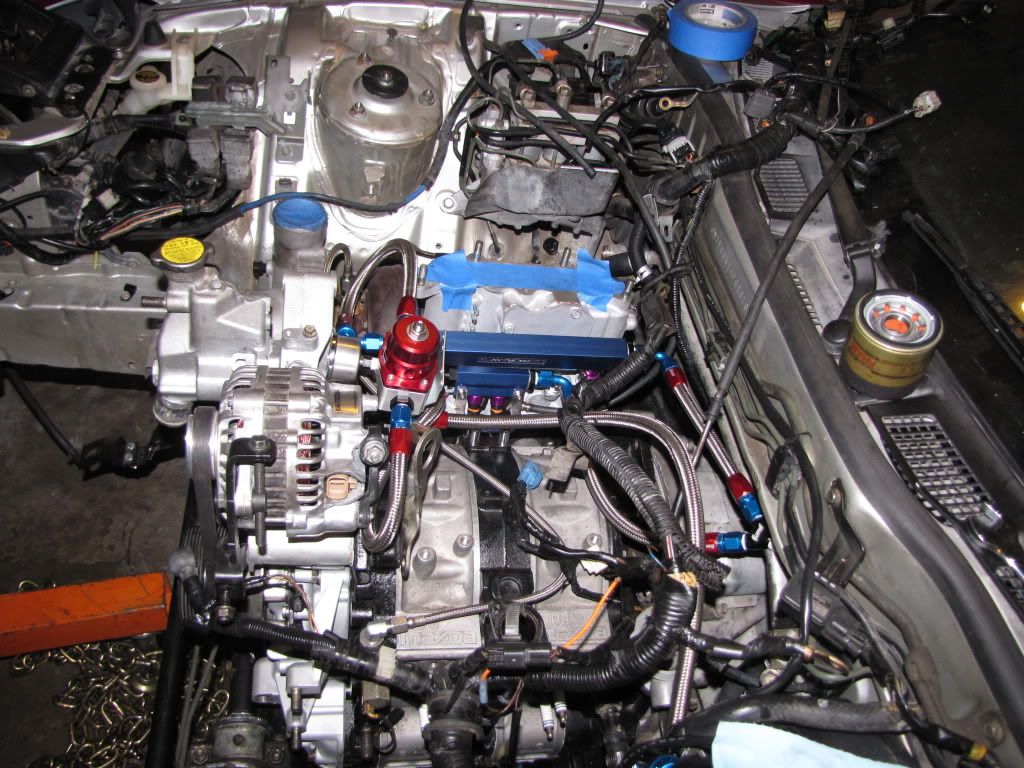

Well i made a lil progress today. Ready to drop the engine back in. Now i need to finish the fuel lines (waiting on fittings) and crank it up :D
Also looped the steering rack
Postby chickenwafer » Sun Aug 28, 2011 9:14

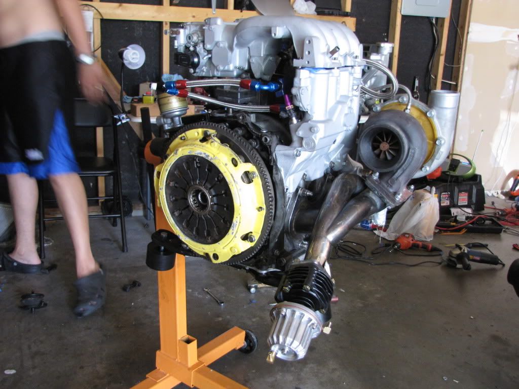

Looks good man. Did you get a new wastegate? And is that a blue gasket inbetween the UIM and LIM? Almost looks like painters tape still..
And nice Crocs, BTW haha
Postby VRx8 » Sun Aug 28, 2011 9:14
yeah i just put the UIM for the picture. Still have to make a fuel line for the primary rail and return line. The wastegate is a real HKS 50mm ;)

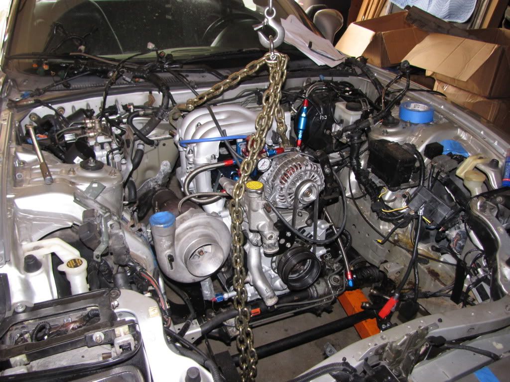

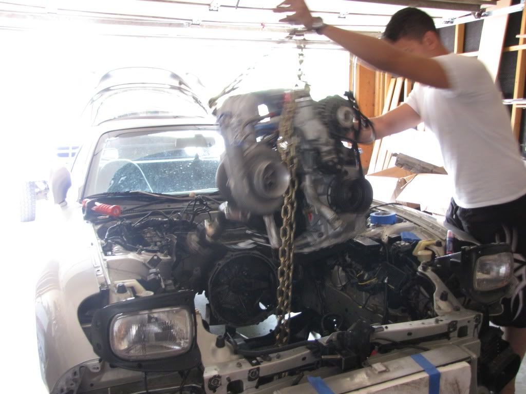

Postby VRx8 » Mon Aug 29, 2011 9:14
Dropped the engine in !! Having a hard time with the engine harness because there is a couple connector that i don't know where they go to, but i'll figure it out. Hopefully shes going to be alive this week. :D Also got my FD stockers today!!
