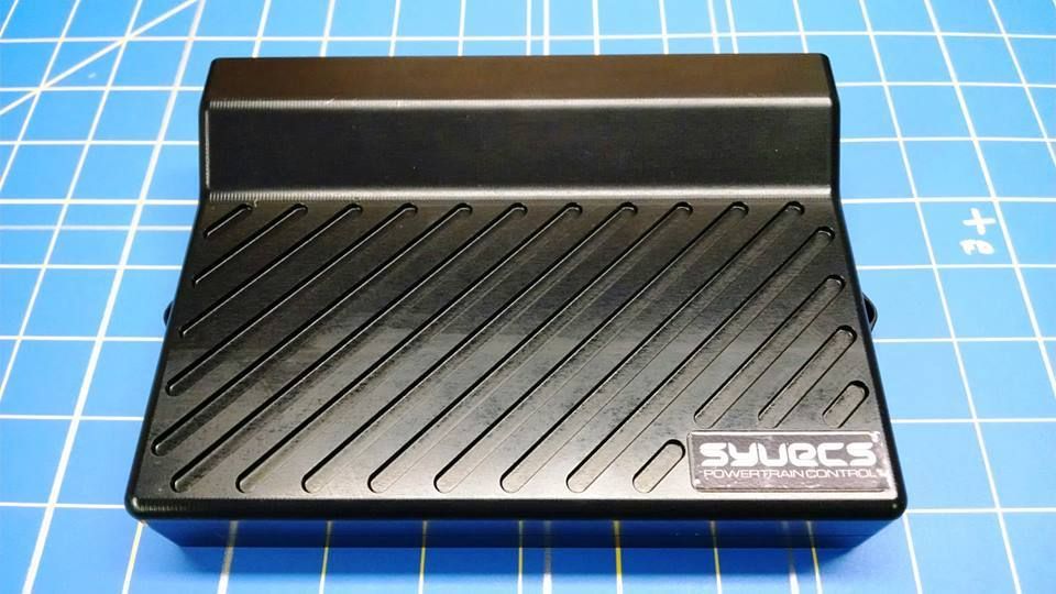

I am back but the car is still in Indiana. He's still waiting on the ECU, but Syvecs finished or is finishing testing on the less expensive S6 Plus so I decided to go with that one. Turns out it has more inputs so I can run even more sensors, and it also does OMP control which he discovered he couldn't do on the S8 without software and firmware updates. I'm going to add another temp sensor so now I'll be able to monitor pre-turbo, post-turbo, and the OEM location and I'll be able to see the efficiency of the IC and it will give me another way to see the efficiency of the turbo. I also planned on testing all our ICs this way if you guys want me to.
He also ran those two fuel pressure sensors separately into the ECU, which is what I was hoping for. I'm hoping to get the car back this month sometime. I really don't want to wait until August to get it back.

Thanks! I actually talked to Chris yesterday. He emailed with the guys at Syvecs.
So as it stands right now they have an S6 Plus that's ready to ship, but they wanted to make sure all the code written for it was good, and they have to write the code to run the OMP. I'm not sure how long that's gonna take, but I would guess I'm not picking the car up until August since I'll be gone for work all next month and unable to get the car. Chris said if he gets the ECU next week he might be able to have it done for me to pick up before I leave. I'd much rather have it at my place next month while I'm gone than still stuck in Indiana.

Chris sent me all the email traffic between he and the Syvecs guys about the OMP control. From reading it, it sounds like this will be a custom ECU due to the work they have to do to make the OMP work. While that kinda sounds cool, it kinda sucks if the ECU ever goes bad because I'll have to go through all this again, and also I'm not sure how long this is gonna take. And I think they need info from a stock FD with stock ECU hooked up and hooking up some kind of scope to it. Ugh, I wonder if I'll ever get my car back lol.

The only way it's custom would be because of what it takes to make the OMP work. Most other ECUs either support the OMP or the owner will delete it altogether and just premix. I want to keep it, but this ECU starts life at Life Racing being made strictly for racing. No AC, no power steering, and most certainly no OMP, among other things. Syvecs adds AC, power steering, etc, but being that the RX-7 is the only car that uses OMP, they don't know what to do to add it. That's where my problem lies. And they don't have an ECU strictly for rotaries, so they've never broken into this market. Again, I'm a guinea pig lol. Well, kind of. One other rotary guy uses a Syvecs, and that's Carter Thompson, but it's on his race car and I don't believe he uses an OMP. Chris installed that ECU also.
Chris emailed me this morning and said Syvecs is shipping the ECU on Friday, but they're still working on the OMP issue, so I'll need to premix for now. I might just tell him to tell them to keep it for a bit longer if they need to if it will help them get it working. It's not like I can pick the car up for another month anyway.

Got a bit of good news today. Chris said that Syvecs told him he should have the ECU tomorrow, and they also have an idea for getting OMP to work so they're sending him an update for the firmware that he's going to test. I hope it works. Unfortunately I'll still be picking up the car in August since I'm too close to leaving for Vegas and getting a plane ticket home for a decent price. Not to mention I want to spend a few days on the trip. Oh well, that'll give him an extra month to get any bugs worked out.

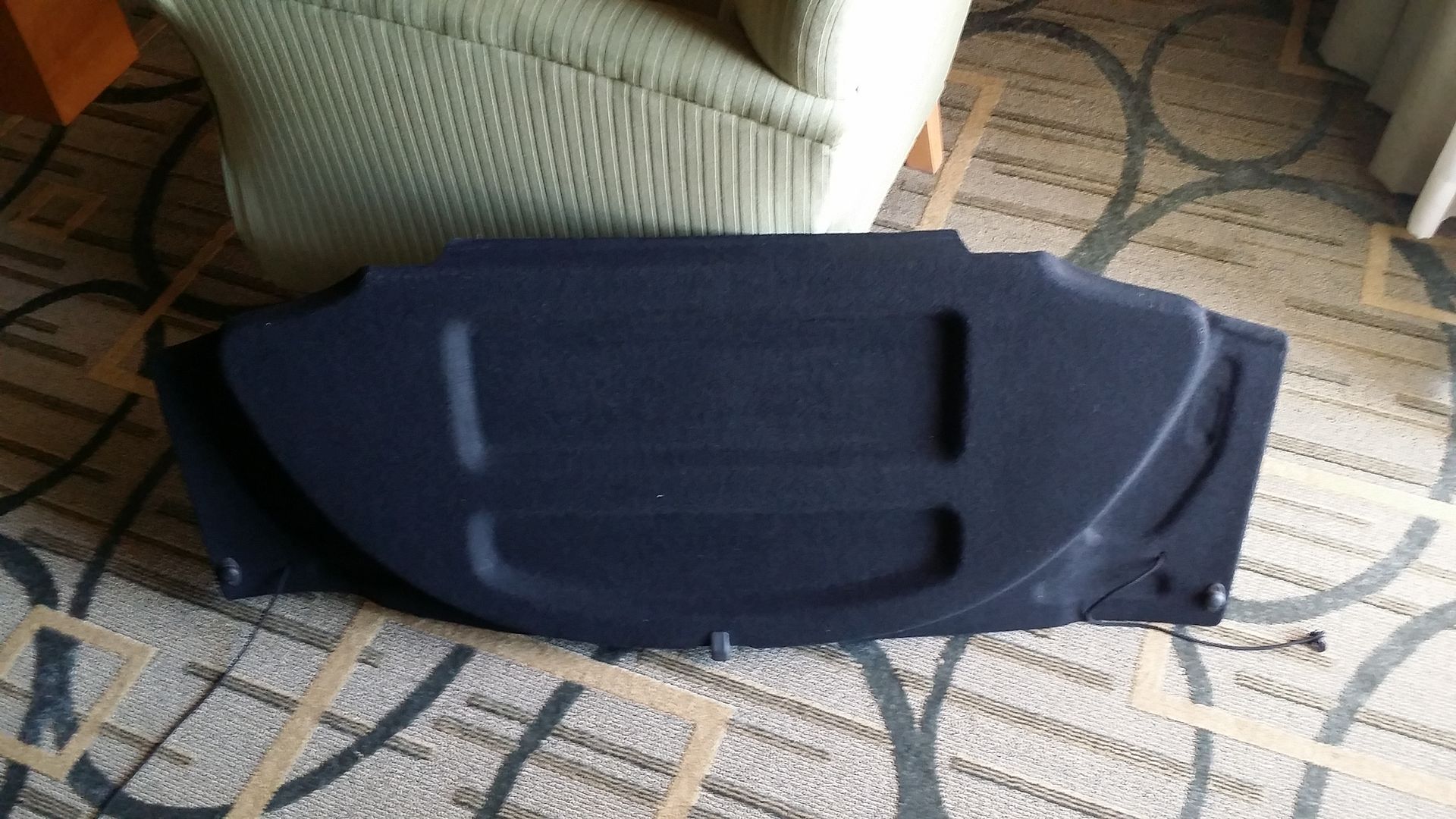

Speaking of the sunroof, I learned about another rare part, way more rare than the cargo cover. I didn't even know this thing existed until yesterday haha. It snaps into the glass sunroof to block out the sun completely. Mazda no longer makes it, go figure, and I know of only one guy right now that owns it, which is where I got these pics. Now, I MUST HAVE IT. lol The search begins. I wouldn't mind getting one and seeing if I could copy it somehow. I'm not sure where to find the clips or whatever it uses though.
