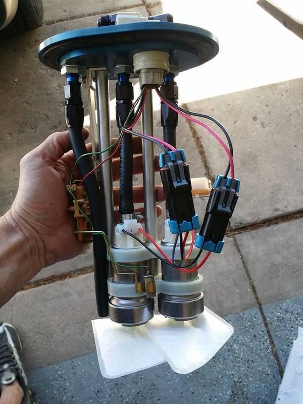

I've gotten some work done but I don't remember everything haha. I took the fuel lines to Whisler Bearing the other day and they quoted me $666.66 to make them out of teflon with SS hose ends. Ummmmmmm, I'll pass, for a couple reasons lol. I emailed Chris to see what kind of price he could do for me and he said he'd work up a quote for me. Whisler is still holding onto my list just in case I call back and have them make them.
I swapped the pumps and had to reuse my old terminals in the CJ Motorsports pump hanger connectors, so Jesse hooked that up for me.

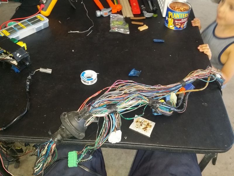

The new chassis harness came in today and I noticed that one of the wires for the passenger side ABS sensor connector had been clipped or something, and another wire was missing altogether. I took my old harness and the new one to Jesse's and we got it all fixed up. Hopefully anyway. I plan to install it tomorrow and maybe start getting the dash back in.

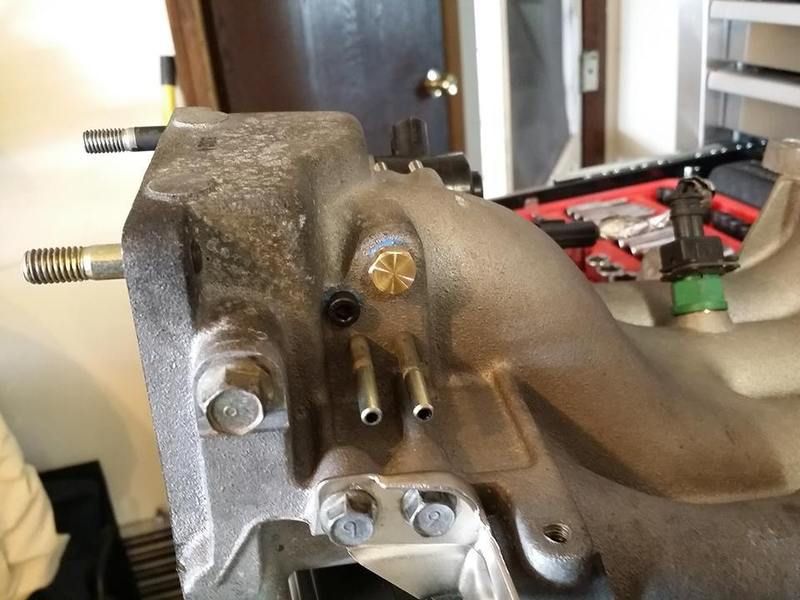

While I was at Jesse's we also pulled the unneeded vacuum nipples from the JDM UIM I'm going to use. I'm going to tap the holes and install setscrews. I have a brass barbed nipple that I should be able to put into the larger nipple we took out, and I found the right plug on Amazon (http://www.amazon.com/gp/offer-listing/ ... dition=new), but I need to find the right tap. One forum says that you can use a regular 1/8 NPT tap, but I need to verify that first. I may just put a regular setscrew in there since I don't ever plan to use it again.

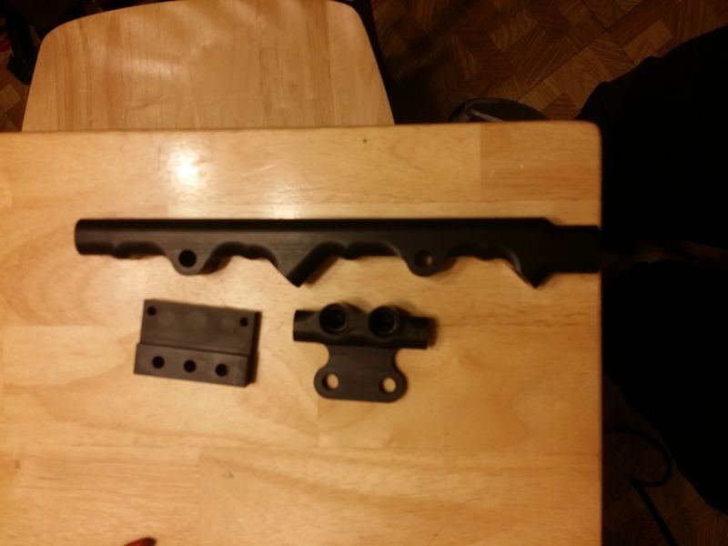

Tom called this afternoon to say my secondary fuel rail and LIM are ready for pickup. I still need to take the fuel rails to Ximpak to get hard anodized, but they were closed by the time Tom called me, so I guess that'll be Monday. At least I'll be able to reinstall the turbo, LIM, UIM, etc, and get the end tanks mocked up for the new IC. I'll have to call Mitch to see if he can come over this weekend.

I got a little more work done today, along with getting the fuel rail and LIM back from Tom. I forgot to take a pic of the rail. I had to use a file to clean out a couple places in the new injector ports, and I'm going to drop off all the pieces to Ximpak on Monday.

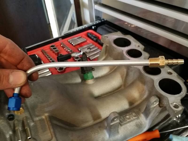

I plugged the holes in the UIM left by the nipples we pulled out. I was able to find a plug at ACE Hardware for a couple bucks so I didn't have to order it from Amazon for $16+ WOOHOO! And this way I can put a nipple back in if I need to use that port again.

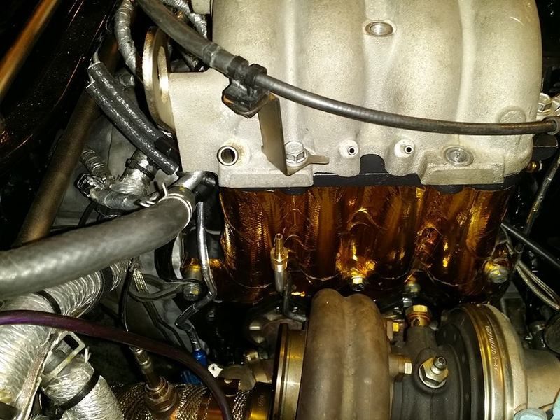

This is the line I made the other day, and I made another one tonight but I don't have a pic of the line itself, just where the nipple ends up, and a pic for where this one ends up too. You can barely make out where it is in the third pic though. The one for the UIM needs to have a way to stabilize it during driving, it's just going to flop around. So I still have to work on that.

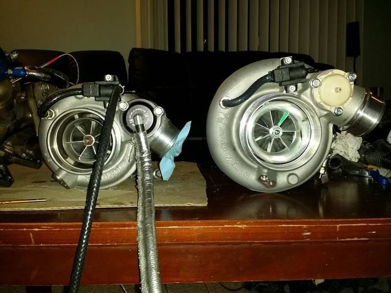

Bobby brought his 8374 over the other night so I could see how it fit in the engine bay, but I forgot I didn't have the LIM in there to check haha. I took a pic comparing the two though. I didn't realize the 8374 was so much bigger than the 7670.
Here is a pic of the new pump setup.

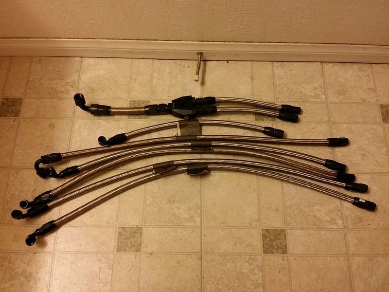

Here are all the lines I need to have made for Flex Fuel...these are just the ones I made last year for pump gas.

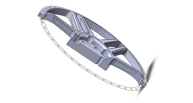

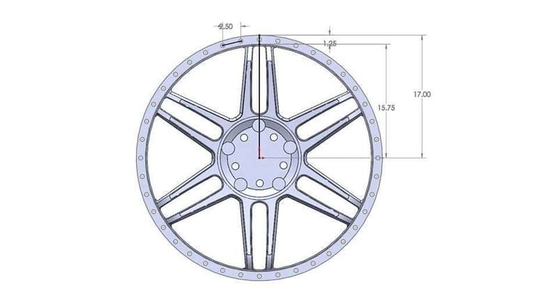

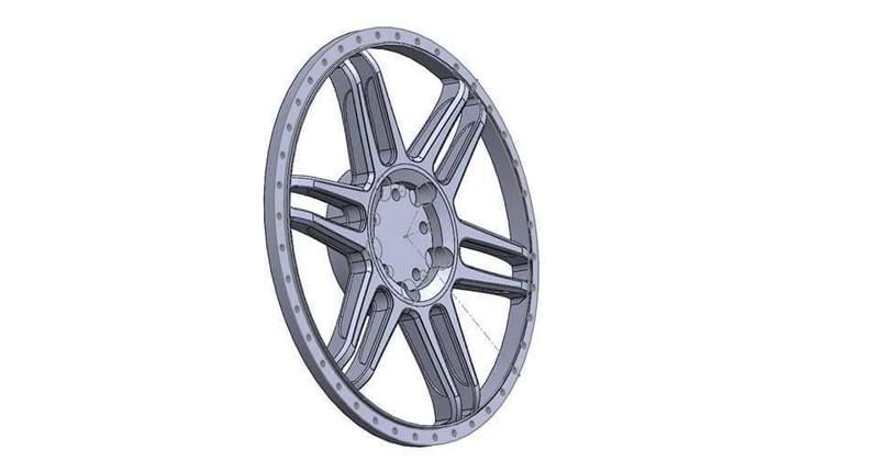

Here are pics of the first draft of the CAD Alvin is doing for the wheels. I took some measurements of the angles on my wheels and sent them to him and he's going to refine the design.

How did you seal the brass hose barb to the aluminum tubing?
Did I misunderstand or are you having some custom 34" wheel faces made?!?!

I didn't seal it, which is one thing I'm somewhat concerned about. However, it's REALLY on there. I'm going to leak test them at a higher psi just to make sure they don't fly off. But so far they seem like they seal pretty well.
Yep, I'm bout dat DONK SON! lol I'm not sure why it says 17 right there, but it's a 17" face overall, for an 18" step lip modular wheel.

I discovered today that the wiring on the pumps is incorrect, and since I have to depin them and I need two more injector boss adapters anyway, I decided to order new terminals with the boss adapters and just solder on new terminals while I'm swapping the pins.
I finished up the new chassis harness today and started installing it, but didn't even get halfway finished before I had to do something else and I didn't get back to the car tonight haha. I'll finish installing it tomorrow.
I took the fuel rails to Ximpak today but decided to wait since I forgot to get the shavings out first and they said that if they anodized it that way, the anodizing would go over the shavings and they could flake off later, exposing the raw aluminum underneath. I was also torn because I was thinking I should have taken the in-tank surge tank, but it needs to be modified first. Then this afternoon I was thinking again that now I could just go with the drop-in assembly that's built around the hanger, and just hook the Hydramats to it. Although then I'd still have to figure out a way to mount the float sensor to it, and just now I'm wondering how I'd hook up the lines to it after it's already dropped in lol. Eh, better just stick with the old design and get it modified and anodized lol.

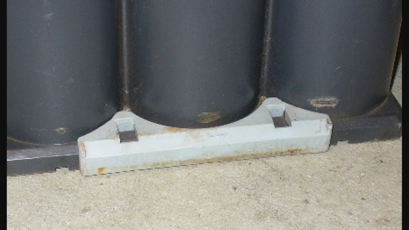

I'm trying to remember all the updates since a few days ago. I made the battery tray but it puts the battery too tall, so I have to find the clamps that hold the bottom of the battery and just bolt those through the floor, something like this.
The injector boss adapters and terminals from CJ Motorsports came in today, and I picked up the fuel rails from Ximpak yesterday, so I installed the rails last night and the boss adapters and dummy injectors today, along with replacing the terminals on the fuel pump wiring today. Here are the fuel rails.

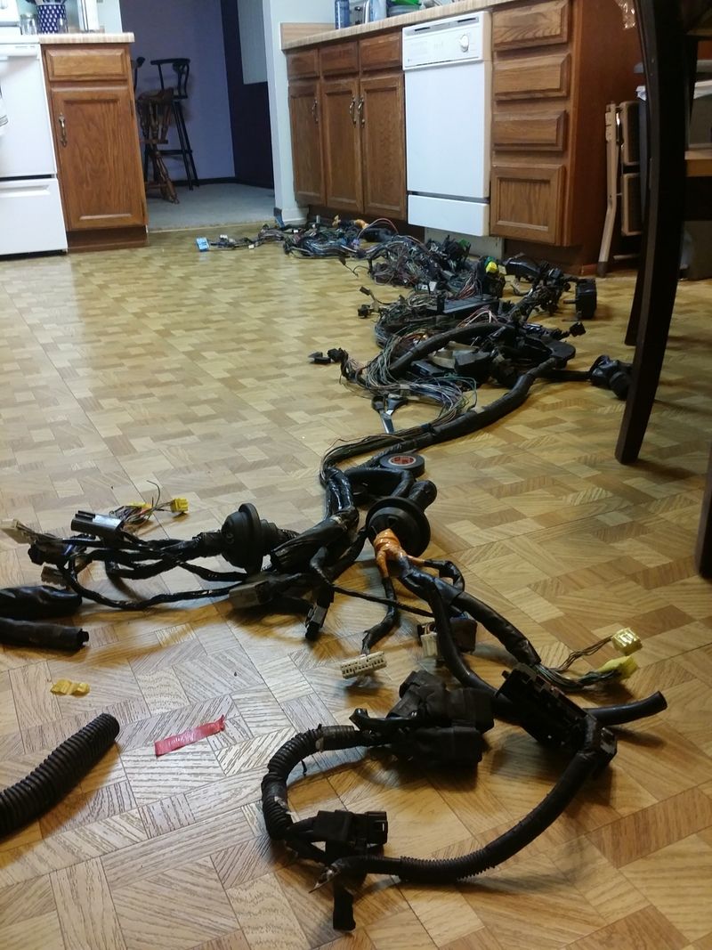

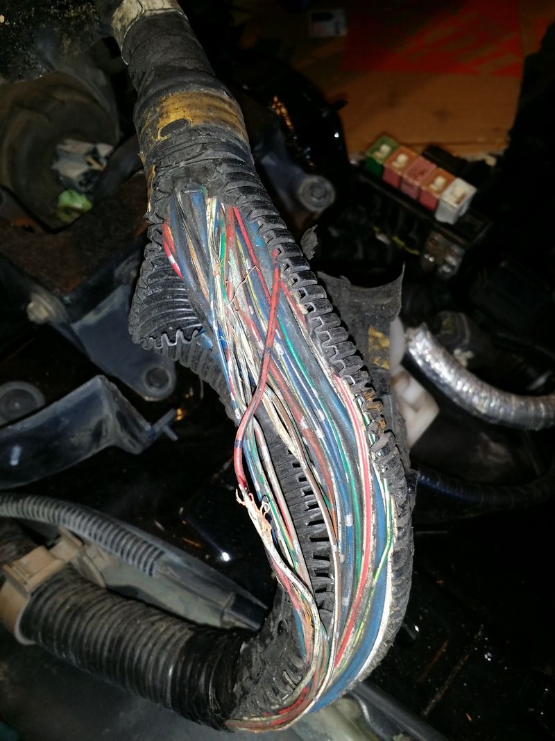

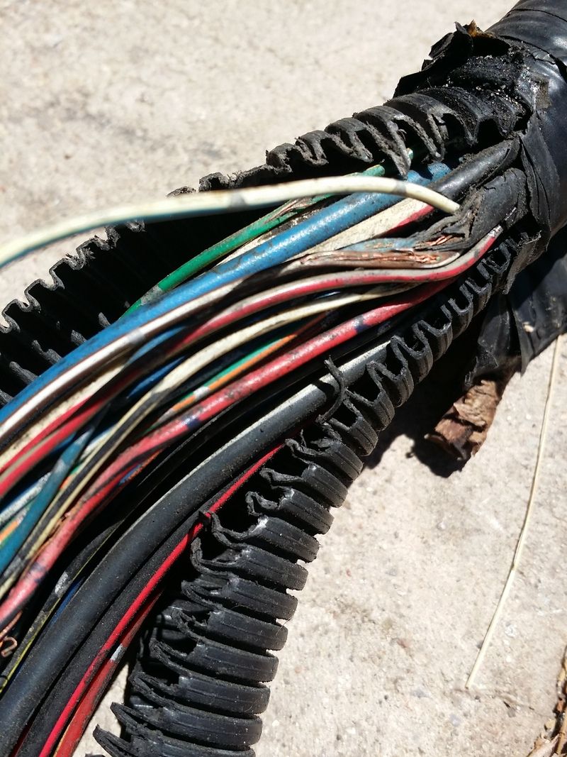

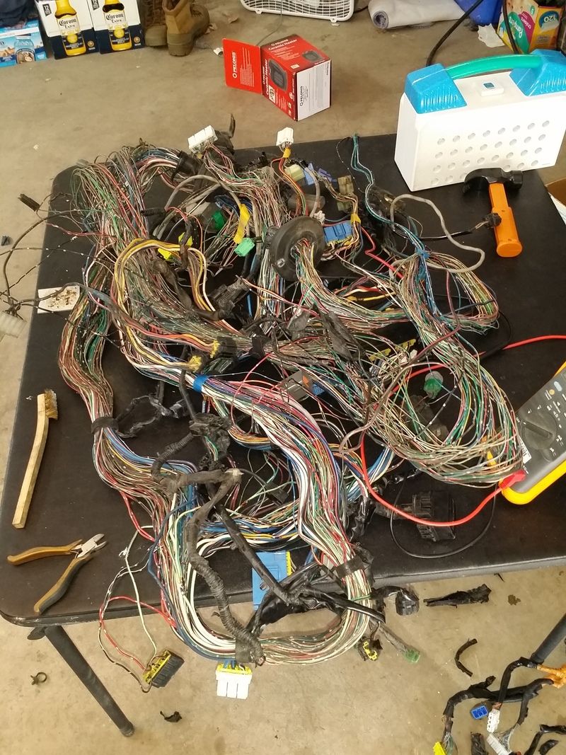

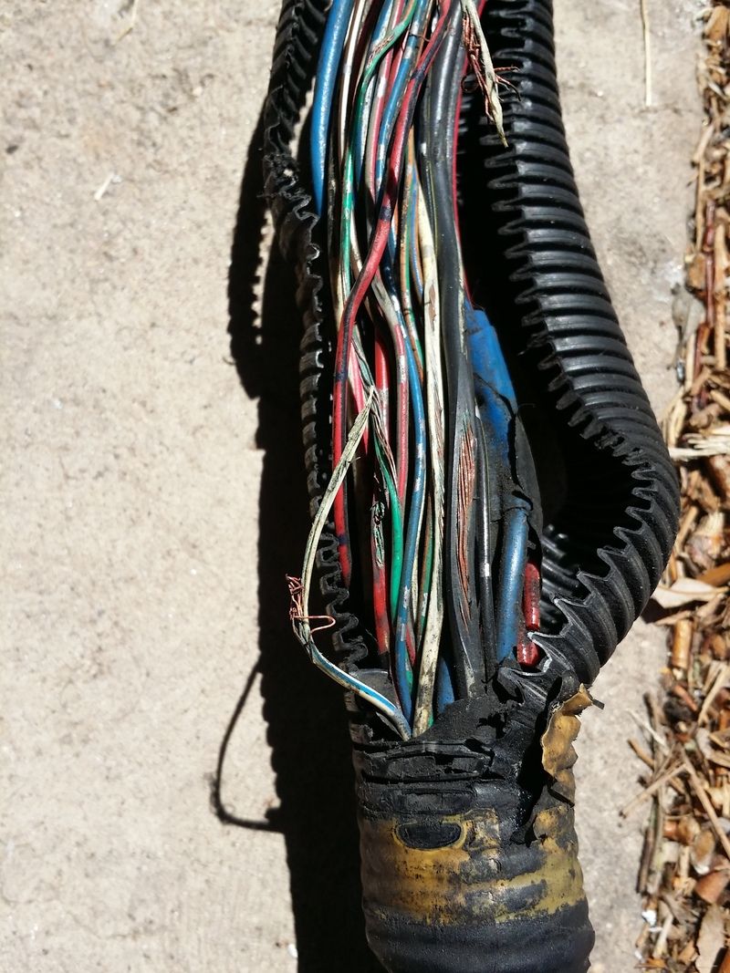

The other day when I was installing the chassis harness, as I was running it over the driver's tire I noticed new tape. I peeled off the tape and discovered at least 11 wires worn through by the tire, one of which was broken completely. And he tried to cover it with tape. NOoooot cool. So I pulled it back out, took both that harness and my original harness to Jesse's, and over the next couple days we completely unwrapped my harness and checked it over, checked continuity on all the important wires, soldered points where the factory had just clamped wires today, and then I rewrapped it yesterday and installed it last night and today. Here are pics of the damage on the harness I bought.
And here is when Jesse and I were going over my harness.
Here I had both harnesses laid out on the kitchen floor to start rewrapping mine.
And here it is finished.

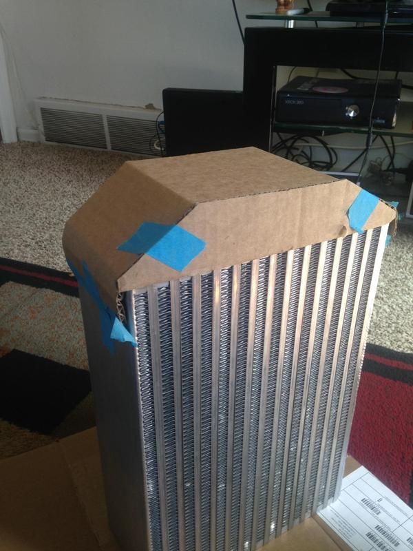

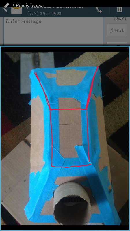

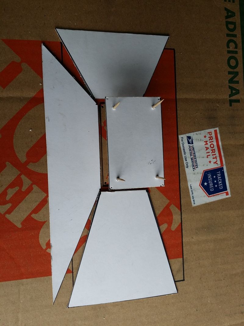

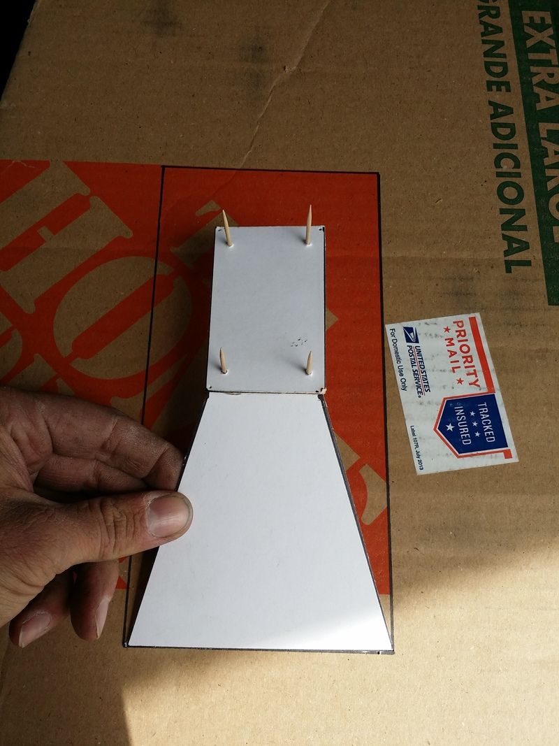

Mitch sent me some pics of his mock up of the IC end tanks. I'm pretty happy with them overall, but I told him I'd try to mock something up myself to show exactly what I'm looking for, and I keep forgetting lol. I really need to just let him do his thing and finish it. I also asked him to make me an oil reservoir tank for 2 cycle oil. This is the first version he sent me.
I asked him to angle the sides of it in. He sent me this pic and the red lines are where I modified it a little more. I'm trying to get the far side to angle down more to direct the air more evenly over the whole core.
Or some directional pieces could be added like in this one to direct the air.
Regarding my comment earlier about shady sellers...crap like this pisses me off. Anyway, good luck with the repairs...we can't wait to see the beast on the road again.

Today, I rolled Shadow's fenders. That's about it lol. I also mocked up a cardboard end tank the way I want it and dropped off the pieces to Mitch. He said he'll have it tacked up within the next couple days.
I need to braze the brass nipples on the aluminum lines still, then I can install them and install the turbo and everything else.
