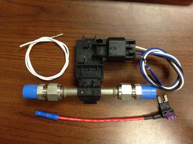

I bought a flex fuel sensor from Pace Performance and turbo speed sensor from Full Race the other day too. I'm still looking for hose suitable for submerging in E85. I'm told to get PTFE teflon but everything I've found so far is stainless steel braided and I'm afraid it won't be flexible enough.
