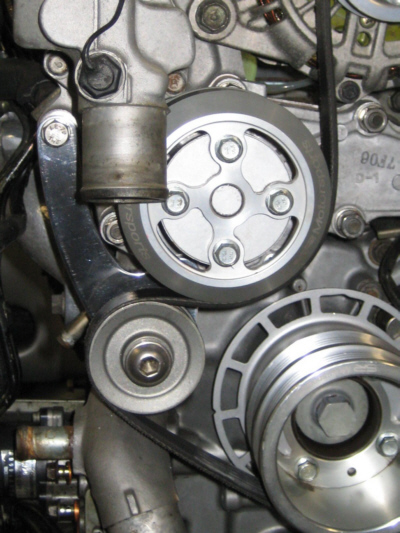

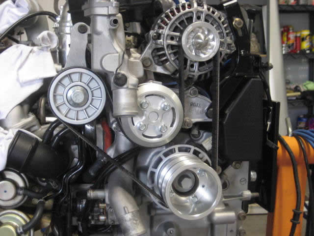

Haha, GReddy doesn't make an elimination kit like I'm talking about, that is something that is made by a forum member on RCC (he might be on 7club too). Tweakit Racing I think is who made it. Actually I think I'm gonna try to buy one from him. ANYWAY, GReddy only makes the pulleys for the Alt and WP, which are only underdrive pulleys. They are a little bit bigger so it helps a little with the contact patch, but sometimes not enough. The one Tweakit makes is an extra pulley that mounts in place of the air pump, but doesn't stick out as far, so it keeps more of the belt on the WP pulley, that's all it's for. I'll see if I can find a link or pics or something. Taking the front bumper off isn't hard, there are a couple bolts in the engine bay there at the front, and there should be a screw at each wheel well, and there are alignment bolts but they don't have nuts on them. IIRC there is a total of 2 bolts and 2 screws. The only problem is you might have to take off the front wheels to get to the wheel well screws, but that might be just because of the way MINE is set up. I can finally see your pics, and it doesn't look like the piping extends into the oil cooler passage, so you should be fine.

http://rotarycarclub.com/rotary_forum/showthread.php?t=5627&highlight=air+pump+deletion (not sure if you'll be able to access the thread, I attached pics too)
The first pic is for a twin turbo setup (the pulley looks different now I believe) and the second pic is for a single turbo setup.
