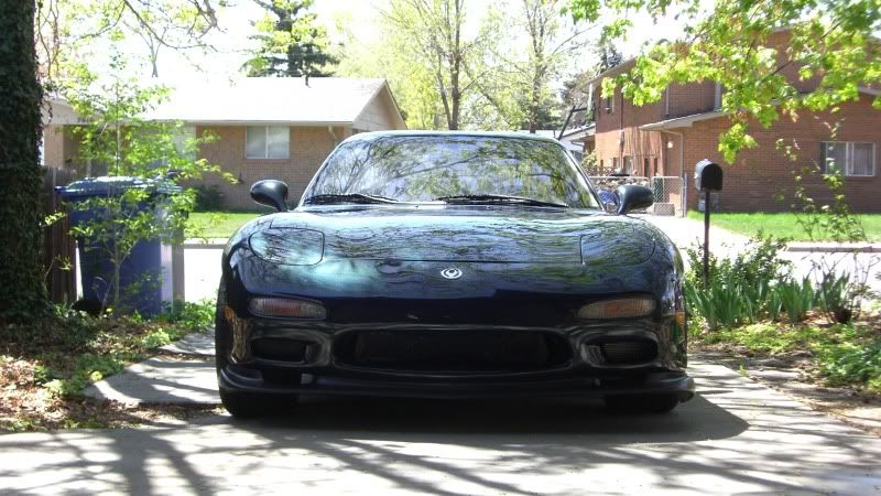

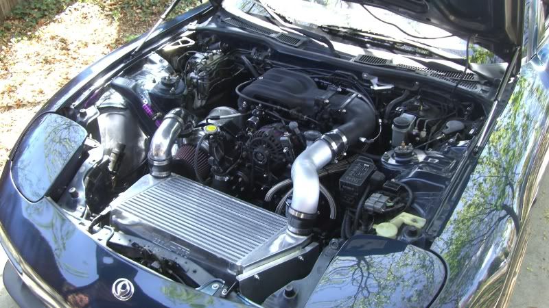

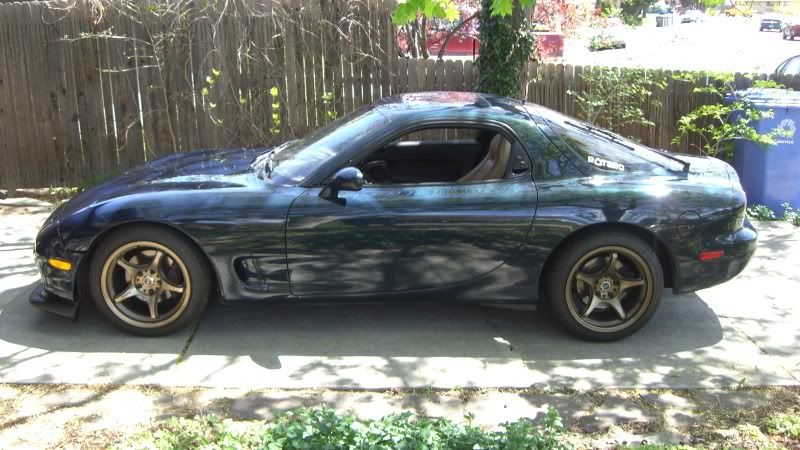

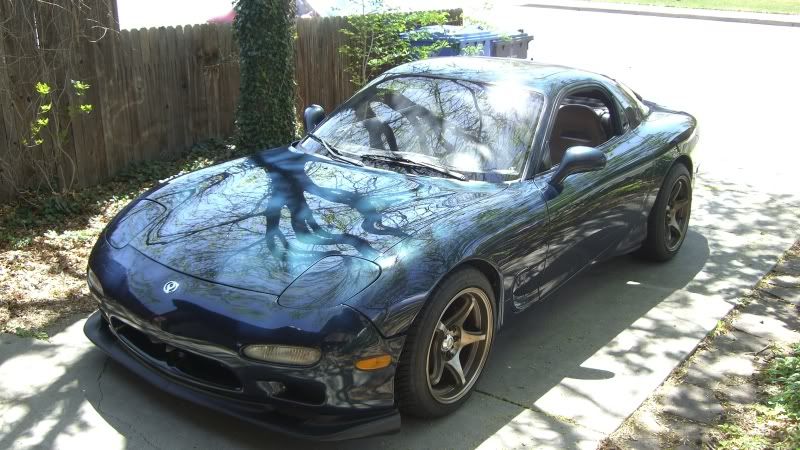

Quick pics...and before anyone says anything, no, the bumper isn't fully bolted on.

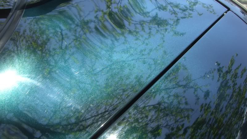

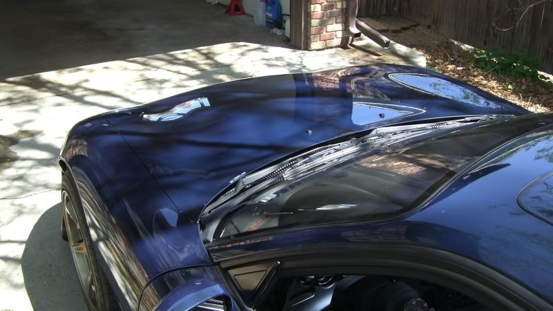

Also took these two to show the color change in the factory Montego Blue ( MB ) Paint, the first is how it looks in direct sunlight, basically green:
And then this picture is in the shadow, and it's a deep blue. Pretty cool.
Still thinking I might paint the charge pipes wrinkle black and leave the v-mount aluminum, trying to decide. But for now, I'm going to fix the stupid downpipe and then enjoy it for a while.
