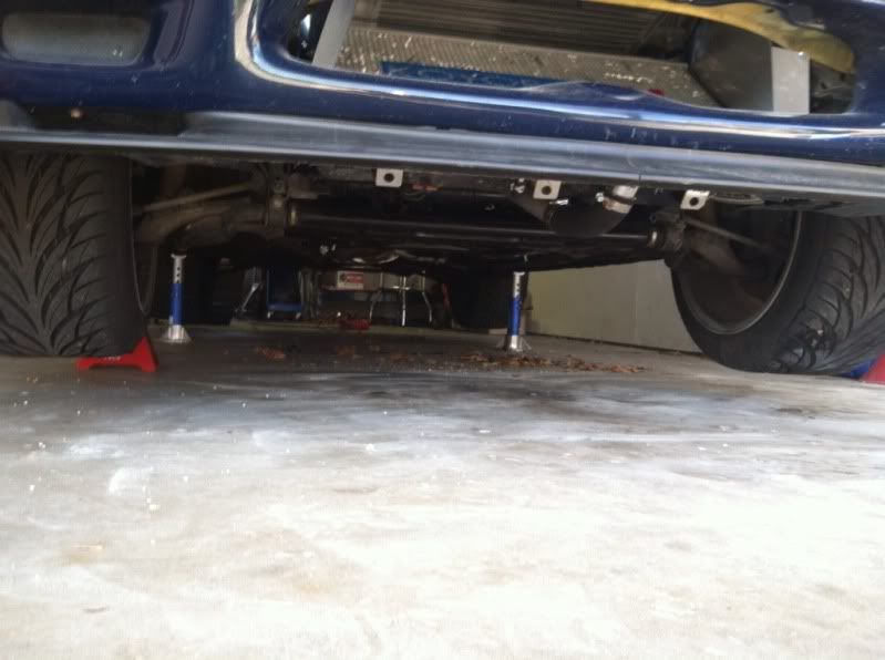

Got home and put the FD up in the air on all fours. Spun each wheel and heard nothing unusual. So I put the trans in neutral and spun one of the rear drive wheels so the driveshaft would spin...yup, the driveshaft is rubbing on the rear of the mid pipe resonator. This stupid downpipe fits like shit so the rest of the system suffers. Now I need to look at getting either this POS downpipe to fit correctly, or just get a whole new downpipe made.
On a positive side, I'm pretty sure all my leaks are sorted. I saw only a small drop of coolant on the garage floor today and when the FD was in the air I wiped down the subframe directly above the leak spot, and sure enough it was wet with some coolant. I looked around again and didn't spot any leak points.
Finally, my parting picture. This is what happens when you have a super stiff FD chassis, only 3 jack stands haha:
