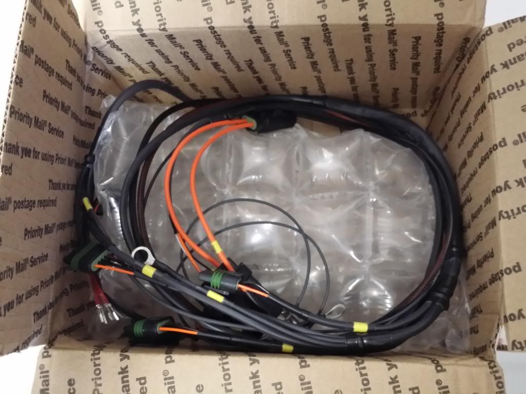

I haven't been working on the car much for a while now, but doing little things here and there and collecting parts for the upgrades. I'm still waiting on FFE to get back to me about a coil mount, but I think in the mean time I'm going to weld one up because I got the harness from Ludwig today and I think he made it to fit the way I was planning on welding it, not the way FFE likes them.
I think installation will be more involved than I originally though lol. I'm guessing I have to run it through the passenger side of the cabin, and then through the firewall somewhere. I'm just not sure how I'm supposed to get it through there.

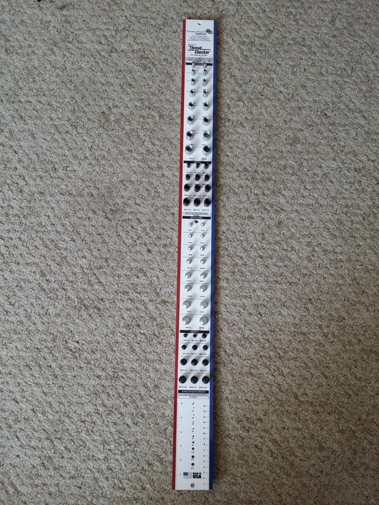

I've been cleaning the house and cleaning the garage, and I put up some Mason jars to use for nuts and bolts (like has been done for decades), and I've been checking threads on every nut and bolt I have and putting them in their respective jars, and I got this thread checker to help with that.
Now I just need to figure out where to put it and finish cleaning the garage. Then it's onward to the sheds for parts inventory, selling, organizing, and cleaning! Well, maybe I'll try to fix the car before this. But if I get it fixed, I'll want to be out driving on nice days instead of doing the sheds lol.
