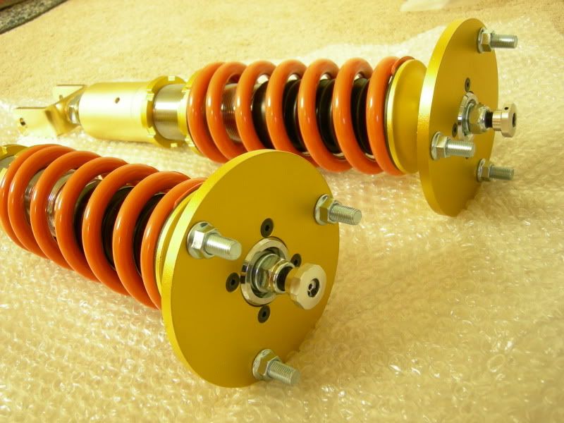

So yeah. Check it. Legit ride height coming up.
These things are oretty well built.
If you're wondering why there is no camber plate...FDs are adjustable from the factory using an eccentric bolt, no need for camber plates. The FD has a double wishbone suspension, and these are technically shocks with springs, not struts like earlier RX-7s and Mazda 3s have. I've yet to actually mess with the suspension...so we'll see how that goes
I'm going to ask the shop if I can go put them on while it's there, I just can't wait.

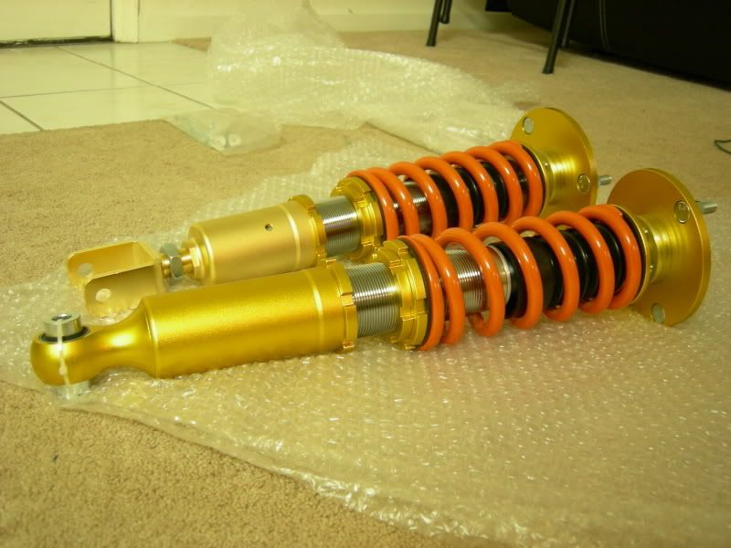

I'm going to ask the shop if I can go put them on while it's there, I just can't wait.So the guy is going to give me a refund for those turbos. Apparently, he bought them from his friend, who told him they were in great condition. And since he trusted his friend he didn't even check to make sure they're good. :? Tomorrow I'm taking mine over to the guy who's rebuilding them.

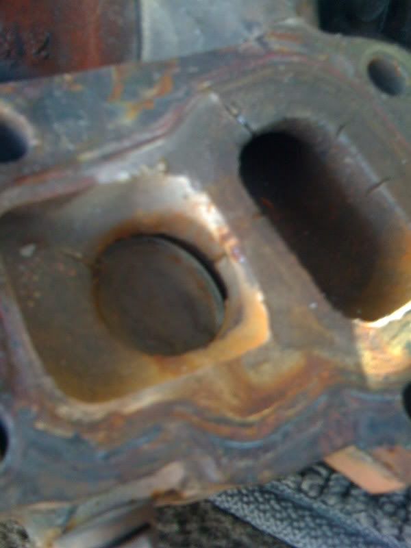

Stuck wastegate and cracked manifold...

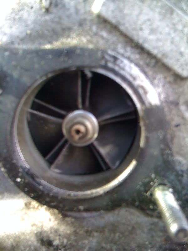

Gross...this is the impeller wheel would not turn. It's scored on the edges.

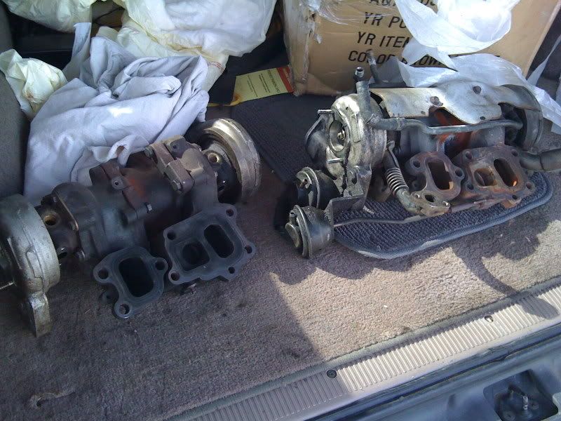

My turbos on left, "new" ones on right. They both look bad, but mine are actually in pretty good shape compared to the ones I bought...
The ones that were on my car are in much better shape. No wonder I only paid $400 for that crap

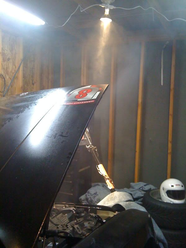

Oh and here's a fun pic of my 944 burning a ton of oil off the exhaust. While I had it on track, the oil filter seal broke and it spewed oil all over the car. Yes that is oil the hood is covered in. Anyone have suggestions as to how to get it off? I've tried simple green and glass cleaner...
