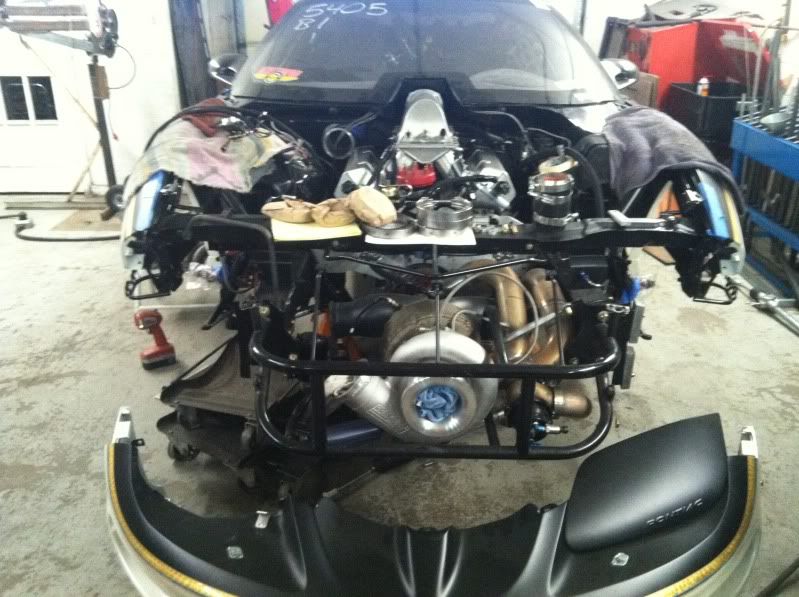

Went over to my fabricators place today (http://www.overkillracecars.com/) and the owner, Justin, did a great job doing a real quick weld on my manifold for my TiAL MVR wastegate. He quickly TIG'ed it and it looks great. He also gave me a great deal so I will be going back to him for sure. Thanks to Matt for getting me his info.
He also had a fully built turbo Firebird in his shop for Pro Mod NHRA racing...500+CI built V-8 with a 94mm Precision billet turbo (the small turbo haha, they have a 122mm in reserve) that made 1420ish rwhp on a dyno at just 15lbs of boost...in race trim they run 30+lbs and they MAX OUT dynos haha. Crazy! I snapped a quick cell phone pic:
