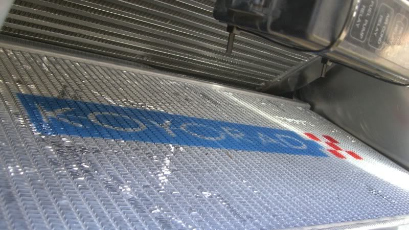

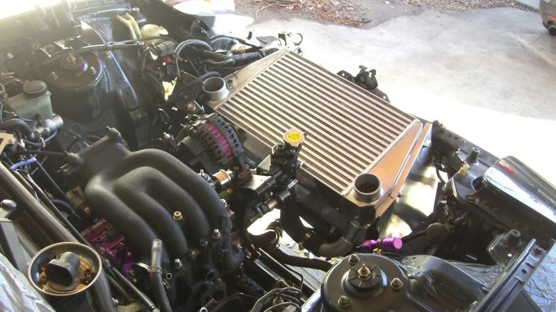

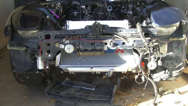

Pictures of the v-mount installation:
The rad has a few bent fins from handling putting the fans on...plus the intercooler fell when I was trying to line it up in the brackets but luckily the "damage" was minimal to the radiator. Could have been a lot worse. I plan on straightening most of the fins later.

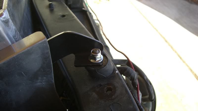

And here is the "odd" installation issues I'm having. The upper radiator/intercooler mounting bracket is in the incorrect location, it's supposed to be in the hole to the left in this photo, but you can see that would put the bracket too far away from the radiator:

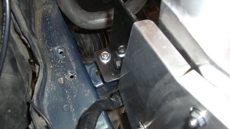

And here you can see the rubber top mount on the passenger side (same side with the incorrectly located radiator mount) being pulled backwards due to the stress on the bracket:

hard to tell from the picture, but the front crossmember does look a little twisted to me on the passenger side.

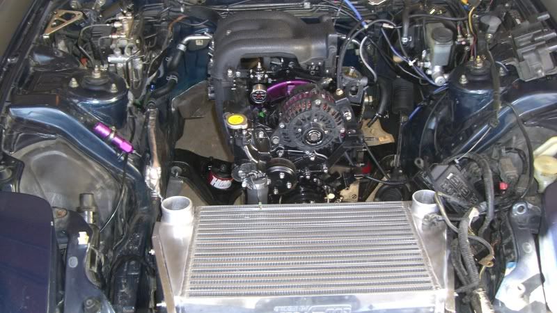

Also, holy intake heat soak batman. And those zipties that hold the fusebox will not last. vibration will eventually allow the sheet metal to cut them and the fuse pane will fall and rattle along with the wiring to it..... i'm hinting at power wires meeting chassis groind here...

SecondGenPAt wrote:hard to tell from the picture, but the front crossmember does look a little twisted to me on the passenger side.
What heat soak are you referring to? The intake to my turbo (not pictured) or the intercooler placement itself? V-mounts are some of the most efficient way of running a charge cooler setup so I don't see much heat soak here. I also might run a "splitter" made of aluminum in-between the radiator and intercooler to prevent heat from radiating up to the intercooler. I'll see how my IAT's are first.
The zip ties on the relay box are also temperoary, I plan on stealing Eric's idea and using riv-nuts in the frame to securely mount it. There is no sheet metal near the relay box so I'm not sure what you're referring to there either, the fuse box and engine wiring obviously isn't mounted in this picture, they were moved out of the way.
