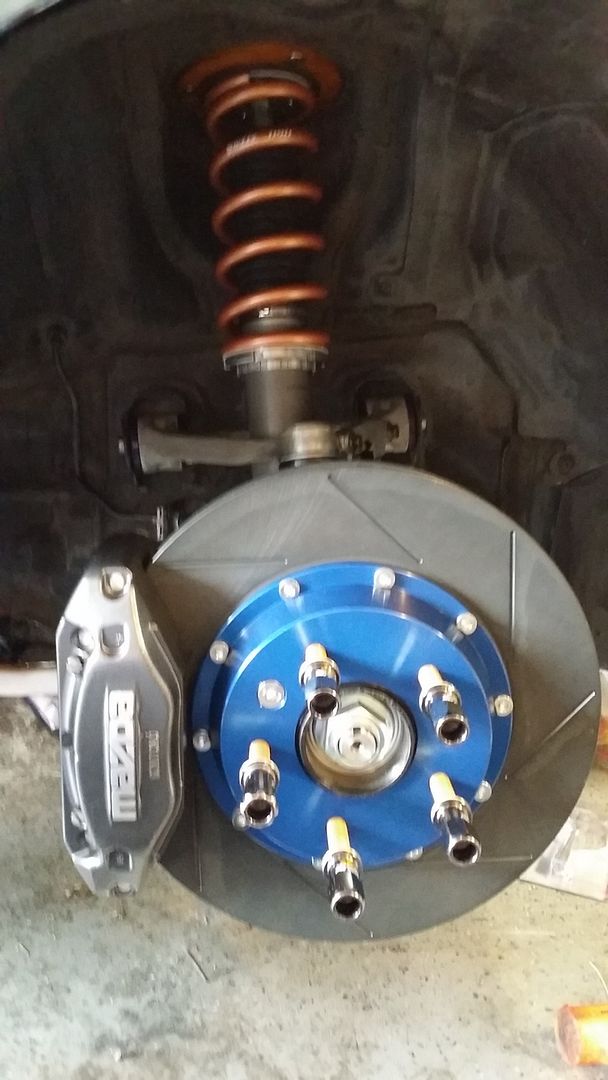

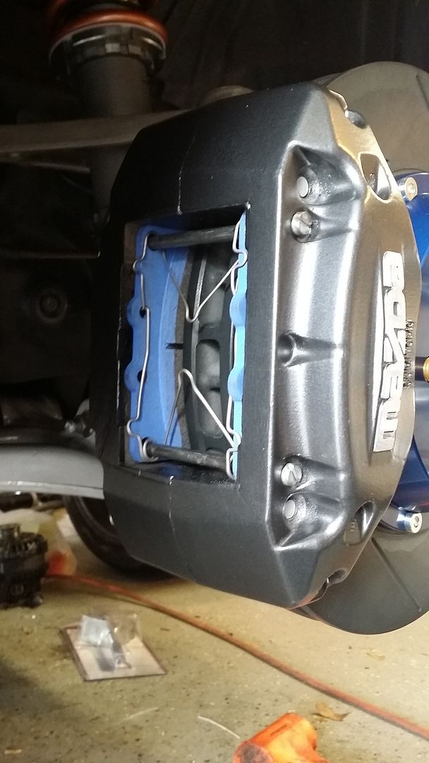

I haven't touched the car in a couple days because I've been sick. Wednesday was actually the first day but I didn't recognize the symptoms until that night. I worked on the car all day and was really sore all over that night, but I thought it was just from working on the car.

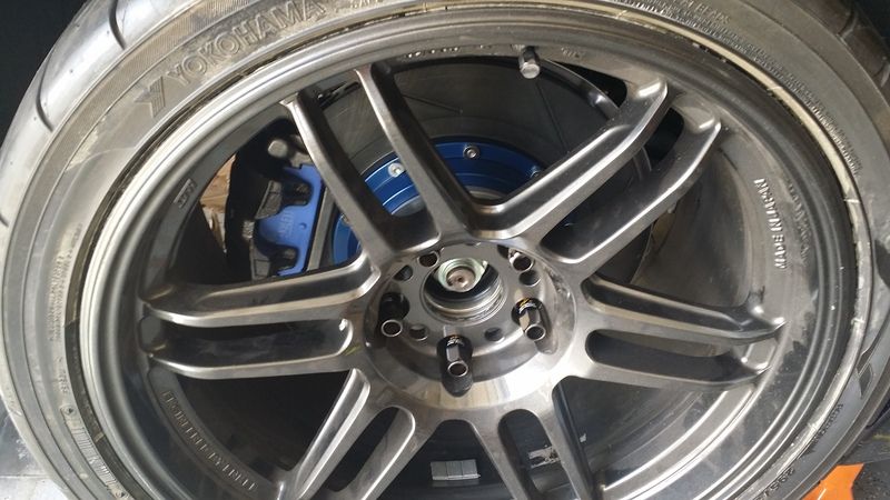

I finished the brakes, bolted up the sway bar (smashing my thumb with the hammer in the process lol), and put the wheels on and dropped each side to torque the axle nuts. I raised the car back up and started taking the wheels off so I could lock the axle nuts in place but I was so sore at that point I decided to quit. I got the speed bleeders yesterday but I'm waiting until I'm over this to do anything more on the car. And I'm not sure how I did it but the ebrake is all out of adjustment, so I need to do that too. It doesn't even grab right now.

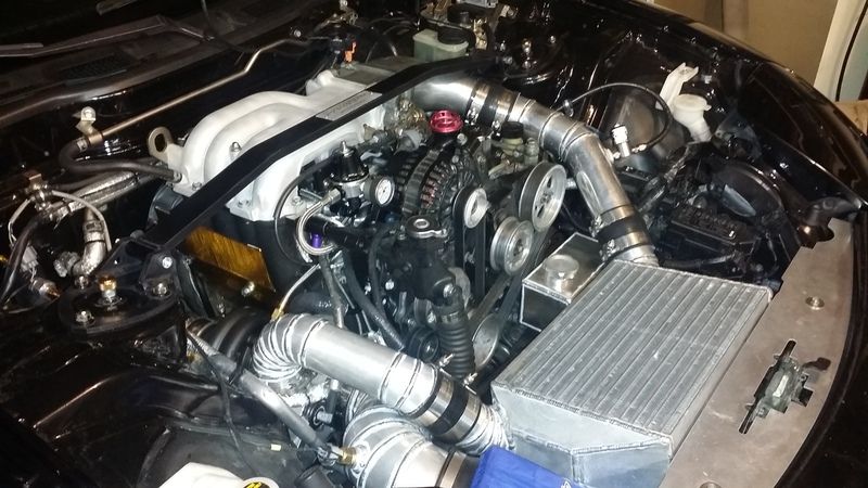

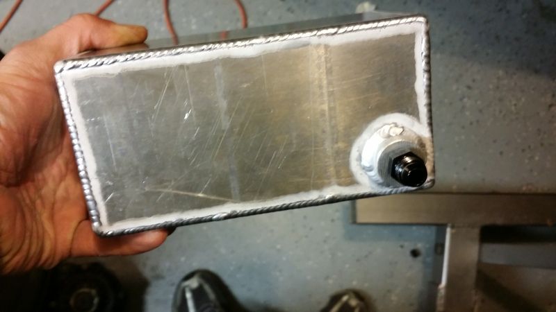

Mitch said he's coming over tomorrow to finish the turbo to IC pipe, and I marked the intake pipe the other night for him to put extra material on there so I can drill and tap them for bungs. I also gave him the stuff for making the OMP tank (the filler came in the other day) so he's going to have everything but the top welded on so I can put the mesh screen in to serve as a baffle.

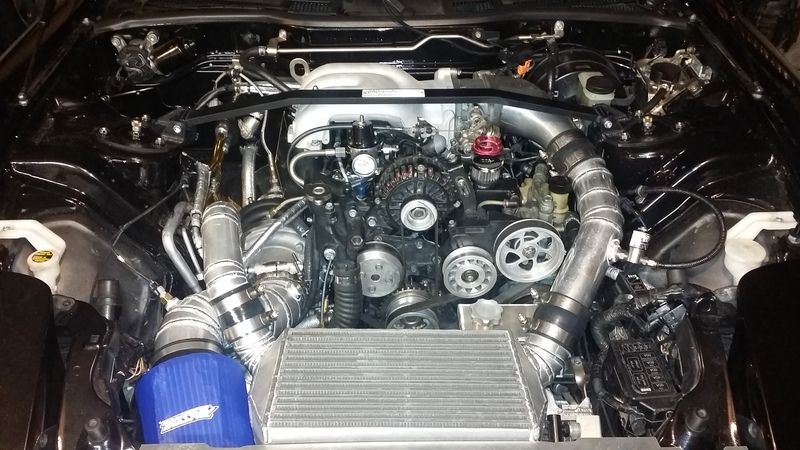

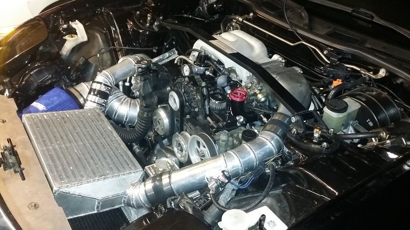

Mitch came over this morning and he finished cutting what we needed for the IC pipe. I think I pissed him off because I was kinda picky, but I want it how I want it haha. After he left I removed all the wheels, installed the front bleeders (I also swapped to a speed bleeder on the slave cylinder, it's the same size as the rear bleeders), and bled the brakes and clutch with the Mityvac. Zico is going to help me tomorrow to make sure they're bled, I'm not sure I trust this new way just yet.

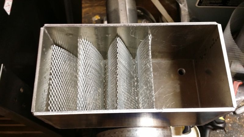

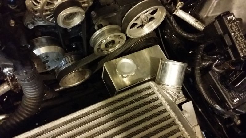

I also cut some of the mesh screen to use as a baffle in the OMP tank and drilled and tapped the hole for the hose. I installed the screen and used water just to see if it would slow that down, because I figure if it will slow down water it will work on oil too. I did notice that it was slower, but I'm still concerned. I'm thinking of tilting it a little to help out some more. What do you guys think? Should I add more mesh too?
And here is what it'll look like in place.

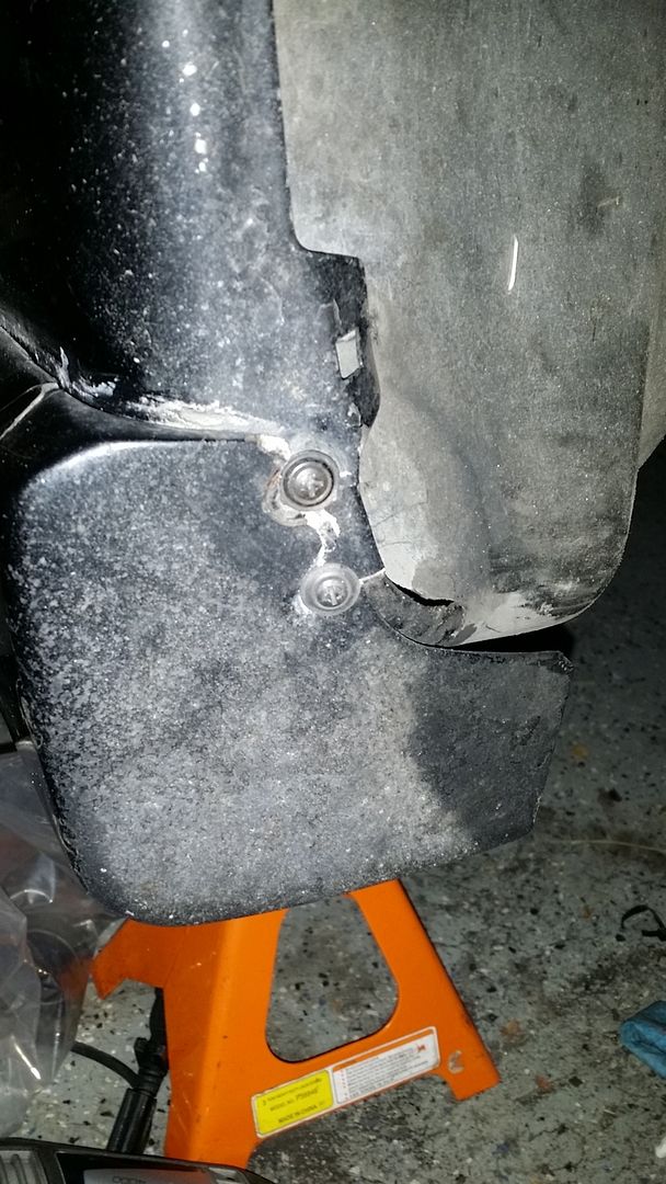

I discovered the other day that the steering alignment is WAY off, so I was showing Zico yesterday and forgot that my passenger side wheel catches the sideskirt and it broke again, so once again I have nothing holding the front of the skirt in place. Really pisses me off.

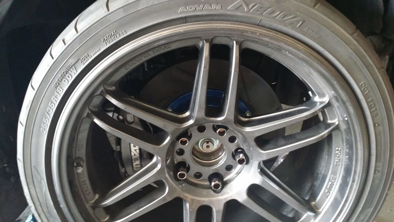

Here's what the brakes look like behind the wheels.

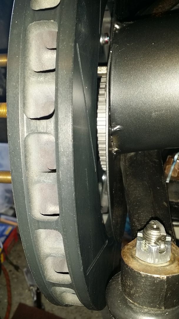

I still need to lock the axle nuts down, but I'm leery about doing the fronts because I'm not sure if I want to do something about the gap between the rotors and ducting plates before I finalize installation. Mitch said he'll have everything welded up and finished for me Monday night. I might actually be able to start the car this coming week.

I asked on facebook to see what people thought about the mesh baffle and no one thought it was a good idea so I talked to Mitch and I'm going to make another cutout tomorrow for him to use to make two baffle plates with a few holes in them, then he'll just tack them in.
I also asked about the brake duct gap and another guy with these said he has a gap too, but he's going to close it up. The gap is almost 8mm and he said Porsche guys try to get within 1mm. I think I can manage that, as long as the spacers don't put the bolt heads too close to the ABS ring. Once I get all that sorted I'll do a final bleed of the brakes, adjust the tie rod ends, install the wheels, then maybe drop the car.

I tried spacing out the duct plates today but it didn't work. Since the duct flange is already pressing against the hub while the plate is flush against the hub, it won't allow any spacing unless you drill the holes out larger or modify the duct flange itself and extend the dent in it that wraps around the part of the knuckle that it's hitting. The only other way is welding a ring onto the face of the plate to extend into the rotor. I'm going to do some testing with the extra pieces I have. So basically there is still the same amount of gap between the rotor and duct plate.

I put the bumper back on today, and I got the OMP tank back from Mitch tonight and drilled and tapped for a larger fitting. This one is 3/8-18 NPT instead of the 1/8-27 NPT and the hole is the same size as it passes through instead of the 1/8 that has a very small opening. That's the only reason I did it.

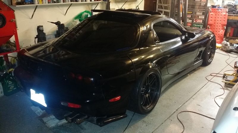

It's all back together and on the ground. I need to raise the car a little because it's practically tucking all the wheels already. I haven't tried again yet to start it either. That's tomorrow I guess. The clearance we had between the intake pipe and ic pipe is gone now and the filter is resting on the radiator and frame, and I had it not touching anything before. Oh well.

How much clearance was there before? Was that during the mock up and the clearance disappeared after final welding? If so, might be able to heat it and flex it back to get your clearance back. Don't know for sure though.

Not a whole lot of space, and maybe we didn't account for the coupler. Yeah we had some space during mock up but it's not too big of a deal. I think this filter still has more room than my last one.

The reason I am in the middle of replacing my radiator is because my intake was barely touching it and ended up gouging an impression into the fins of the radiator causing a leak over time. I mean, it was BARELY touching it but after probably only 300 miles, it rubbed it good enough to ruin my radiator. If it's just touching one of the tanks though and not the fins, you'll probably be fine. I'd hate to see the same crap that happened to mine happen to yours after you've put so much work into it. Re-doing ducting is a PITA... Hopefully I'll be done tonight minus the A/C hoses.

Well the part it's touching isn't a tank nor fins, it's the additional part that the condenser rests on. Both places is resting on are hard surfaces, the only thing that would be damaged is the filter. That's with the intake pipe adjusted to where it's barely touching the IC pipe. I'll post a pic.
