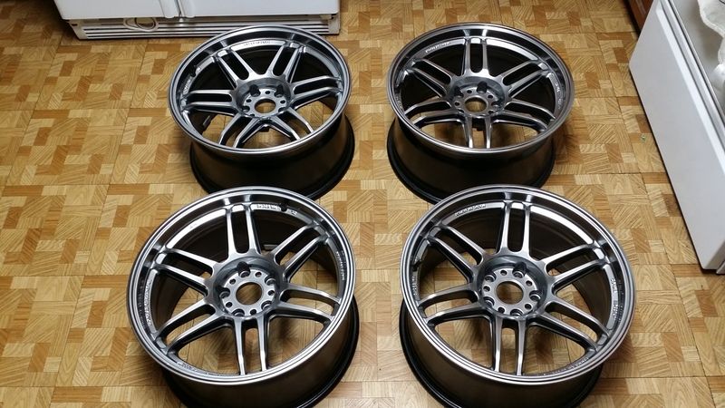

Yeah lol. There are really only two reasons though, because they're the same wheels I have now.
1. They're a square setup, so I'll be able to rotate the wheels when the tires get to that point, and I'll just use spacers to get the final offset I want front and rear.
2. I'm getting them widened to 11.5" all around, and I was concerned that if I sent off my current wheels I wouldn't get them back in time or something would happen to them. It's my luck lol.
I've actually been working on doing a set of custom 3pc wheels based on the TM02 design, and the CAD is already done, but I'm having a hard time finding a machinist to cut them for less than an arm and a leg. Tom is supposed to be getting me contact information to have them cut in China for much cheaper, but I haven't heard anything yet and I want to have wider wheels for this summer.

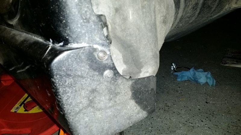

I put the driver's side fender back on and noticed a piece broke off where it mounts at the front so I had to use a washer for now. Hopefully it works.
I put an extra screw in each of the front ends of the side skirts because the passenger side skirt broke right there. This is a temporary fix also until I pull them off and get them repaired the right way. Maybe next year.

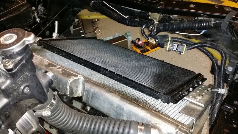

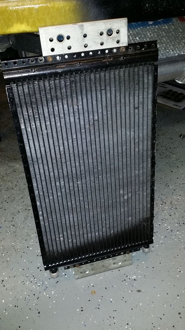

I made the new mount brackets for the condenser to drop it down, but I need to get longer bolts.

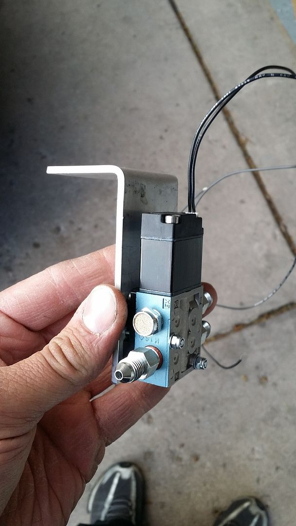

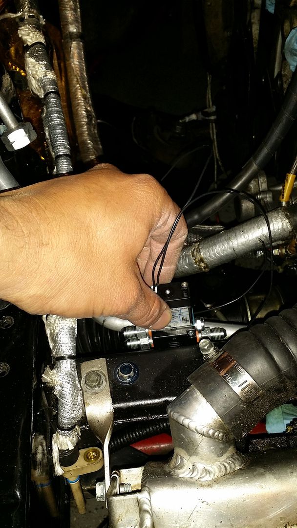

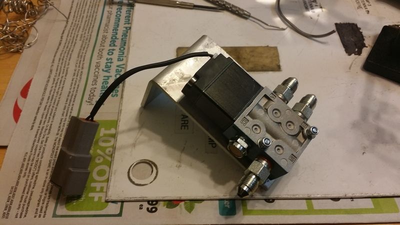

I basically wasted most of the day and only did a couple things. I mounted the MAC valve and finished the new brackets for the condenser, and they didn't drop it all that much after all was said and done. I used rubber insulators again that raised it a bit, and the thickness of the brackets raised it a lot too. I think it's only sitting about another 1/4" lower. I'm planning on making a little splitter for the front of the condenser too so air is forced either up and over the top or under to the radiator. I doubt it will make that much difference, but I might as well. There are holes to mount it to running along the top and bottom of the leading edge lol.
The connector for the valve comes pretty close as it is, so I really only need an adapter, but I told Chris the other day I'd need probably about an extra 6" on the extension. I emailed today to tell him I didn't need the bracket anymore and only needed an adapter, hopefully it catches him in time.

I soldered the connector that Chris sent me onto the valve wiring. It's all hooked up and installed.
