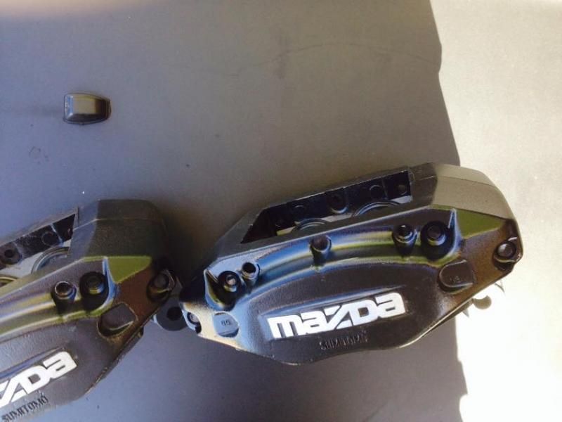

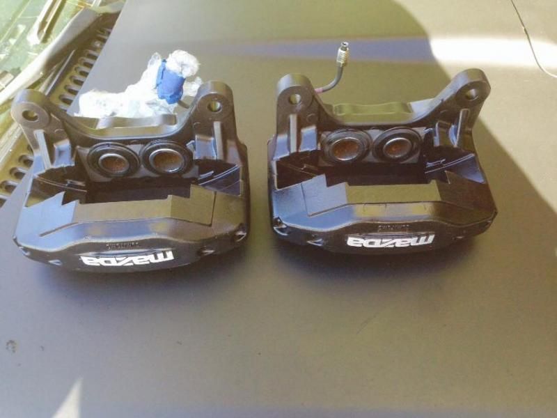

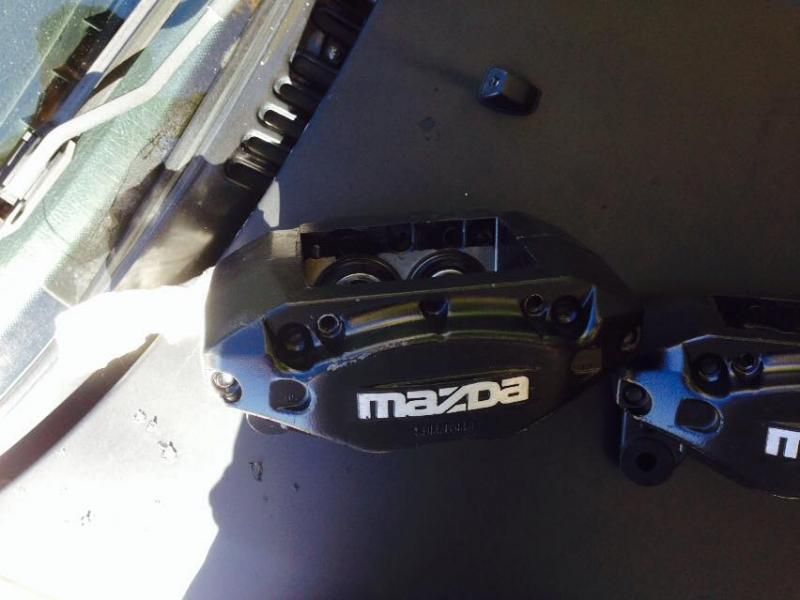

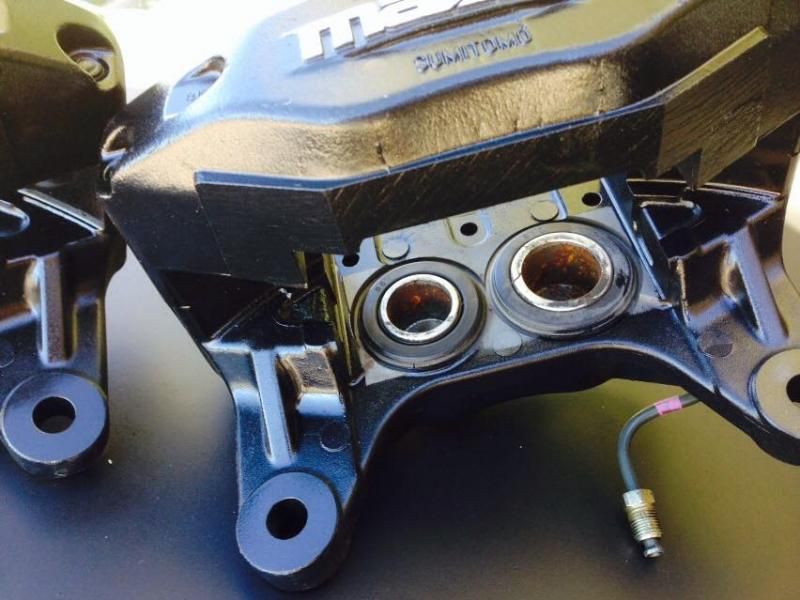

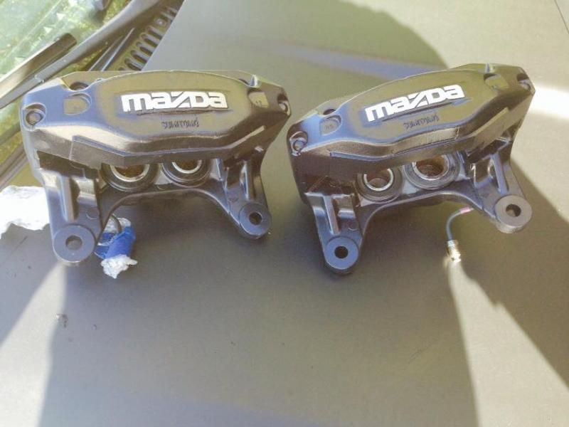

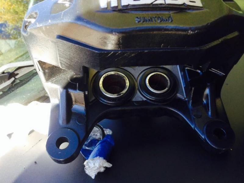

The brakes came in the other day and Zico took some pics. Now all I need to do is buy the rotors and I'll probably replace the wheel bearings all around while I have everything apart. I also thought about putting longer wheel studs in, but I doubt I'll do that.
I'll either get Project Mu rotors like Andy, or the ones from APP Sports. They look exactly the same other than the rotor hats on the PMu are teal and the ones on the APP look more blue, which I like better. The only problem is I can't find replacement rotor rings for the APP but I can for Project Mu, and RHDJapan said the rings for the PMu won't work on APP, even though they look exactly the same.
http://www.rhdjapan.com/project-mu-scr-pro-rotors-front-mazda-fd3s-se3p.html
http://www.rhdjapan.com/app-sports-brake-rotors-set-rear-mazda-rx-7-fd3s-17in.html
And here are the brakes. They look no different than the ones that came on the car, but these are from an RZ which is a later model and although they use the same amount of fluid, you can see that one piston is larger than the other and this changes the way the pads wear. Also, the rotors are larger diameter and thicker on the front to help cooling, and they are larger diameter on the rear. I'm also going to put my cooling duct plates behind the front rotors and run ducting to them. I've also been debating just installing them when I get back, but I think I'll go ahead and rebuild them, and I might get them powdercoated instead of just painting them, and I'll get the rears done too at the same time. I painted them years ago when I rebuilt the calipers but they're pretty beat up at this point.
