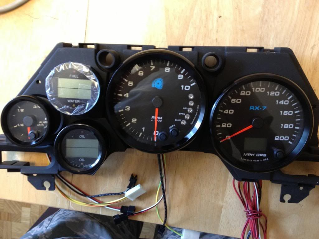

I forgot to update this the other day when I got my gauges. I took some pics but it's too late to post them right now. I'll do it tomorrow. I got the holes in the gauge cluster "skeleton" expanded to fit the new gauges, and they still need to be molded in, but today I noticed that the faces of two of the gauges are off center, so I think I'll be sending those two back to be fixed.

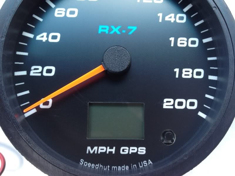

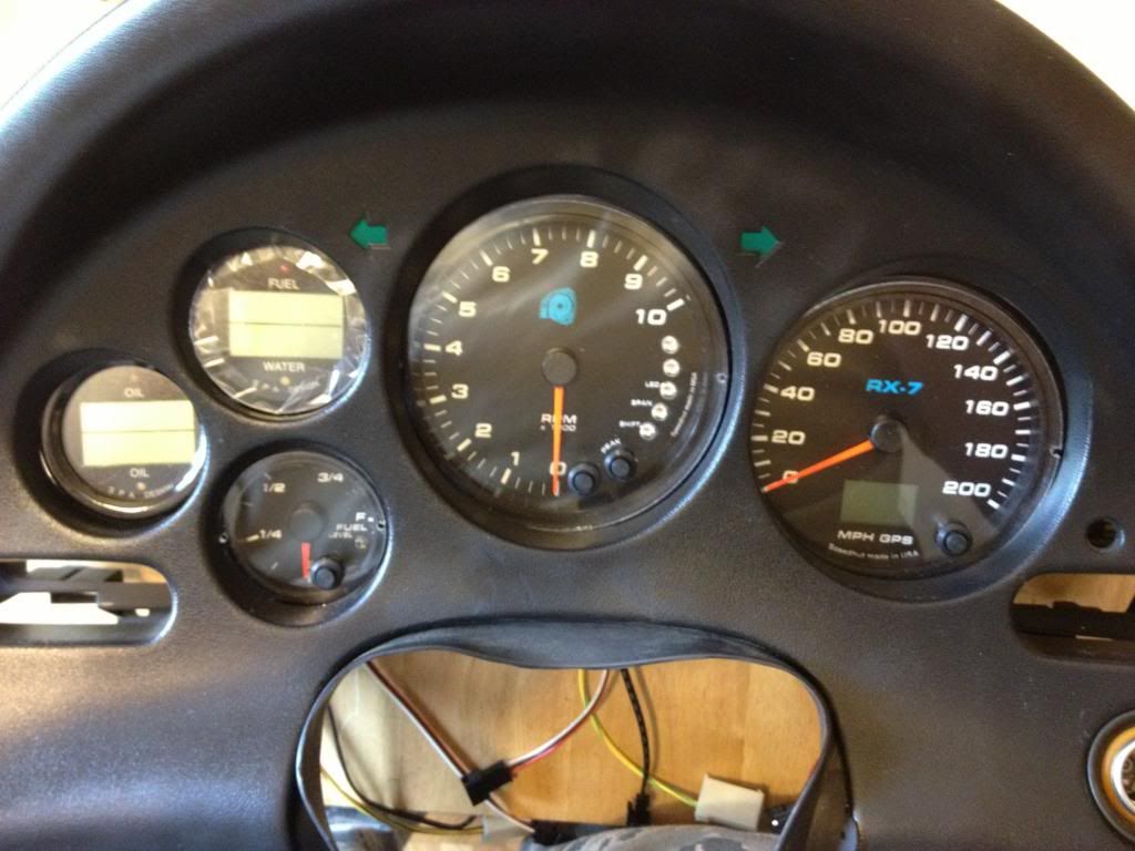

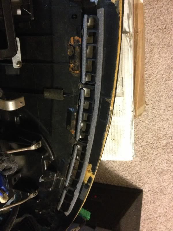

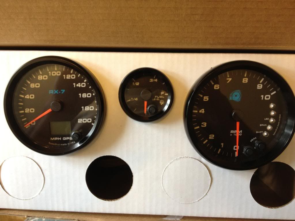

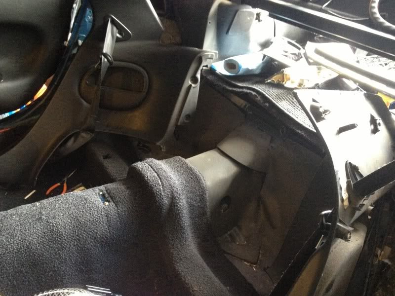

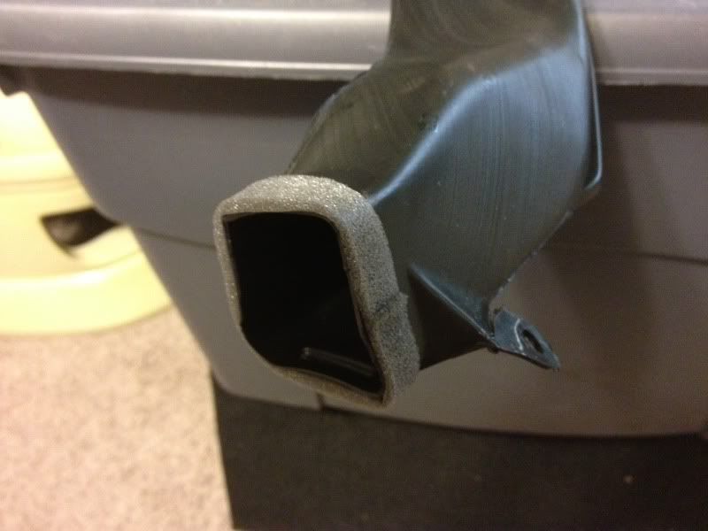

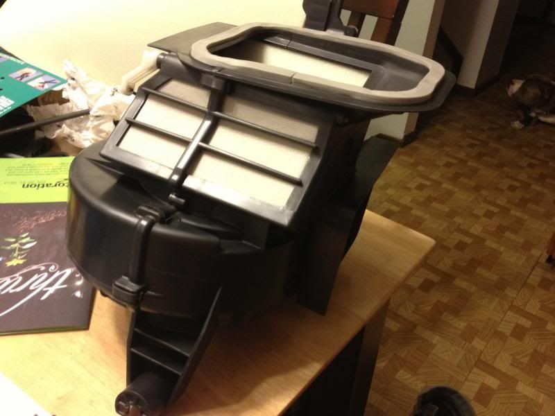

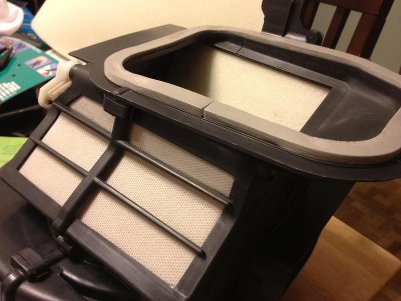

Here are the pics I hadn't posted yet.
Here are the gauges when I first got them and kinda what they'll look like installed...

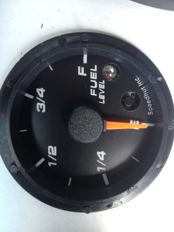

In these two pics you can see how the faces are off center...

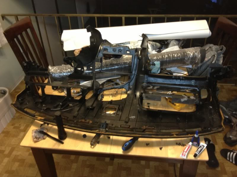

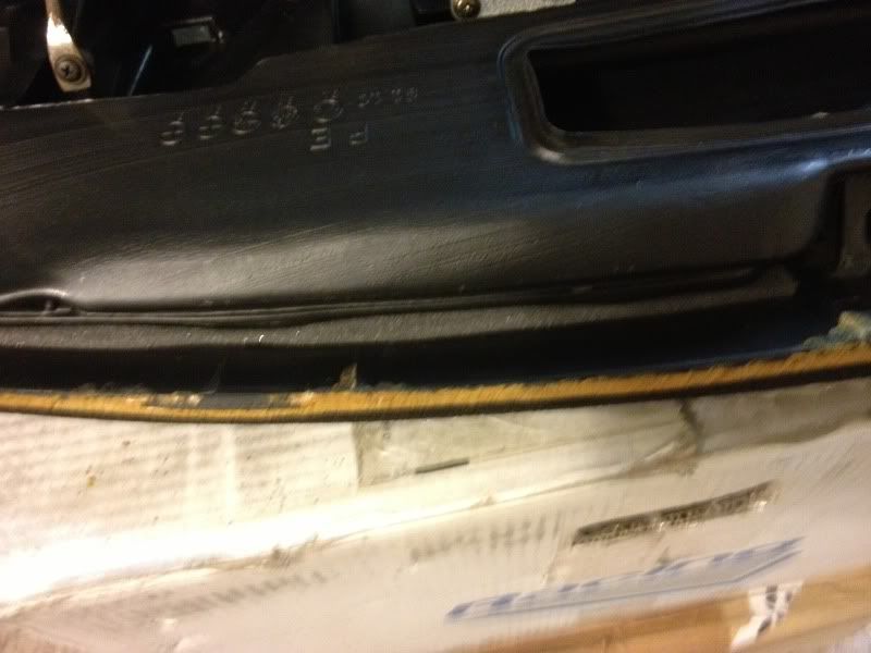

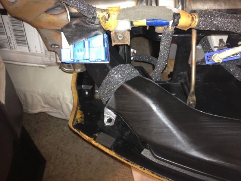

I took the steel structure completely out of the dash to fix all the cracks, some of which then cracked again when I reinstalled the steel lol.

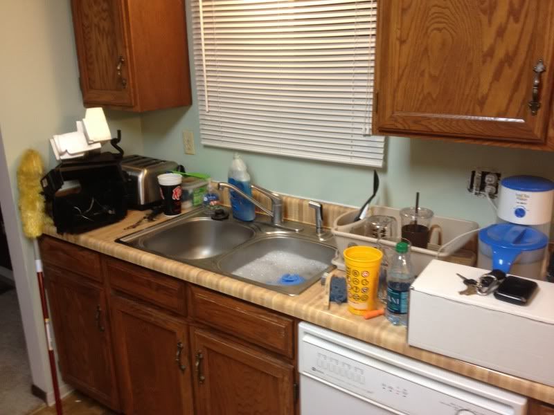

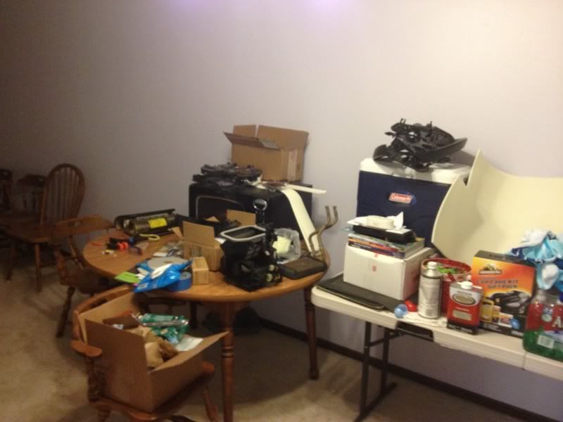

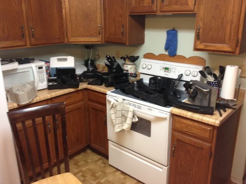

The kitchen has been decluttered a bit since these pics were taken since I'm putting stuff back together, but this is what the kitchen and dining room looked like a few days ago. A wife's DREAM! lol
Removed the rear bins too in preparation for the battery re-relocation...
I thought I took pics of the dash put back together but I guess not. You can see in the third pic how I rewrapped the wiring harness with new foam. And I went a little crazy trying to seal up all the air vents in the dash. I put thin weather stripping around the defrost vents and I sealed the ends of that duct where it connects to go out to the doors...
Postby RX-7 Chris » Fri Aug 02, 2013 9:14
Looks good.
That kitchen is a mess, lol.
Posts: 5365
Postby speedjunkie » Sun Aug 04, 2013 9:14
Correction: The kitchen WAS a mess. Well, it is still a mess, just not as much with car parts lol.
