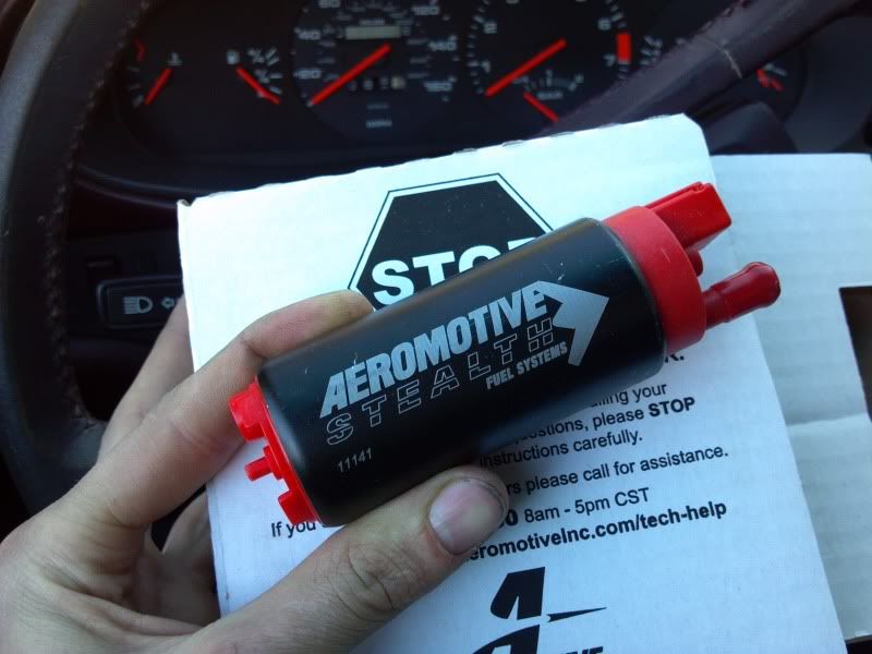

Its been a while sense ive last posted. Car is almost together again, I can see the light at the end of the tunnel. Im waiting on a injector clip (I broke one), CJ motorsports FPR mount and the heatsink for my LC1 wideband. I might be going E85, we will see though haha.
ID1000/2000
Aeromotive FPR
FFE Rails
Lines built by me
and an aeromotive 340

Bulletproof fuel setup there. I have almost the same except different fuel rails and i have 725's for primary

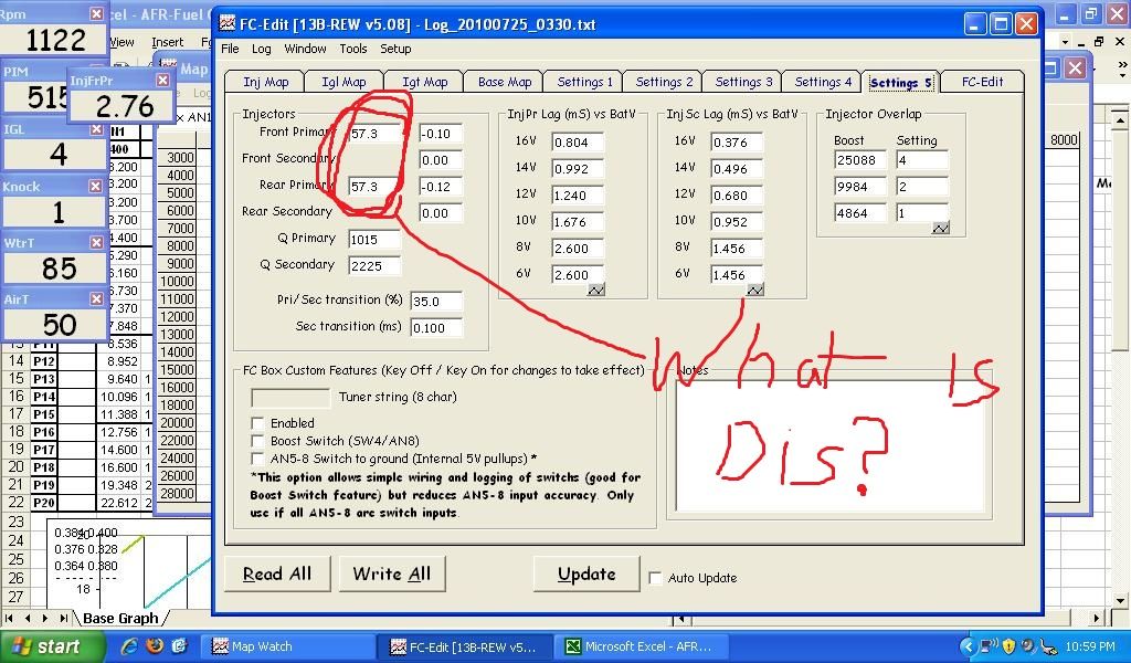

WHAT IS THIS?
JTurton7
Posts: 232
Joined: Mon Nov 21, 2011 9:14
Location: Peterson AFB
Postby JTurton7 » Fri Nov 09, 2012 9:14
From what ive read that is the Injector Pulse Correction Value (primary injector only). So mine should be 550 / 1015 = .5418719 OR 54.2% I guess. Right?
Postby chickenwafer » Fri Nov 09, 2012 9:14
That is the percentage of change from stock injectors (550cc) to what you have now. So yes, you are correct. The numbers to the right are dead time trims which you have a negative number entered, I'm guessing to help with idle? It's just slightly odd because its showing more trim in the rear rotor which you generally want richer (less negative trim or more positive trim) due to the less air flow to the rear rotor from the factory LIM.
It also doesn't look like your primary injector lag time values are setup correctly, you need to input the data from ID in there otherwise the injectors won't fire accurately.
Also, your transition duty cycle percentage is a little low and the transition time is a little quick, which may make transitioning into load with the secondaries abrupt and rich. I run slightly more percentage and just a little slower transition time on all cars I tune.

the picture i posted was just one I found on the internet then modified in paint haha. not my settings 5 page.
I just couldnt find that one part until I read through a PFC Commander user manual.
I changed everything else on that page to match the ID data for 43.5 psi base pressure.
Ahh. Good job then lol.
