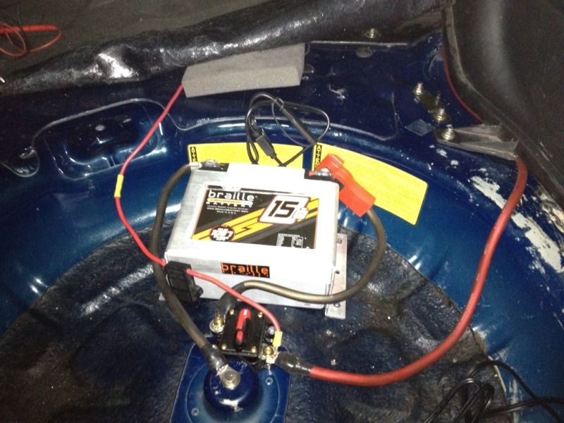

Got the battery and everything installed tonight. I drove around for the first couple hours after work trying to find some 4 gauge terminals with something closer to 5/16" holes but wasn't so lucky, so I just used washers on top of the terminals when I bolted them on.
It's not EXACTLY like Dave's setup...my battery is in a slightly different position lol.
Now I just have to find some plastic or something to use to cover the well so I can put the carpet in and it won't droop. I'm going to put tools and parts back in here too, but that will take up most of the room. I guess I'll start putting the fluids in the rear bins since they won't fit under the cover.

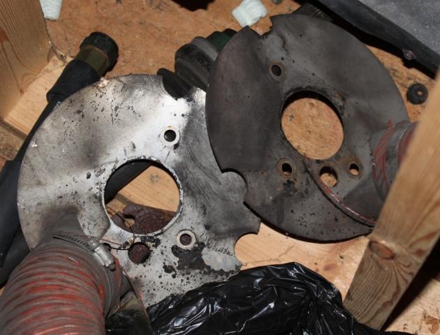

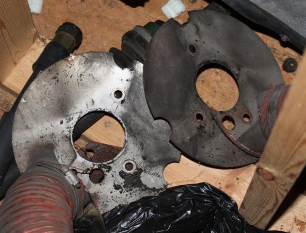

I also just paypal'd Fritz Flynn for some N-Tech brake duct backing plates for the rotors. These are discontinued (I think the company no longer exists actually) and they're extremely hard to find. Later I'll post up the pic he sent me.

OK for some reason Photobucket will not accept my pic of the brake duct backing plates, so I attached it.
