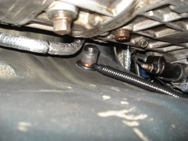

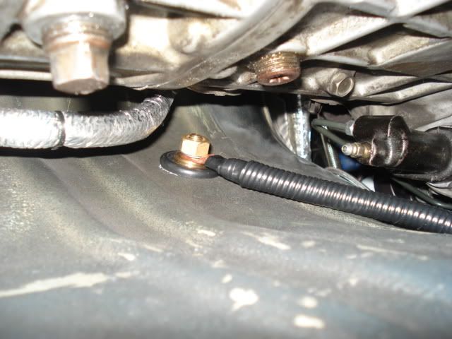

Alright so here are some pics finally. Here is the battery power wire hooked to the bulkhead connector I was talking about before. From under the car looking up...
I put a vacuum cap on it to make sure it doesn't ground out on anything. Not likely, but I like to be safe.

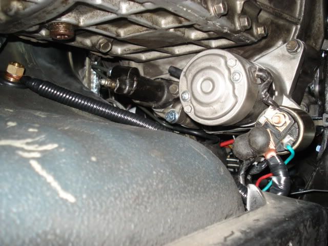

Hooked to the starter...

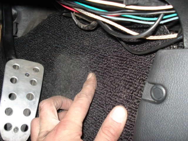

I'm not pulling the carpet back just to show the connector haha, but it's right behind my finger...

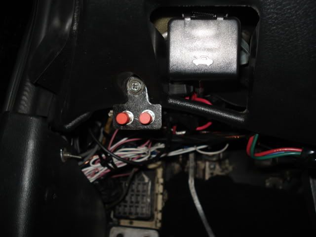

Made this little bracket tonight to hold the buttons for accessing the menu on the SPA gauges. It was hastily done, I like to make it look cleaner but I figure it can barely be seen anyway, if at all...

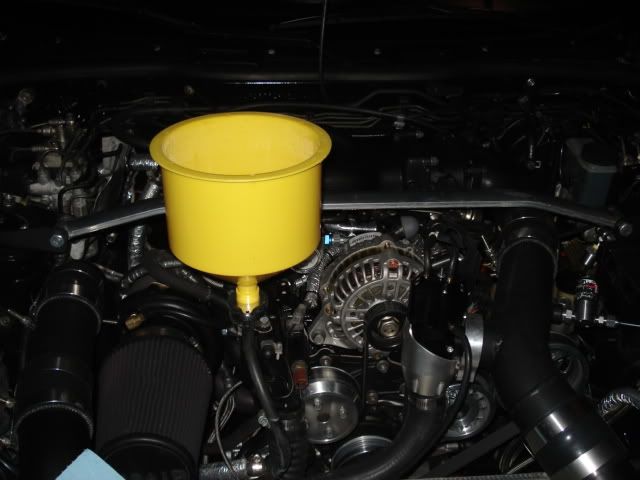

And this is the Lisle funnel I was talking about. I burped the coolant some more tonight, let it run for a while. The gauge was acting funny again today, but I'm thinking there really is something wrong with the sensor or gauge, it read in the negative today LOL.
I also changed the temperature units from C to F. Dave was right LOL.
