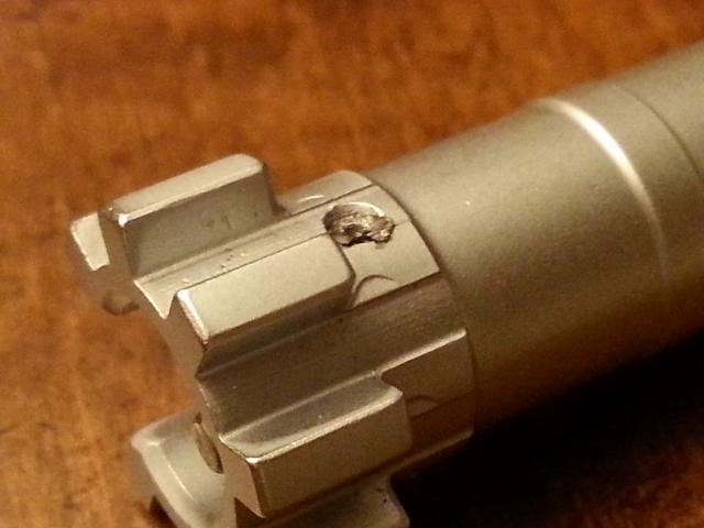

Not everything is welding. Here is a bolt I bought used as part of a complete bolt carrier group. from the looks of things, the roll pin holding the ejector was not seated completely and subsequently run through the lugs of the barrel extension deforming it. To properly check headspace with the gauges I have, the ejector needs to be removed. I broke a #1 punch trying to force it through. This one I am going to take to the professionals (or at least a machinist at work) to get his take. The roll pin will have to be replaced, so a stop at a competent gunsmith will likely occur.
I did use a small jeweler's file and reduced the amount of the burr, but with the broken punch, I was out of commission.
