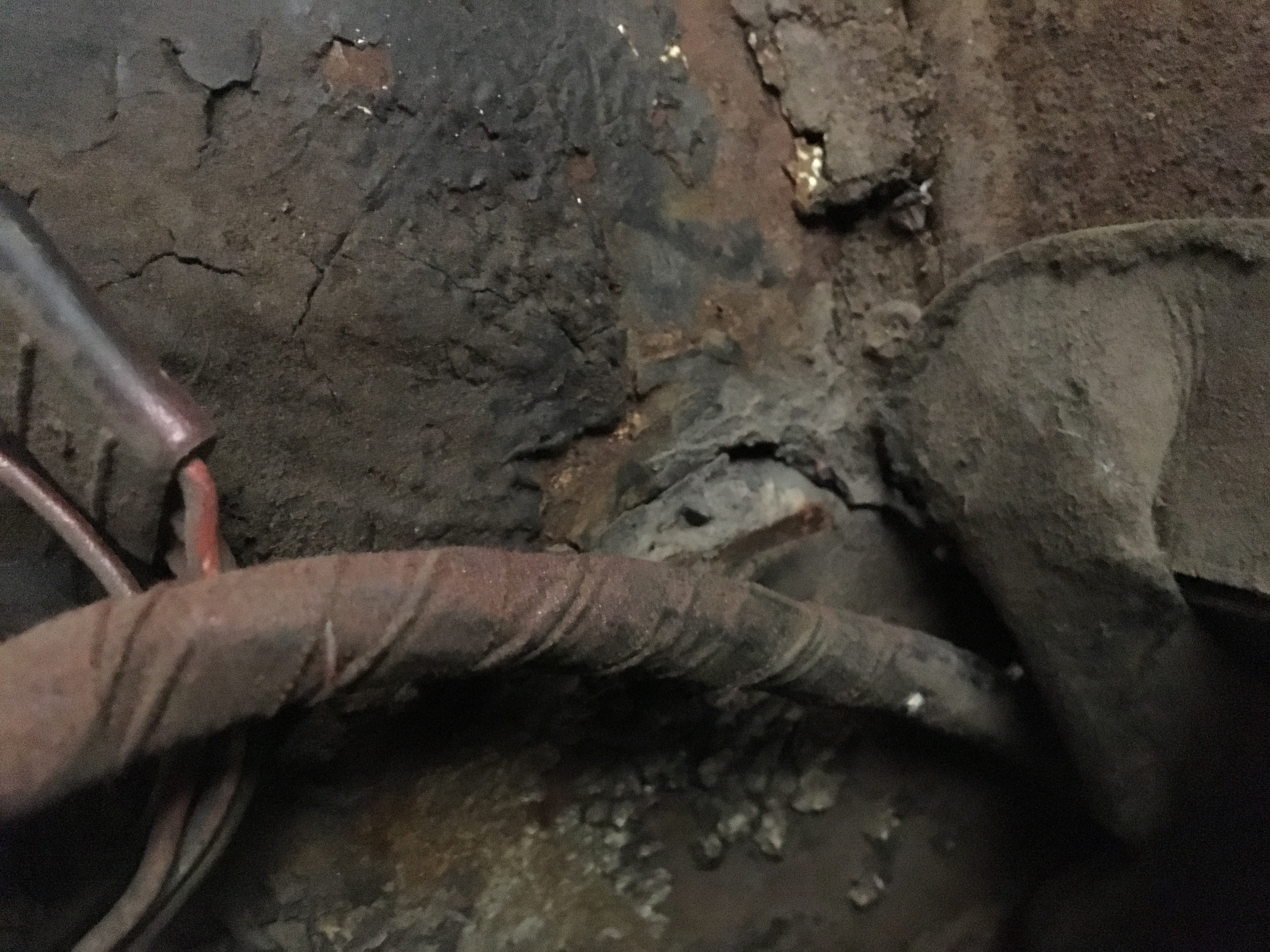

Installed the rear Konis in the Cougar yesterday. I went one full turn from full soft, just to see how it would feel. Unsurprisingly, the shocks made a huge difference. I had installed a metal divider panel between the rear seat and trunk area, so that had to come off to access the tops of the shocks. Overall, a really simple job. These will be easy to adjust as well. Just unbolt the bottom, and collapse to hit the adjustment point. The fronts aren't as easy, since the coils are in the way. I'd like to firm up the front a bit. I did find a bit of rust through in the trunk/wheel well area. I'm not terribly thrilled about that, but it is what it is. It rusted through at the seam.
