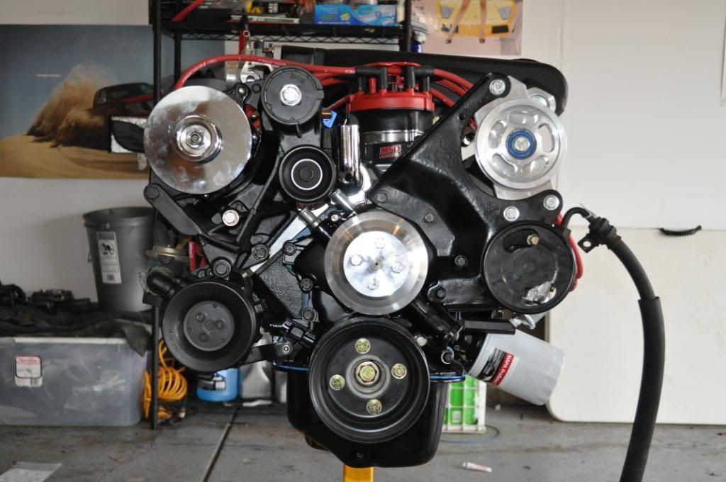

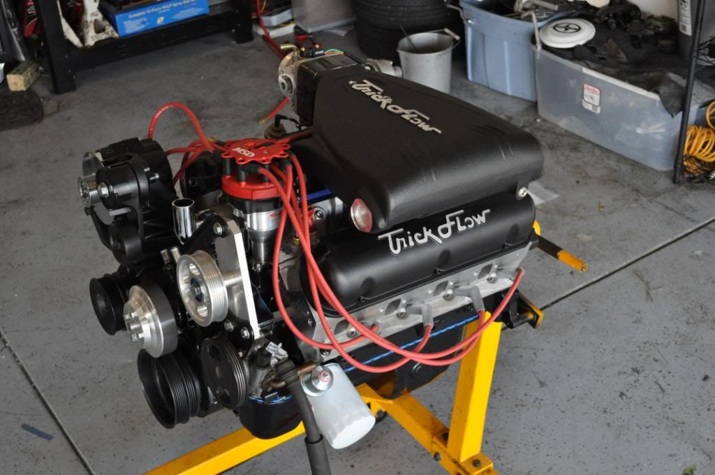

Sorry, for the delay in the response but have been out of town for awhile and busy with work. The K member and all the rest of the Monster Miata kit should be in this week but remains to be seen. I have been mostly buttoning up the motor. Except the power steering, I have the front accessories done, installed the oil pump and new modified oil pan, and installed a few sensors in the motor. The have all the parts for the smog pump but need to figure out how and where everything attaches. I have looked through the Chilton manual but the diagrams a vague.

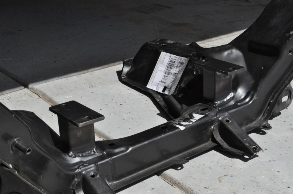

The K-Member came in yesterday along with a few other parts from Summit. I was surprised to see what the modifications to K-Member actually were but makes sense. I will post up some Pic's tomorrow. From Summit I got a bunch of sending units/sensors, 75mm BBK throttle body & EGR Plate, oil pickup tube, oil filter adapter, one piece oil pan gasket, and oil pan hardware. Its all the tiny bits to finish up the motor that will nickel and dime you. There are benefits to starting with a great donor motor, rather than starting from scratch.
This weekend I hope to get the K-member back on, re-install most of the front suspension, and install the sending units on the motor.

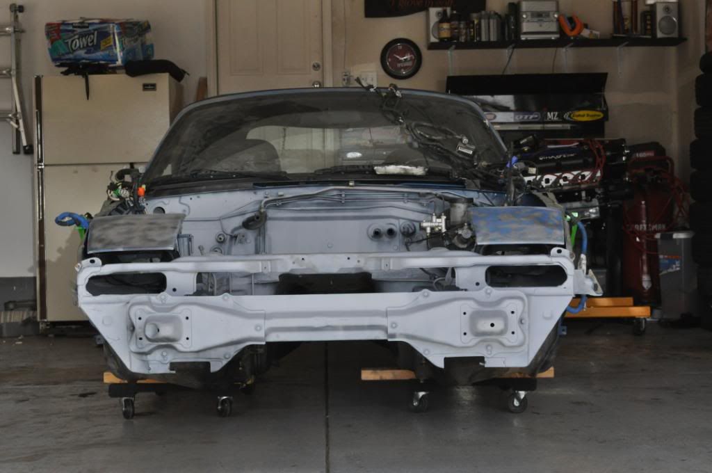

This was the state of the car for the last few weeks. A shell.

The modifications to the K member seem to be the two perches welded on and chunk cut off and re-welded on passenger side. It is kind of hard to see in the pic but if you are looking you can see what was done.

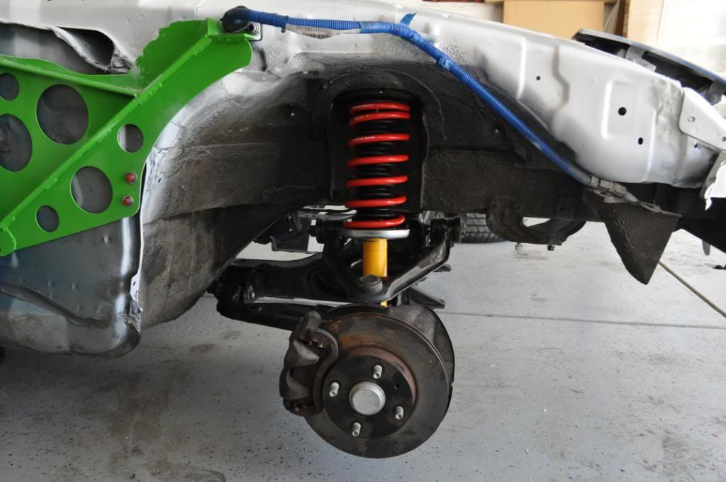

Finally got the bump stops and dust boots in so I could finally assemble the suspension and get the car back on all fours. Motor is almost done, just a few things to button up. Here are some pics.
