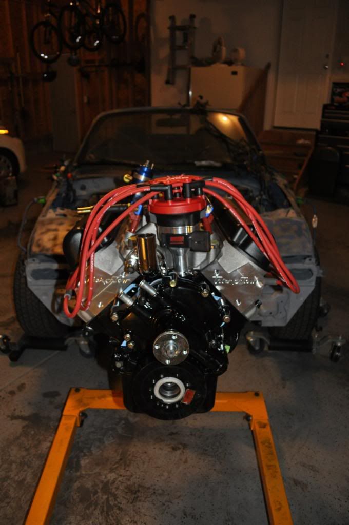

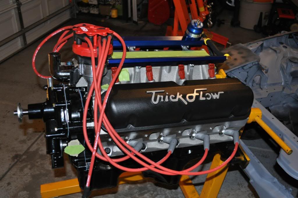

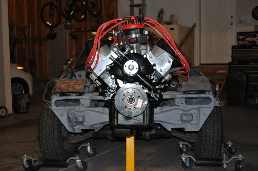

erod550 wrote:Looks like you're making quite a bit of progress. Now that he motor is almost done, can you estimate about how much you will have into just the motor? I have seen built 302 crate motors available for just under $5k but I'm guessing you've spent quite a bit less than that so far.
That's about right but depends on what you are comparing it to. Here is the break out.
1. Used block off of craigslist- $100
2. Machine work- $375(basic work, had more done)
3. 331 stroker kit $1300
-forged crank, rods, pistons, rings & bearings
4. Trick Flow Top End Kit $2500
-Aluminum Heads, Cam, Timing Set, Roller Rockers, Intake Manifold, Upper Plenum, gaskets & Valve covers.
5. Oil pump- $45 (approximately)
6. 30lb Fuel injectors & billet fuel Rails $300
7. ECU off Ebay $75
8. Wiring Harness of Ebay $50
9. 75mm BBK throttle body/EGR $235
10. MSD Pro Billet Distributor $245
11. Ford Racing Wires $45
Right around $5k but all high performance parts and many crate engines do not include a distributor, wires, etc. and you need to figure the labor. I knew what I wanted and how I wanted to build it,plus I learned how to do it myself. I am far from a mechanic but want to learn and I have. I could have built a stout little motor for a lot less. Honestly, I have no idea what this thing is going to crank out. I am hoping for about 400 HP at the crank and 320-330 at the wheels. Once everything is running and broke in, I am considering a 75-100 HP shot of Nitrous due to our elevation. We will see on that, I still need to get my big break kit, roll bar sway bars, racing seats, rims & tires. I still have a long way to go and not enough money. I cant wait.

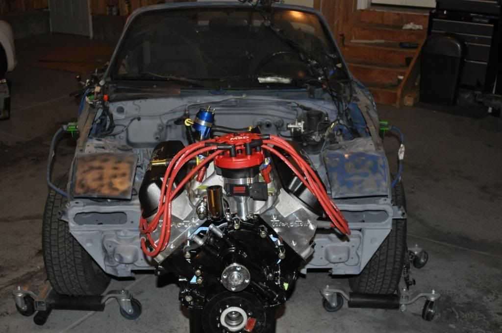

Honestly it really was not that bad. Older single cam, push rod engines are actually fairly simple. There are a ton of books and as long as you have done you homework on the front end, assembly is easy. I was surprised, but i have not started it up yet either. One of my goals with this project was to build a high performance motor that I knew inside and out, so if at any time I want to pull it out of the Miata and put it into another project, I can.

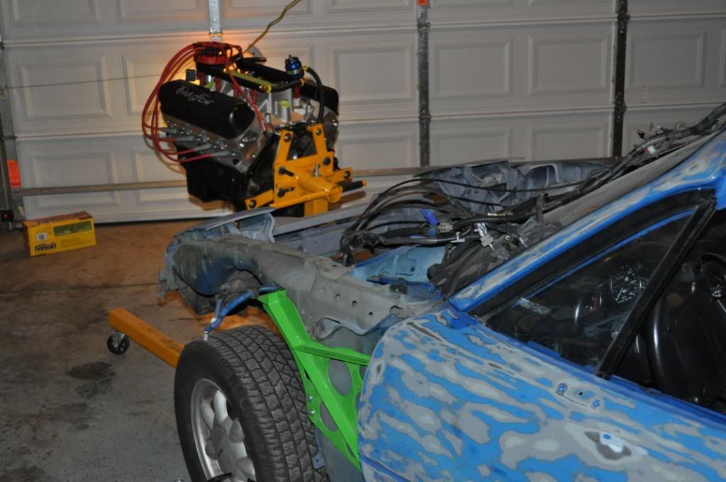

Got a few more parts in the mail and decided to spend the evening in the garage. I got:
1. 90 degree polished water inlet
2. 180 degree performance thermostat
3. Ford Racing 9mm plug wires
4. MSD Pro Billet Distributor designed for the Ford 5.0
5. Boss Frog- Frog Arms

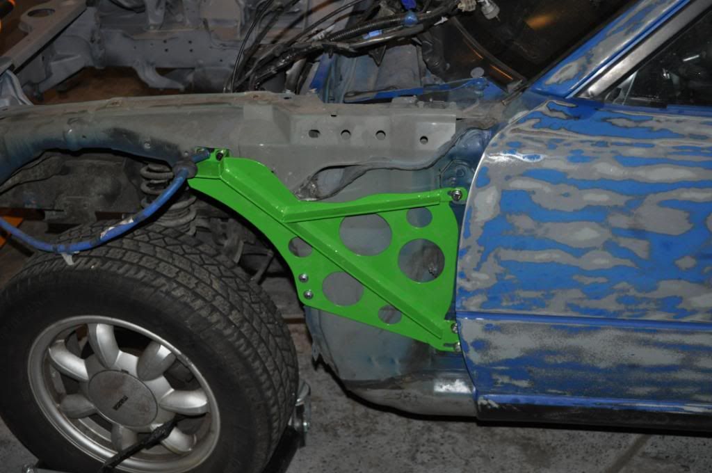

I was really excited about the Frog Arms. I had everything apart and thought that this would be a great time to install these. A lot of guys have really good things to say about these braces. Here is the description from the web.
"Miata "Frog Arm" Braces. What the heck are Frog Arms? They are braces that install underneath the front fender of the Miata and massively reinforce the structure. They bolt directly to the door frame hinges, and through a small port in the fender, near the shock towers. The Frog Arms stiffen the unibody both vertically and laterally, and eliminate many of the rattles and shakes common with older Miatas. What do they do? People who have installed these braces have noticed a significant change in the front end performance. Users also report less bump steer. For everyday street driving, people report less shakes and rattles going over potholes and railroad tracks. Note that the Frog Arms make the front end considerably more stiff, thus they will increase the driving feedback. This will NOT smooth out the ride of the car. The front sway bars will work much more effectively, and the handling around tight corners will be noticeably changed with the reduce body flex."
This weekend I will be install the most of the front accessories. I got all the brackets, hardware, light weight aluminum under drive pulley kit, alternator and tensioner. The only thing I need to find is an air pump "smog pump" and ac unit. I still don't understand what purpose the air pump serves but know I need it to pass emissions.

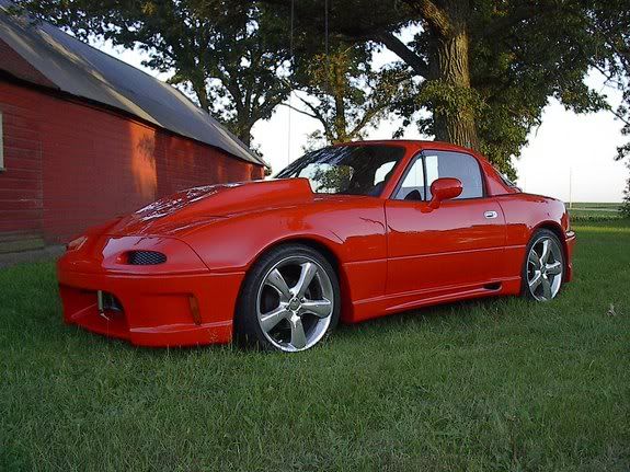

Here is another example. This is a picture of another Monster Miata build that is a 1st Gen, with the exact body kit I have (minus the hood) and has 17" rims. Again I feel that fits the car and the style I am after.
