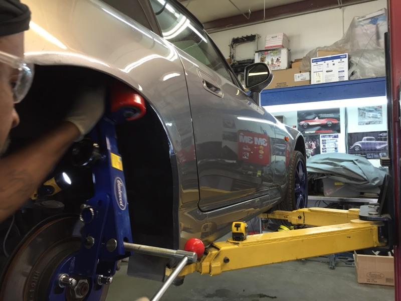

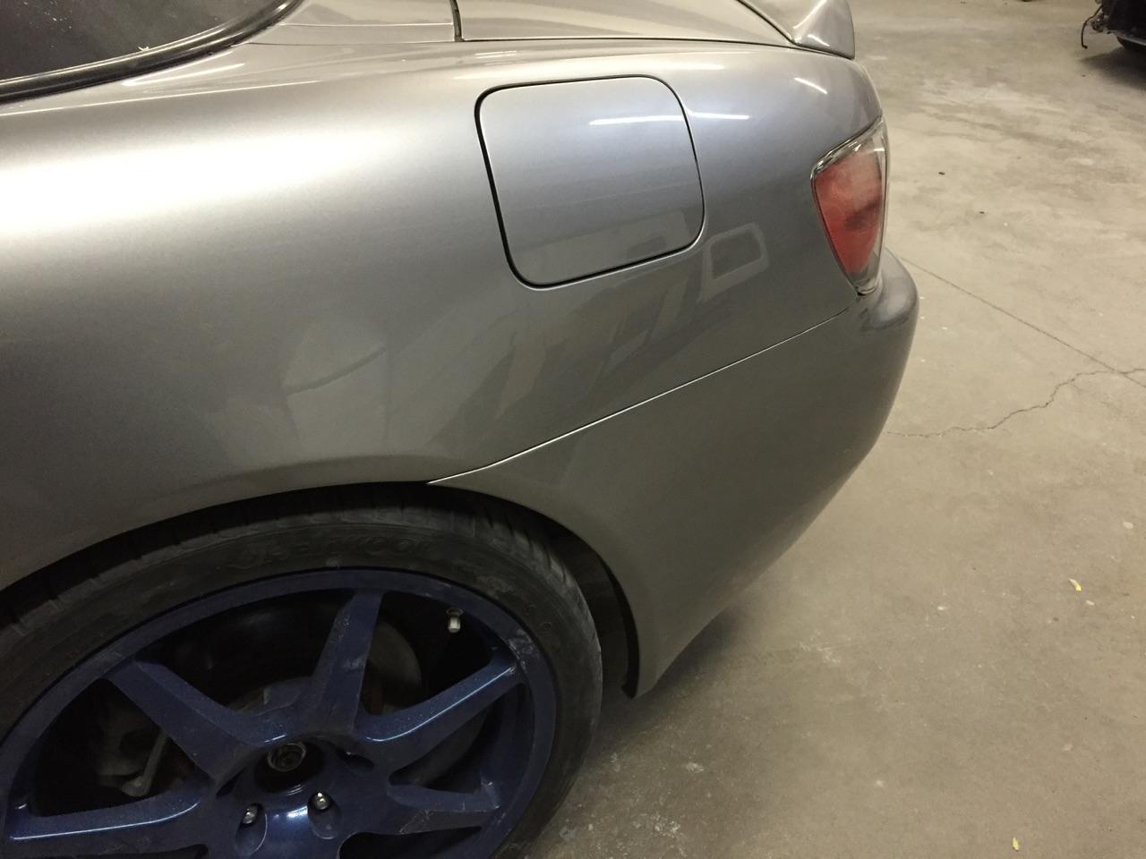

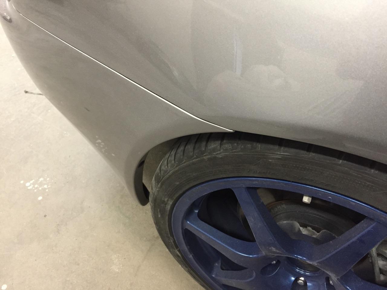

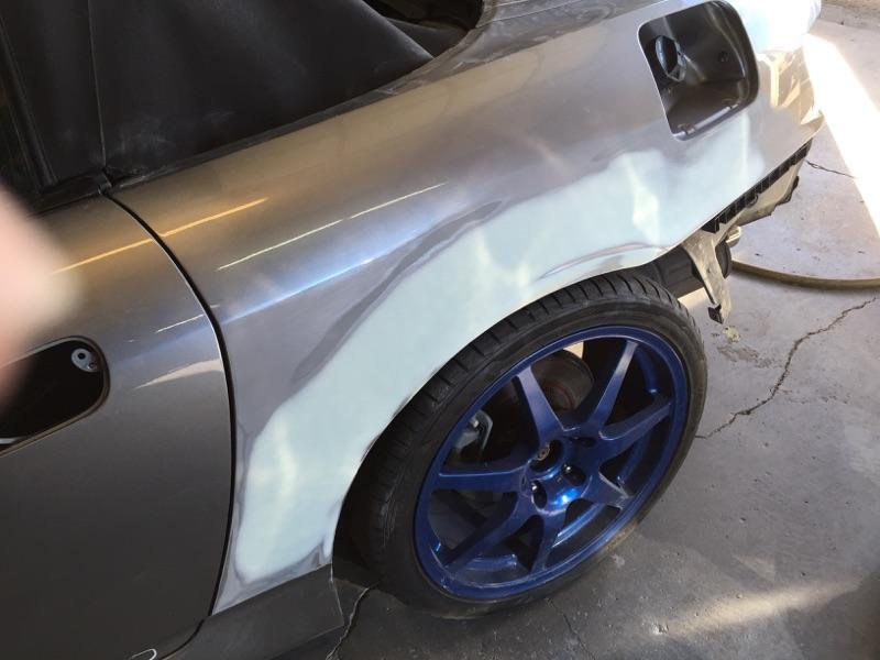

Postby Shadowden » Wed Nov 02, 2016 9:14

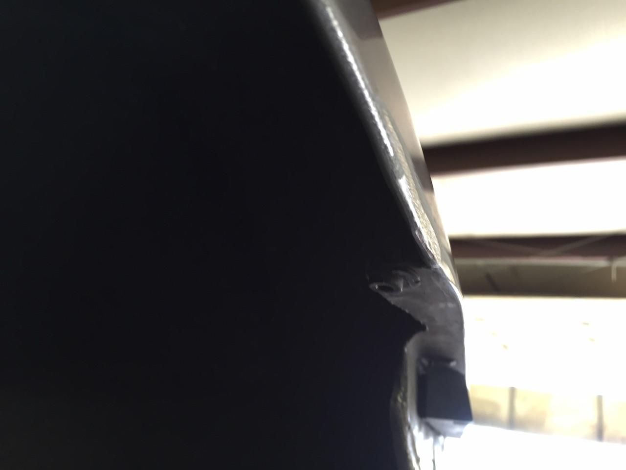

Yeah. Really didn't want to. But this way, the tires will no longer rub on the fender tab and the roll will be complete and the fenders will be back to stock appearance on the outside. They were slightly pulled at the bumper before and it bugged me. This shop won't roll fenders without doing a paint process due to paint cracking. I had looked into it before and was just putting it off thinking that I will eventually do a complete color change and potentially go widebody. Getting rear ended accelerated everything because they were already in the back doing other work, so wanted it all done at the same time.
I doubt I will ever go wide body (unless someone drops an asm or spoon widebody in my lap) or color change at this point. Sort of frustrating since I am not too geeked with the paint condition of my hood either from when the dog walked on it.

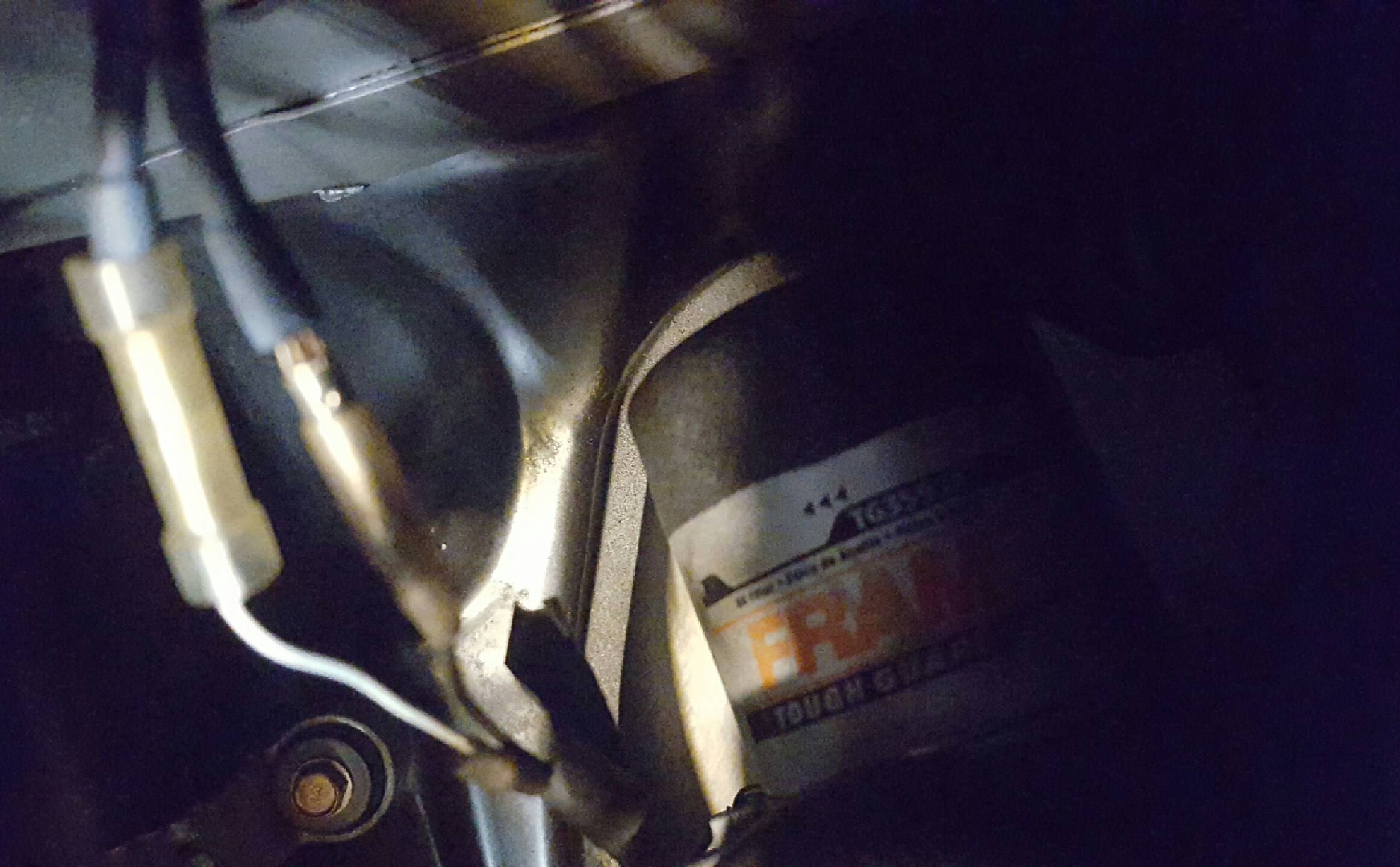

2.) My secondary oil temperature gauge (actually reads a temperature instead of just illuminating bars) started acting erratically last night as well. It came up to normal operating temperature then would bounce around. I looked under the hood to see if the wiring connections were in good shape. I noticed that one connector looked to only have a few wire strands in it and suspected that was the problem. I pulled that connector and bought a new one this morning. The wires looked a little corroded, but not horrible, so I'm leaning toward that not being the problem, but I will get it cleaned up. I also noticed the protective cover from this wire was missing.
I did just speak with the manufacturer and they suggested some simple trouble shooting. Disconnect the gauge from the sensor (done) and see if the needle pegs out at the highest temperature (300 deg I think). If so, then the gauge is fine and it is likely a sensor issue. New sensor is $15.00. So I can knock that out this evening.

Yeah, two simple problems, one of which could easily be remedied by a new, higher quality gauge/sensor. But, upon testing and further conferring with prosport, I ordered a new sensor on Thursday and it arrived today.

I did an oil change yesterday and replaced the sensor for my oil temp gauge. I haven't driven the car yet to verify it is the solution, but the sensor that was in there essentially fell apart when I removed it. Based on that, I'm hopeful that another simple problems is resolved.

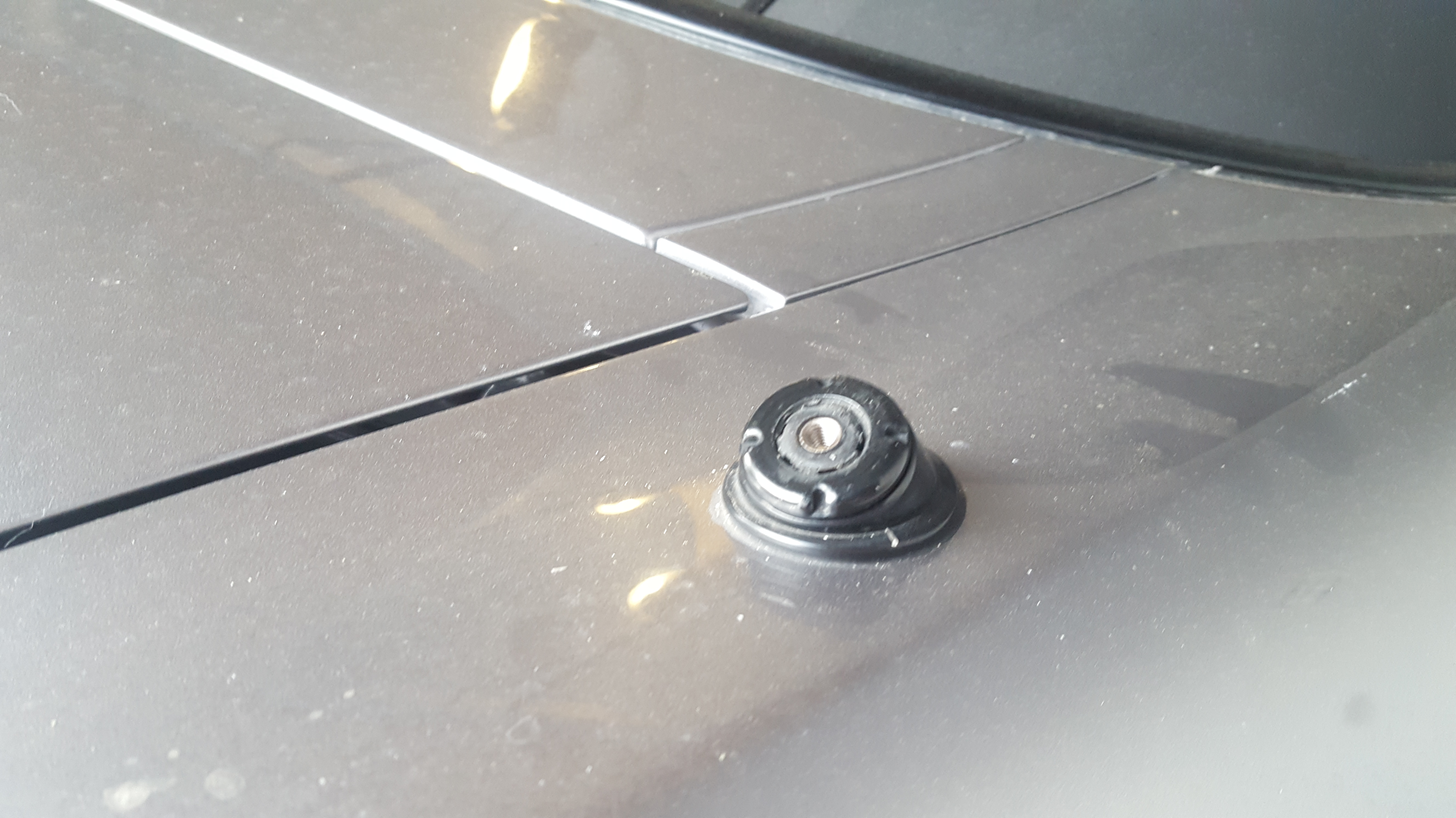

Undertook another massive DIY project: remove and replace radio antenna. While my car was in autobody, it was brought to my attention that a previous owner must have broken the stock antenna and replaced it with a non stock base and antenna. The base was replaced under insurance, but they did not replace the antenna. An antenna was ordered and it arrived from Japan in a timely fashion. Unfortunately, my car was back in autobody to have some issues resolved that I was not happy with. Now with my car back, I could dig into this project. Pictures for guidance.
With non-oem antenna removed, verify hole is threaded:
Align threaded post on oem antenna with hole:
Thread in using a clockwise twisting motion being sure that the post of the antenna remains parallel to the antenna base.
I lost all of the time lapse footage for this DIY, but hope the pictures are helpful. :4e40f5b5:
