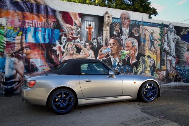

I haven't done much to my car. I think the big task for this winter will be to search down all the vibrations in the convertible top and get them quieted down.
I have really enjoyed driving the car though I prefer top down. This is definitely the time of year for it.
I don't foresee a lot of changes in the future. I would like to finish the exhaust system with a PLM header and a high flow catalytic converter. At that time, I'd also like to start running an AEM EMS for it. This would allow a little better tuning and lowering of vtec for smoother engagement and a little more power under the curve.
