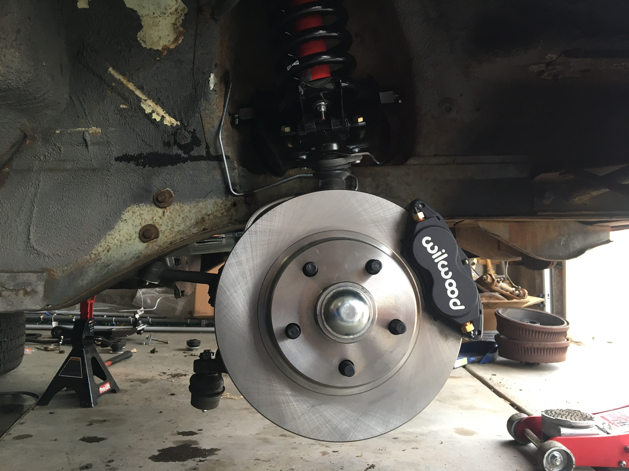

It went well! Now I need to do the master cylinder, pushrod, and strut rods.
- Attachments
- IMG_1988.JPG (733.73 KiB) Viewed 10844 times
- IMG_1987.JPG (705.87 KiB) Viewed 10844 times
Re: 1967 Mercury Cougar
looks good
