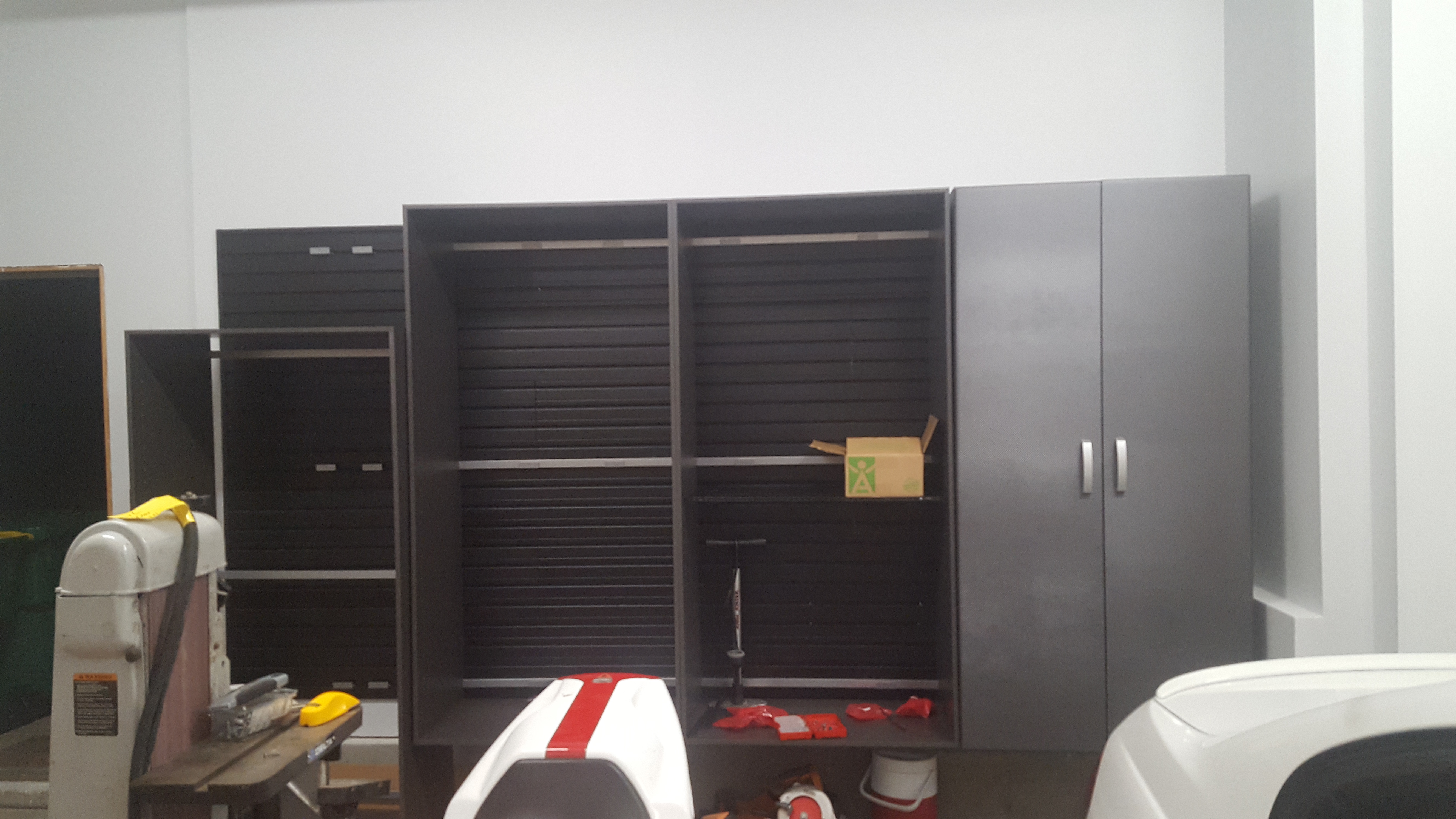

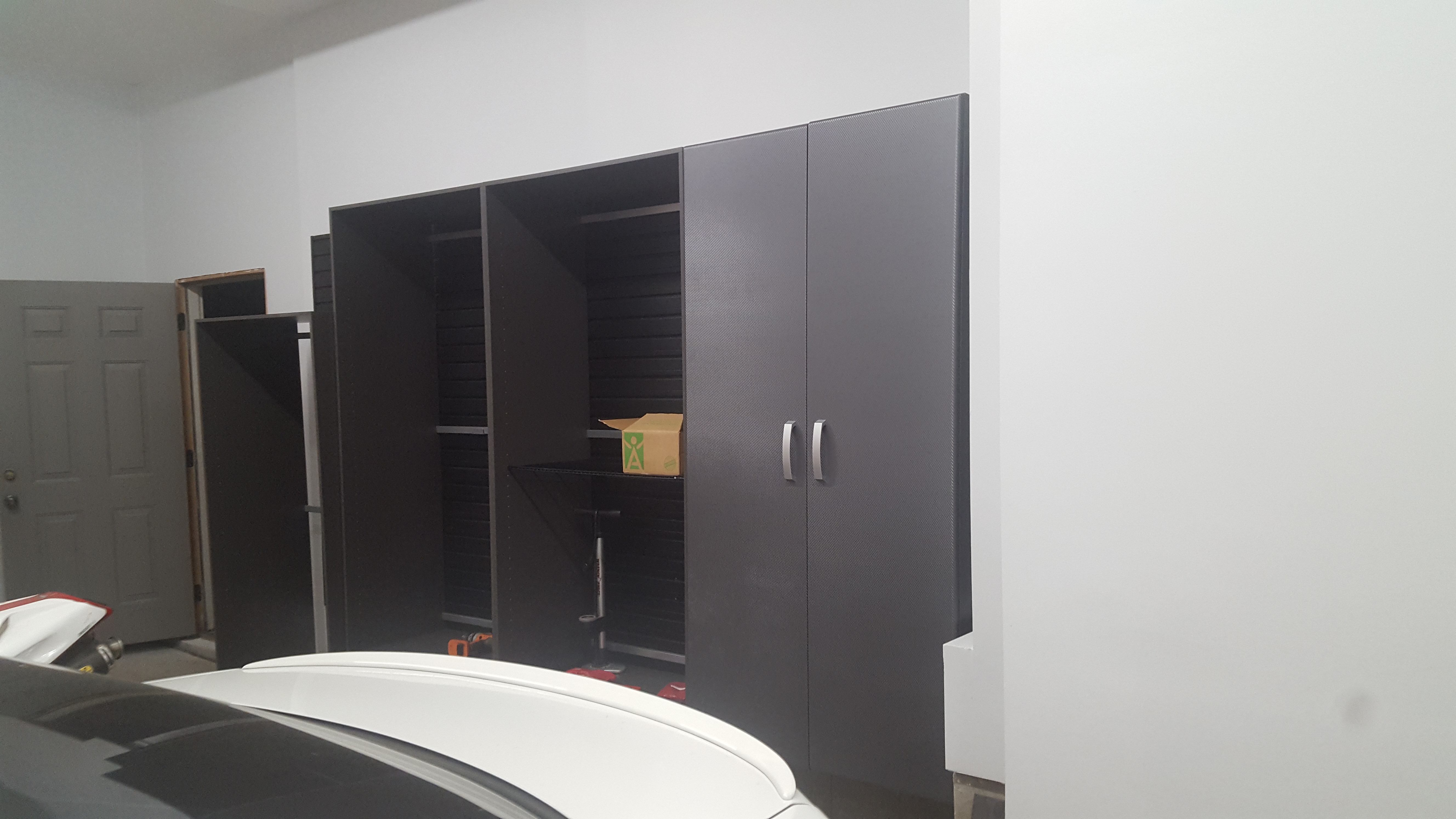

DWDUC came up and helped me get some of the panels onto the wall for the cabinet system. The tolerances are tight on the brackets used to hang the cabinet bodies, so working through some issues with that since the wall isn't nearly flat enough. I have hung 2 cabinet bodies and a single door. I'll hopefully get a second door and 3rd cabinet body up tonight. Will get a picture or two if so.

Postby Shadowden » Thu Aug 17, 2017 9:14
Not the best pictures, but moving along on the cabinet install.
Re: The Making of a garage
Postby RX-7 Chris » Fri Aug 18, 2017 9:14
Those look good. I need to get some nice cabinets someday.

This cabinets look good. Great job planning this out and taking your time. I'm not patient, and as a result, don't love the mishmash I have going on in the garage right now. I'll get there eventually.

Looked at it yesterday as I was looting your garage for tools. Looks really good! That is going to create so much use-able space for you.
