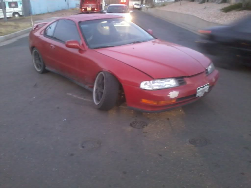

Oooh, is that a ball joint failure? Er, sorry, I mean, that sucks man. Seriously no fun, whatever the cause. I have bad dreams about those, probably because something like that actually happened to me in a 93 Ford Festiva in that took a side impact to the left front wheel in Boston I think in '00. Paid someone's mechanic friend to put it back together because I was young and stupid and didn't realize it'd've been best just make an insurance claim. Apparently it needed a ball joint replaced. About a year after that, that corner started clunking occasionally on turns.
I didn't recognize it for what it was, ball joint failure, and continued driving it. One day, after driving down a state highway with only a yellow line median past lots of head-on traffic, I turned right into the industrial park where I worked. As I cut left to turn into work's parking lot, the front left wheel knuckle separated from the rest of the suspension, turned the wheel about 70 degrees leftwards out of the wheel well. This kinda "worked out" as the wheel actually braked the car to a halt from 20 mph and held the chassis off the ground throughout. (Being in a small PA town, the guy at the local Exxon garage put the suspension back together, reconnected the CV, and it was back on the road for $75. He suggested I bring it back to him for future work, but I never had the chance, due to a viscous rear-ending in oct'01.)
More recently, in this Honda Civic, a couple of things stacked up. The civic had been given bridgestone blizzaks on the front two tires in maybe early Nov'08 in the middle of a snow storm that blew in suddenly while I was down in Centennial. I never got an alignment, and it seems it was pretty far out of spec because by late March'09 when this happened, the center tread was very low even as the outer corners were OK. On a day I normally would have stayed home, I drove through the rain and slush because of a dentist appointment.
About a block from the destination, the road was a mix of rain and slush. It was basically just what most of a PA winter is like. Up ahead, traffic slowed suddenly, and on this downhill stretch of Yosemite between County Line and Dry Creek, I tried to slow but slid. On a clear road, I'd've just steered left and gunned it in a low gear, but with traffic slowing ahead, I had no room to maneuver and watched helplessly as the vehicle slid in seeming slow motion to the right... not just into a cement curb but exactly into a rain gutter, which caught the wheel. When I said above that the Honda was reliable, I was obviously failing to mention that I did *this* to my car, but I don't blame the civic, it was the product of my own pattern of neglect, a wake up call I suppose you could say. Neglecting a car leads to many "perfect storm" multiple-causal failures that are sometimes less apparent until they hit you at the worst possible moment, as I've learned.
Insured declared it totaled, high miles, I think the payout was about $1500. I kept the car and looked for alternatives to letting the wreckers scrap it. (Someone there tried to lift the rear emblem but only managed to snap off the "CI" of "CIVIC". The three screws that held in the rear hatch lock mechanism were missing, too. The shop denied all responsibility, but I'm not stupid. Shady. Anyway, I wasn't going to let someone there have it for $400 or whatever...)
After that, I had the vehicle moved and taken to Foreign Automotive (formerly: Honda Menders) where they pretty much replaced the entire front right suspension, which had taken the brunt of the damage. Apparently the guy who worked on it knew exactly where I lived up here in Clear Creek from my address because he lived three houses down the road up until recently. He did a good job.
What was actually awesome about this was that it corrected a problem I inherited from the original owner: the right wheelbase was 1" shorter than the left as a result of them driving it into a ditch when evading a deer back in PA when the car was brand new. It had always pulled ever so slightly to the right until this accident's fix-up. Now it steers true and aligns better than at any prior point of my ownership! (As a footnote: Foreign Automotive has apparently been distancing themselves from Honda, sounds like they are more interested in Suburu these days, and they no longer service Hondas. Might have been a change in resident mechanics, dunno.)
Tire wear was also much improved. After that I got a new set of tires, and I'm still on two of them today, which is impressive considering they are winter M+Ss. Though unrelated to alignment, one did go from OK to no sidewall in the space of about 6 seconds while on CO-470 in '10, unworking some of the diligent pro rebuild from the '09 accident, prompting this current round of work today. (That one was probably a close thing, being in traffic. As I rolled to a stop on the side, the tread, sans all sidewall, rolled past and down toward Chatfield Reservoir. Had this civic been lowered, something not meant to might have caught asphalt at speed, but as it was, even the wheel wound up surviving OK.) So May'10 I replaced that tire as a pair. Had to get the head gasket done a month later, had no budget for new tires, and they're still on and OK winters still in the rotation with OK tread despite autocrossing on them in Dec last year. :)
