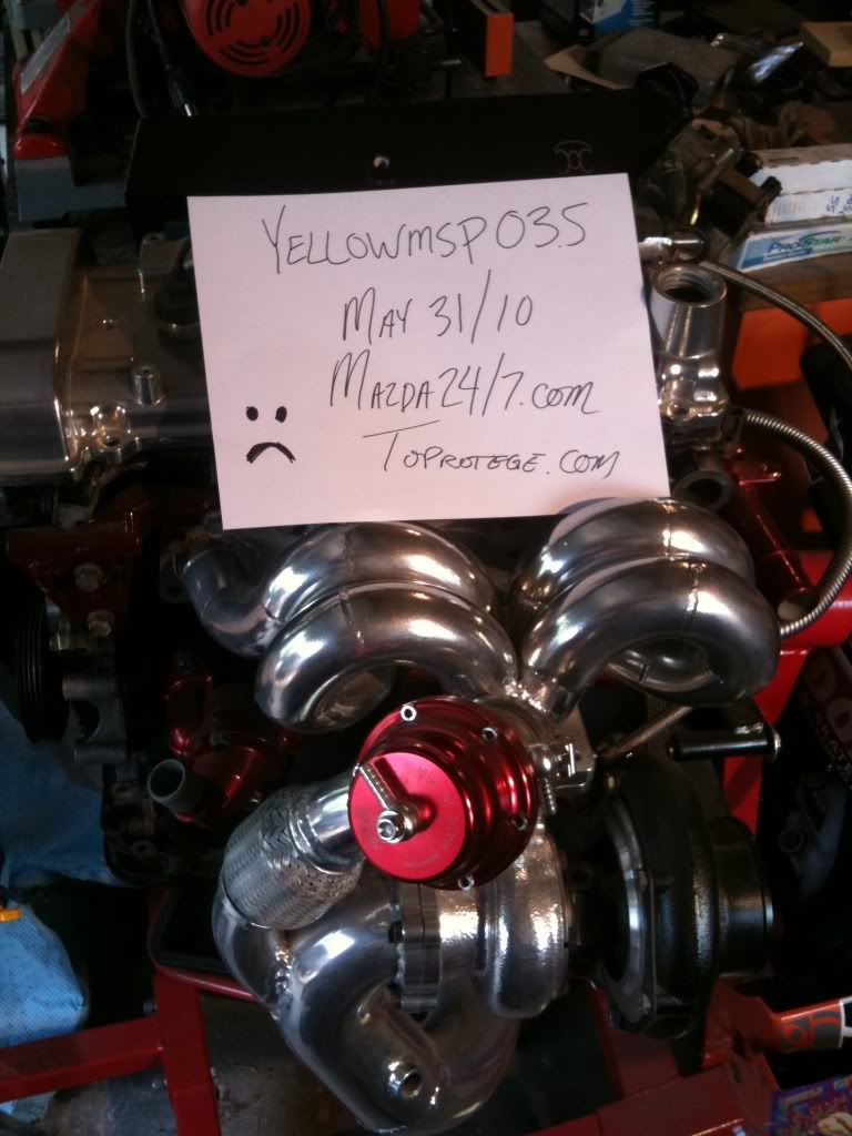

So a member on Mazda247 (Canada) decided to part out his engine build after investing big money and time. He never did get it installed. So I decided to take advantage of this opportunity and purchase the parts to complete my Turbo upgrade.
Anyone interested in Turbo charging their Protege?? I'll be looking to sell my existing turbo set-up. Stock Turbo, exhaust mani, DP, upgraded SMIC.

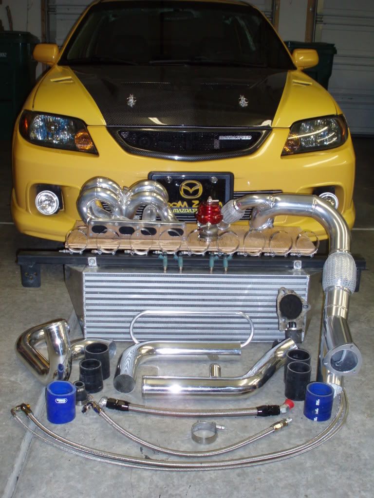

:) :) Parts have finally arrived :) :):
[color=black][font=Verdana]Parts List:
Custom MAM Newest Version SS Sleeper Manifold. This mani has the stock runners from MAM but has had a slightly shortened collector, T3 flange vs a T2, 44mm TiAL EWG V-band flange & pipe added. It was then ceramic coated in Polished (outside) and XMC coating (inside) by Fireball Coatings.
Custom SS 3" Downpipe w/ Flex Section and QTP Electric Cutout - This started as a MAM DP. The 5 bolt T2 Flange was replaced with a 3"ID 4-bolt flange. Custom fabbed a 1.75" dumptube for the wastegate to recirculate back into the exhaust stream to stay emissions friendly. Includes an added flex section for expansion/contraction, an O2 bung, 3" Braided Flex, and QTP Electronic Cutout. This was also coated with the polished ceramic coating outside and XMC inside as the manifold had.
Electronic cutout gate for "Y" pipe in downpipe...
TiAL 44mm External Wastegate - V-band connection, adjustable springs for boost pressure.
TurboLife FMIC Kit – with polished piping, replacement bumper bar, t-bolt clamps and silicone couplers.
Set of direct replacement 440 Injectors.
DEI Cry02 16” X 5” Intercooler Sprayer
All ATP Stainless Steel Turbo Oil and Coolant lines with Fittings.
[/font][/color]
