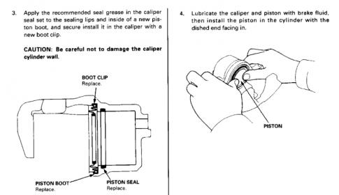

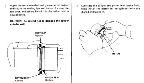

Lies. (But an excellent way to tear a caliper boot!) So much for the honda field service manual, shoulda put it on the piston first, not the caliper.

Successfully rebuilt the brake caliper, used cut aerosol can lid to help expand the boot enough to fit the piston onto it. Bled brakes.
