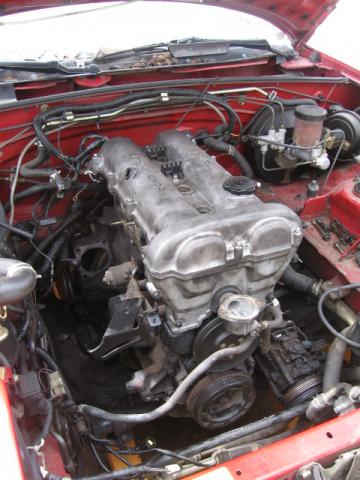

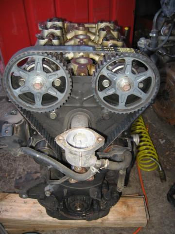

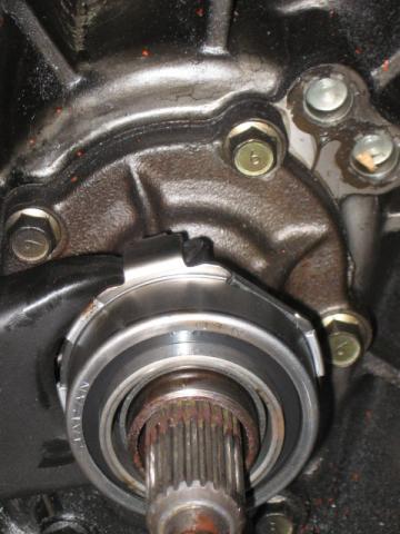

Today was starting to prep the replacement motor. Tore things down to do all new seals. New rear main and oil pan gasket today. Due to previous oil leaks, all parts that are coming off are also getting scrubbed down (oil pan, valve cover, starter, alternator, etc). Still on the agenda is new t-belt, cam seals, water pump, valve cover gasket, plugs, clutch, transmission seals, etc.

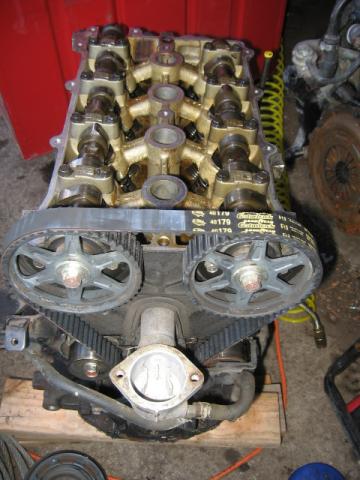

Busy again this afternoon. Added oil/filter, put on flywheel, temporarily mounted starter, did compression test, and put in new plugs. Next is t-belt and button things up to get it into the car.
94mx5
Posts: 257
Joined: Mon Oct 19, 2009 9:14
Postby 94mx5 » Sat Apr 02, 2011 9:14
Got the t-belt, valve cover gasket and clutch all installed today as well. A good afternoon of work!

Postby 94mx5 » Tue Apr 12, 2011 9:14
The clutch wasn't working right after the install. Thought it was the slave cylinder as it would move easily by hand and had no resistance. Replaced slave, and now looks like no pressure from the master cylinder. Both will be replaced and new fluid. Make sure it is all done right and problem free. ;)

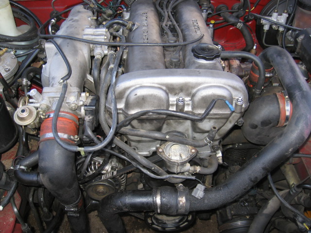

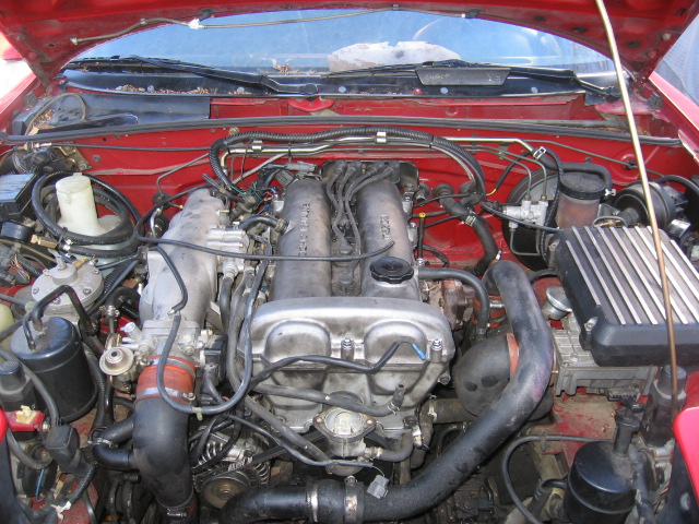

So I put in about 2 hours work last night until it got dark. Got the entire engine put together. Of course the battery was dead as I forgot to plug in the battery charger, but at least it was all done.
Good news is that after a night on the battery charger, car started on the first turn. Likely needs a couple details figured out as the idle was high, but hey, it runs! :) Also have some non-essential things to hook up like the AC and PS pump. Couple more hours before it is road ready.

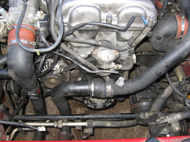

More progress today. I tried filling the car with coolant a week ago and getting it on the road. Before I even had the radiator full, coolant started to pour out of the water pump. The gasket on the back of it had gone bad.
Water pump replaced yesterday with a new pump, gaskets, and seal to the bypass tube. While I had some other parts off, I also replace the front cam seals. Also had to replace a couple fuel lines for the EFI that weren't up to par. Car seems to run great now. Still need to do a once over on everything else, such as brakes and such. Hoping to have it rolled out of the garage area and on the road this week!
